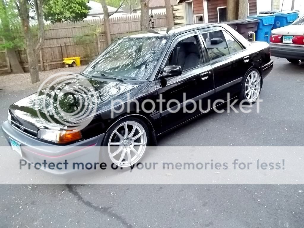

Need more side pics to determine slammed-ness. Doesn't look like you're tucking tire in the rear, but looks pretty good
Hammer/grind off the old spring seat on those struts and you can get another inch of drop.

Well, because I do alot of sidework and constantly have a ~150lb toolbox/ jacks/jackstands in the trunk. I left a minimal wheel gap in back so that when its weighed down it sits pretty level, rather than have the ass dragging look goin on lol
PS the car looks sick in person. I enjoyed seeing it at OCC.
up front I can go down maybe another half inch before hitting the stock spring seat, and out back maybe an inch. As it sits now I cant get my foot under the front mudflaps and they constantly drag on speedbumps lol

Just for clarification for those that are used to 3rd gen Proteges/Mazda 3's, the BG is super body low. So while it looks like he has decent clearance from the photos he has shown, the subframes/oil pan are very close to the ground. On anything less than 16's you can actually have wheel gap, and be <2in from the ground on the bottom.

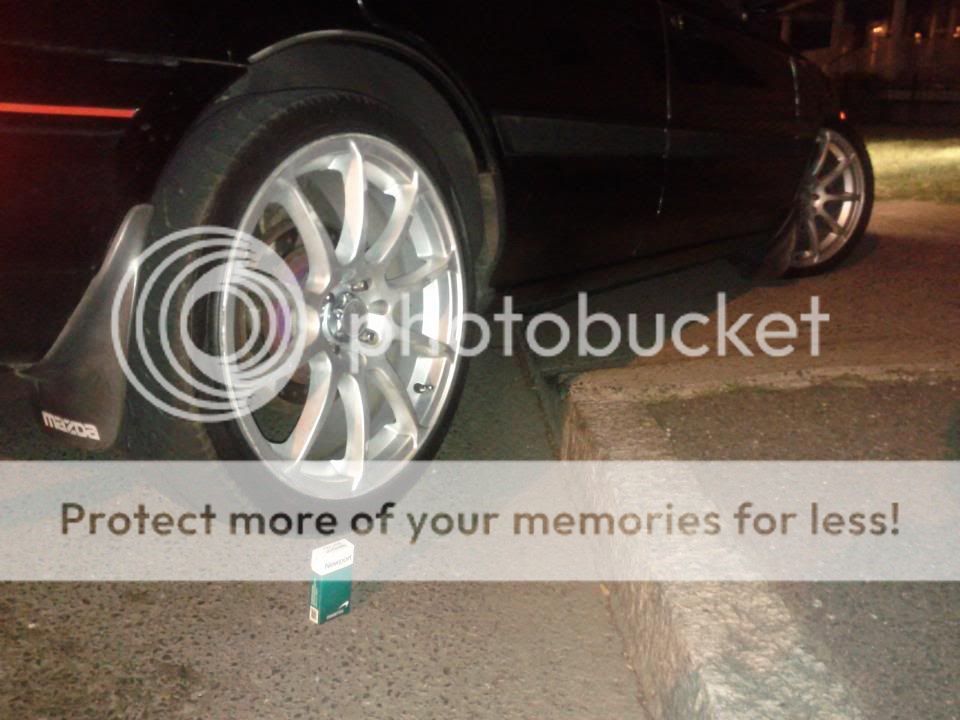

EG can you please do a floor level shot with a pop can next to the side? I think your shots gave it a look of a lot of gap cause of the shadows
Will do, for now heres a pic of my mudflap to small speedbump relationship. Just for reference this is one of those tiny speed bumps that most pple wouldnt even slow down for in a stock suspension vehicle. and on level pavement I cant put my sneaker under the mudflap
