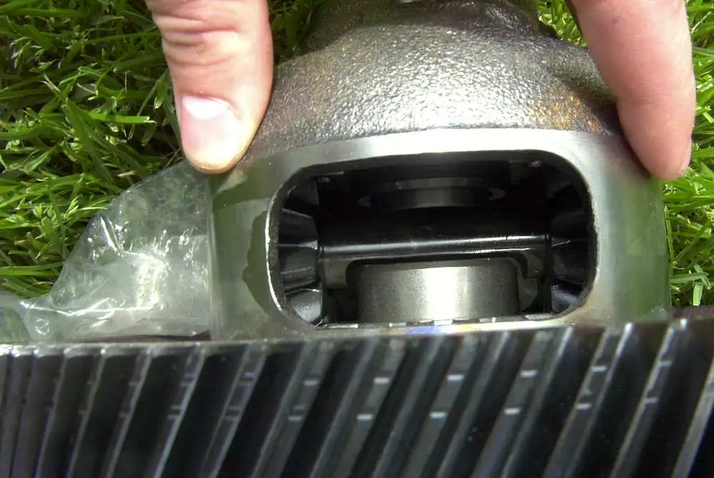

Yeah I posted that, and I was wrong. That is NOT the LSD in our car according to GRM. Ours is a conical ring. Maybe GRM is wrong? I dunno. What, has anyone grenaded their LSD and opened it up? Whats in there, a cone clutch or a bunch of gears?

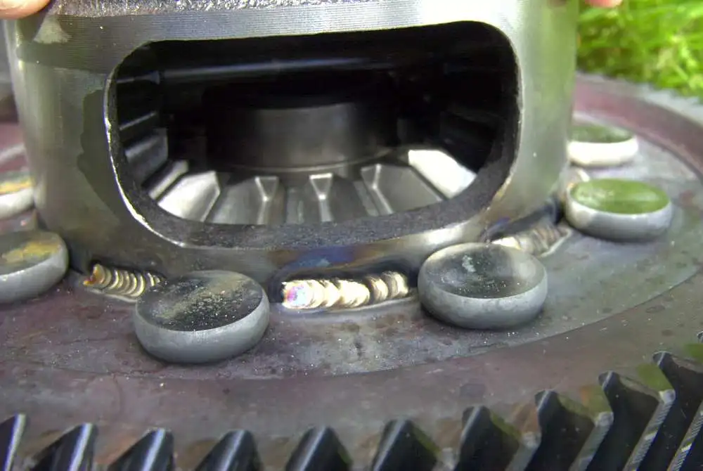

Just installed mine today/yesterday.. there are NO visible springs in there... a number of different gear sets and at least one solid plate.. but no springs... DEFINITELY doesn't look like the one on that awards page at all.
Here are some pics for you of the insides of the MSP LSD...

I think the problem is that when some of us say Torsen, we mean torque sensing like Kleenex is a brand but we refer to all facial tissues by the same name.

Actually Torsen in a sense is a type of lsd. Torsen actually comes from TORque SENsing lsd. The lsd used in the msp is torque sensing, and doesn't require loss of traction before sending power to the other wheel, quite the opposite actually. Howstuffworks.com has a pretty good article on it with schematics and pictures, better off going there than me trying to fumble around and try to explain the thing.

torsen is a heavily misused term from what I've been learning. Torsen is actually a brand, but most people refer to it as a "type" of LSD. In the type sense the MSP is a torsen of sorts I believe... as it is torque sensing, it doesn't require actual slippage from my understanding to generate the torque bias (whereas for example a viscous coupling LSD does). A Quaife is also referred to often as a Torsen differential, it is torque sensing, but it is not a torsen it is actually an ATB (auto torque biasing) differential.
So what I'm getting at is that if I'm correct on the MSP LSD being torque sensing as I belive it is, then they could call it a torsen TYPE differential it is NOT a Torsen (R) differential.
