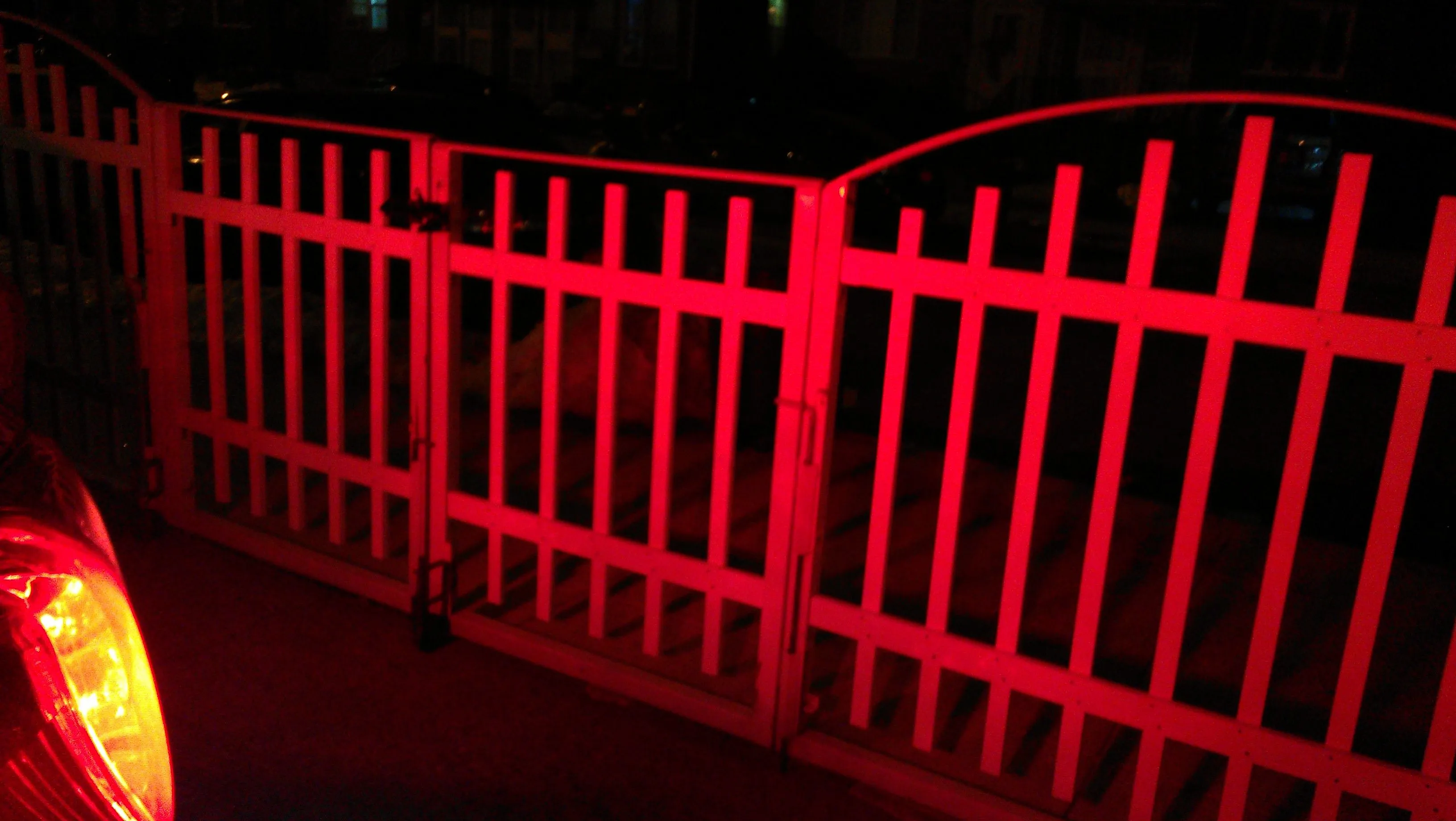

Cellphone camera pic speaks for itself.

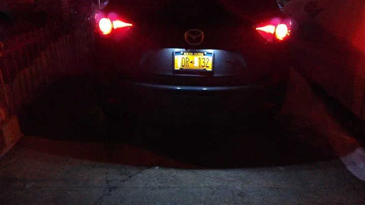

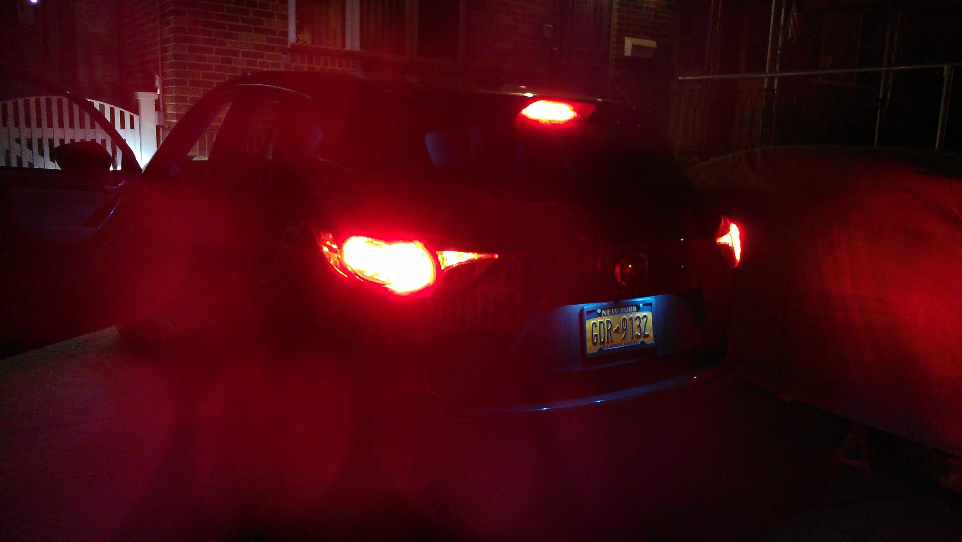

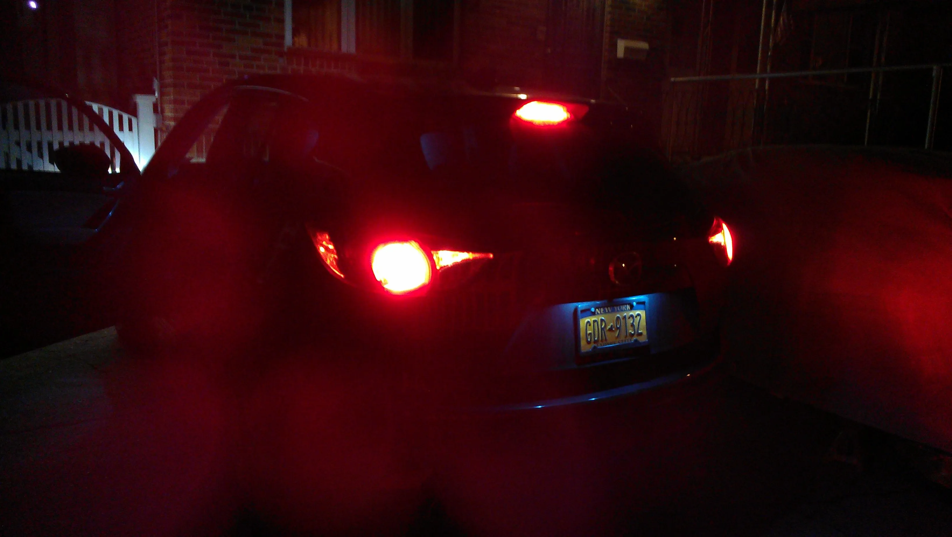

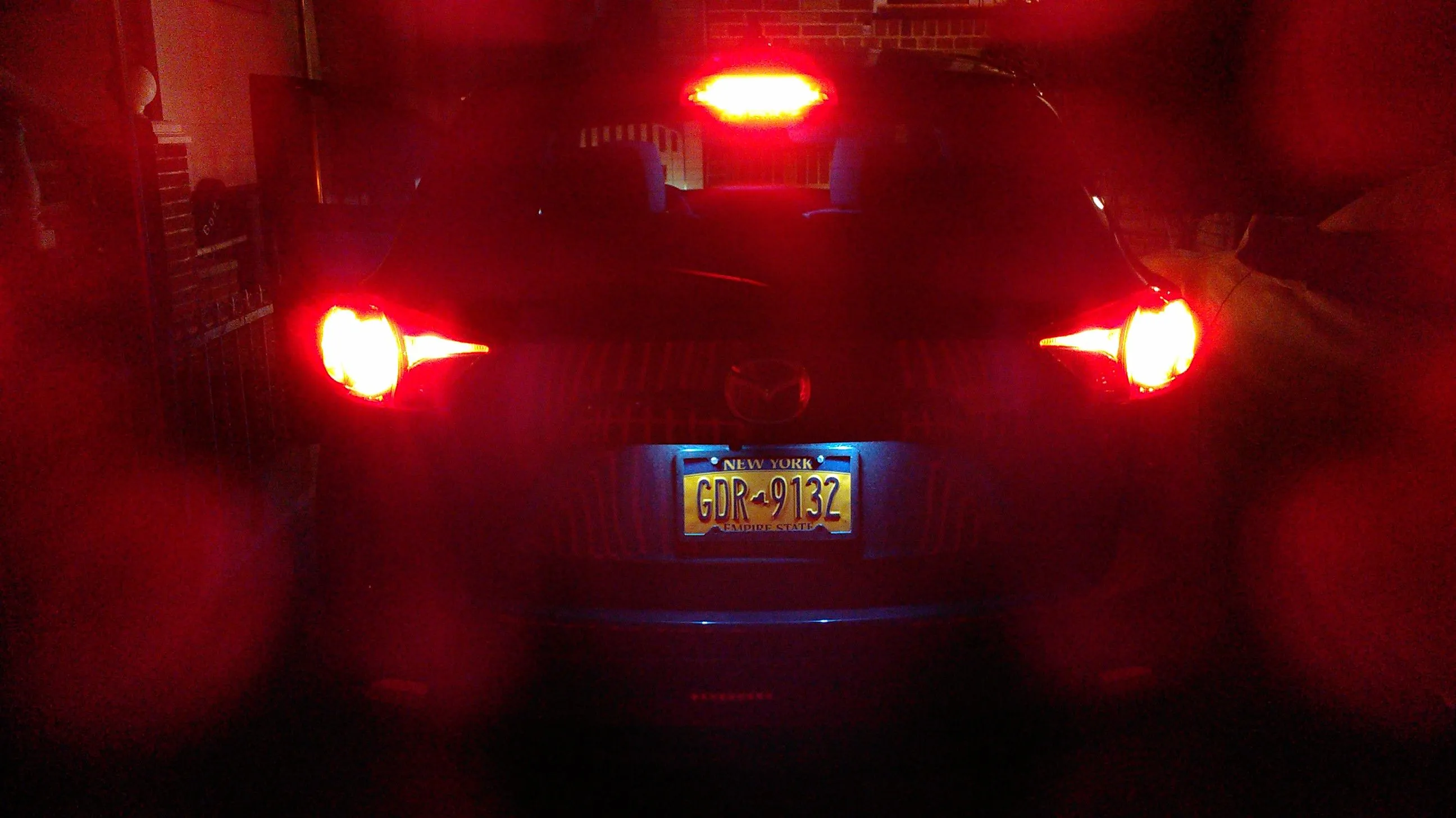

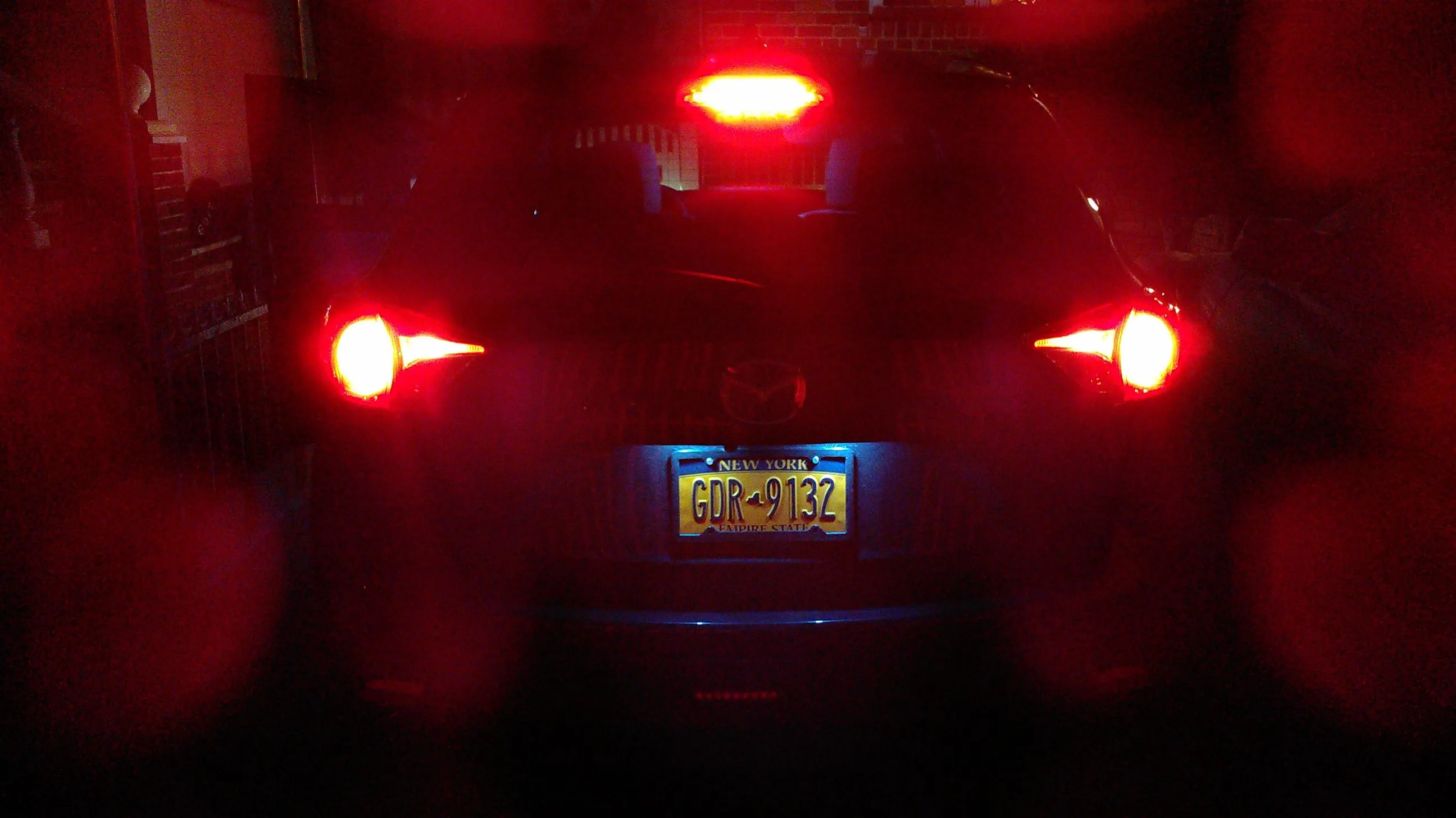

Attached a bunch of raw pics for what little they're worth. Taken with my cell at almost high mount brake light height. Used a the lowest ISO camera setting, but didn't help with the glare. Forgot pics without brakes.

Looks decent enough. I didn't see but did you post a picture of the bulb itself? I'm curious how it is laid out. That's the other brilliance to the Tritons is the virtual filament which utilizes all of the available reflector. But you already knew that ;-)
I'll get a picture of the LED bulb and it in the housing as well. I really wish there is a way to disassemble the LED unit to see the circuitry inside and modify the LED circuit itself. I had to work with the CX-5 bulb connector for the bulb to function properly.
