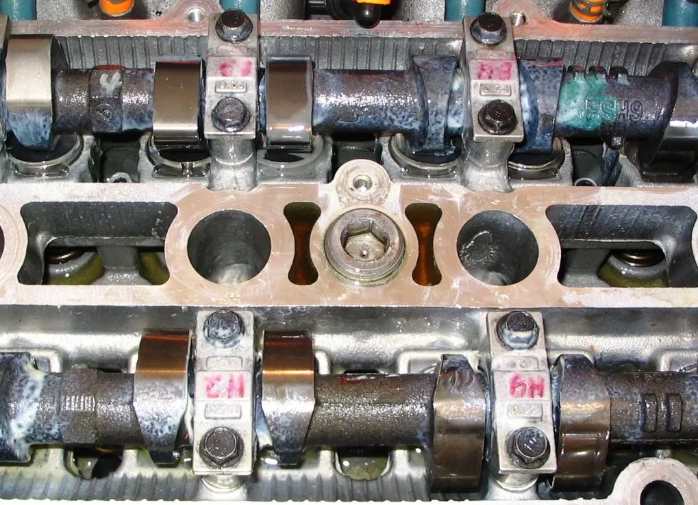

ok so I take the valve cover off, the cams are turning and I notice something that I never seen before any maybe its normal I dunno
this big nut has oil squirting up around it ? is that normal?

You have 0 compression while it's turning over?! I can only think of three scenarios why that can happen:
1) You don't have the compression tool installed correctly
2) You have major valve issues (like stuck open)
3) You forgot to install the pistons in each cylinder :)
yeah thats what I am thinking, something is really odd
1) I know its installed right its pretty simple :) I tried it on my other car just to make sure it was working and its working fine
2) hmm would the fact that oil is leaking around that nut have anything to do with it? I noticed also that it made an air gasping sound as well
3) lmao no they are there
I'm curious about the grinding noise, is it a constant grind, intermittent? Can you tell if it's coming from the low or high block?
