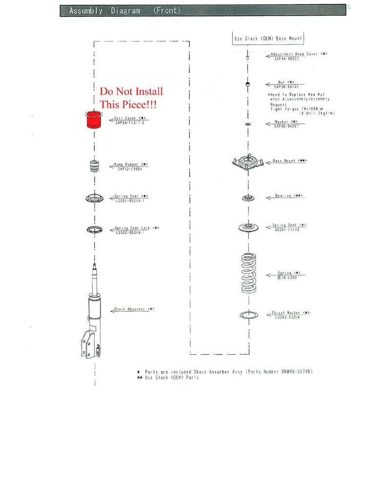

ok, so if i remove this dust boot, i will have no more clicking sounds at all correct? and this vertical rod thing got me kinda confused, what is it used for and how often does it need replacement? im seriously considering these...i WAS gonna get hp's and tein stechs..but this is like all the suspension ill ever need.. i'll be saving in the long run...convince me!!
dust boot is the little plastic round thing you see on 2 of the coilovers (only on the front)
That is the main clicking in mine although brian mentioned another thing that will click if you dont replace it every time you take it apart and I think I might need to do something with that also.
I would definitely reccomend these.
And if it is any consolation with removing the dust boot, JICs dont even come with them. If you use them they will increase the longevity of the coilover and TEIN could possibly void the one year warranty on them if they break due to wear caused by the dust jackets being removed, but no one else even has a 1 year warranty to begin with and I dont think 1 year worth of wear could damage these even without the dust thingies.
I am thinking of trying ot come up with a better dust covet for them since it makes sense to use one......btw, these black ones that come with em are crap anyways, they are like a 2.5" tube going around the shock which is like 1.5" or something. so there is a solid .5" of gap between the dust jacket and the shock anyways for dust to get in...

YP5TO had said that there was a rubber one available from Tein. Becasue they are together now, I'm leaving them without the boot, but I'm sure that if someone has them just sitting in the house waiting to go on, something could be designed like a rubber cover???
BTW: If the boot was installed on your car, you can take it off with a sharp knife and some perseverance...
******* Update!!!
(glare)
Tein has an updated part for that plastic dust boot on the front shocks. It looks similar to the one on the rear shocks. The part number is SAP24-A8778 they are $12 each retail. I'd rather spend a little time and money to do it right. Also from speaking to the R&D manager at TeinUSA, you can trim you bumbstops to a minimum of 12mm.
Great info. I have left the bumpstop as it was for my install and have replaced the dust boot with a large round flat washer made out of a poly-u rubber.
Anyone know where you can purchase the updated rubber dust boot? Mine have the plastic boot and I would like to purchase the rubber ones.
