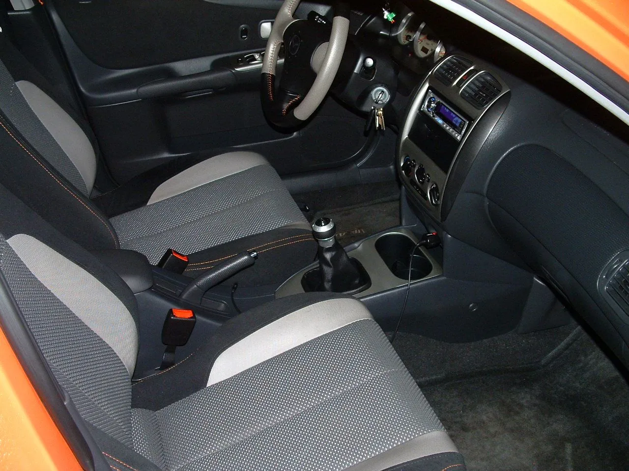

Here's mine:
Sorry to revive a 3-month old thread, but I just installed the pearl magnum last week. I love it, and it actually shortens the height of the shifter from stock...it almost looks like a short shifter now.

To cure the gap is an easy fix. You need to take the center console out. Than just unscrew the four screws that secure the base of the shifter boot. Then, pull it up word so it's turned inside out (with the knob on). Once you have it pulled up snug to the shift knob, wrap a heavy duty Zip Tie around the stick and pull it tight as possible. Then trim the excess length of Zip Tie. You can put another one on for kicks if you'd like below the first. Then pull the boot back down and make sure it's nice and snug and looks good. Once your happy just screw back down the shifter base and reinstall the console and your good to go. Your results should look like below:
Hey thanks a lot man, that's pure genius.. i was worried about getting a new shift knob and having my blue TWM lever showing.. oh I can't wait until my boot from that guy on the forum comes in.
No prob, I hope it works out for everyone. I just try to help out where I can.
