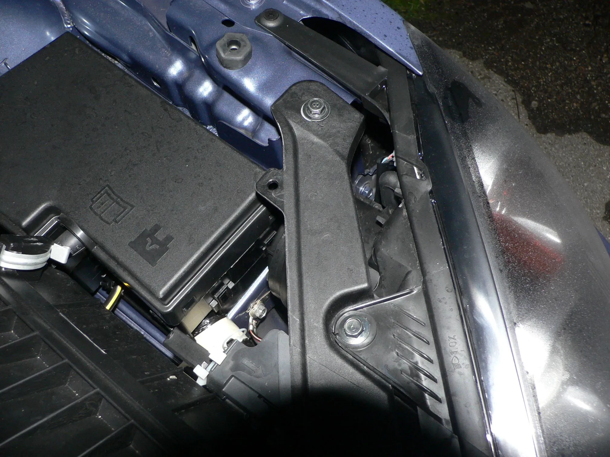

MM3Canuck said:

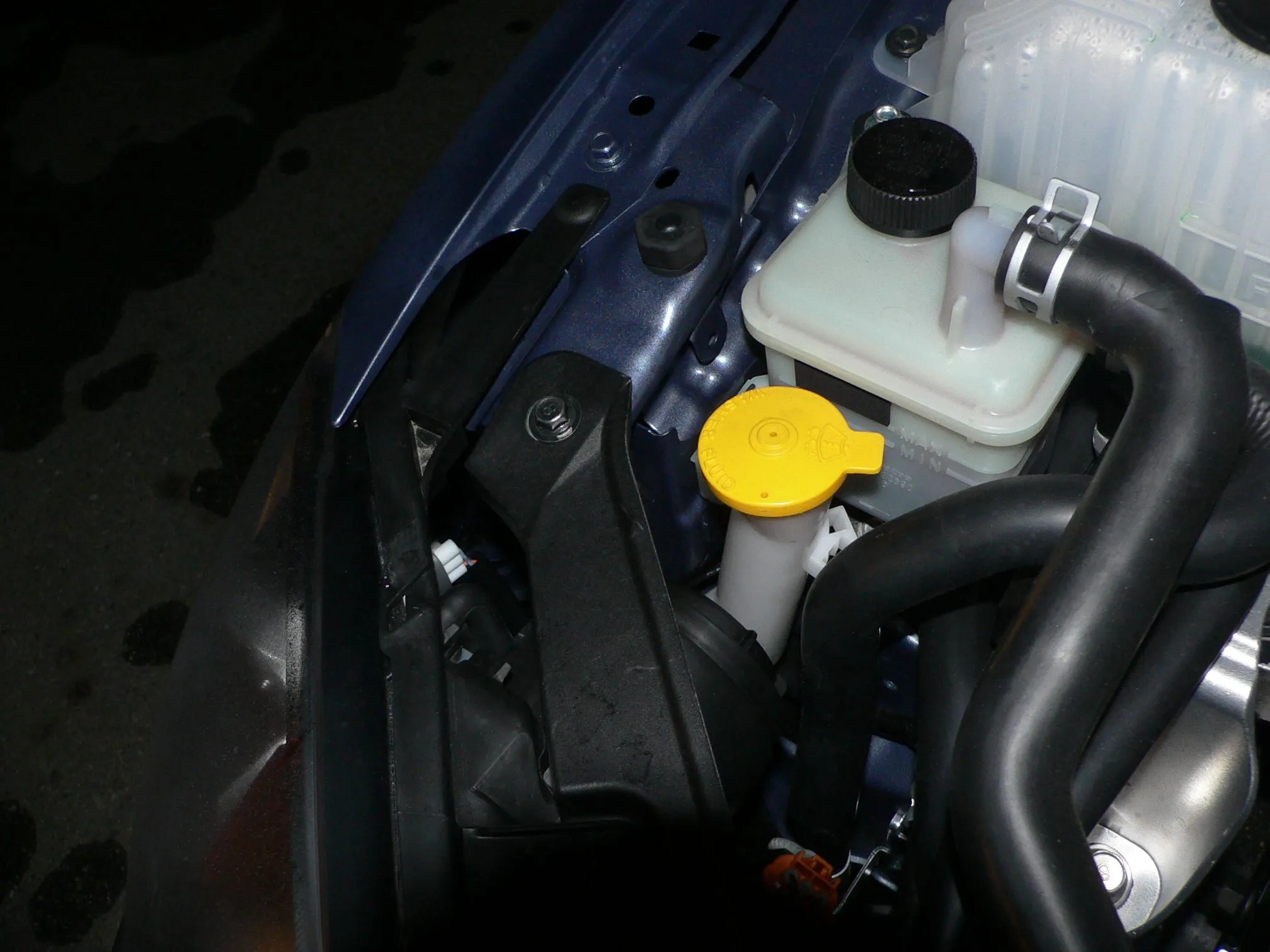

Not the best pic, but you can sorta see the space to get your hand in.
Mine looks pretty similar. I can see the sockets but there is no way I can get my fingers in there to twist the sockets. I'll have find a place to hire a monkey to do it. (monkey2) (monkey)

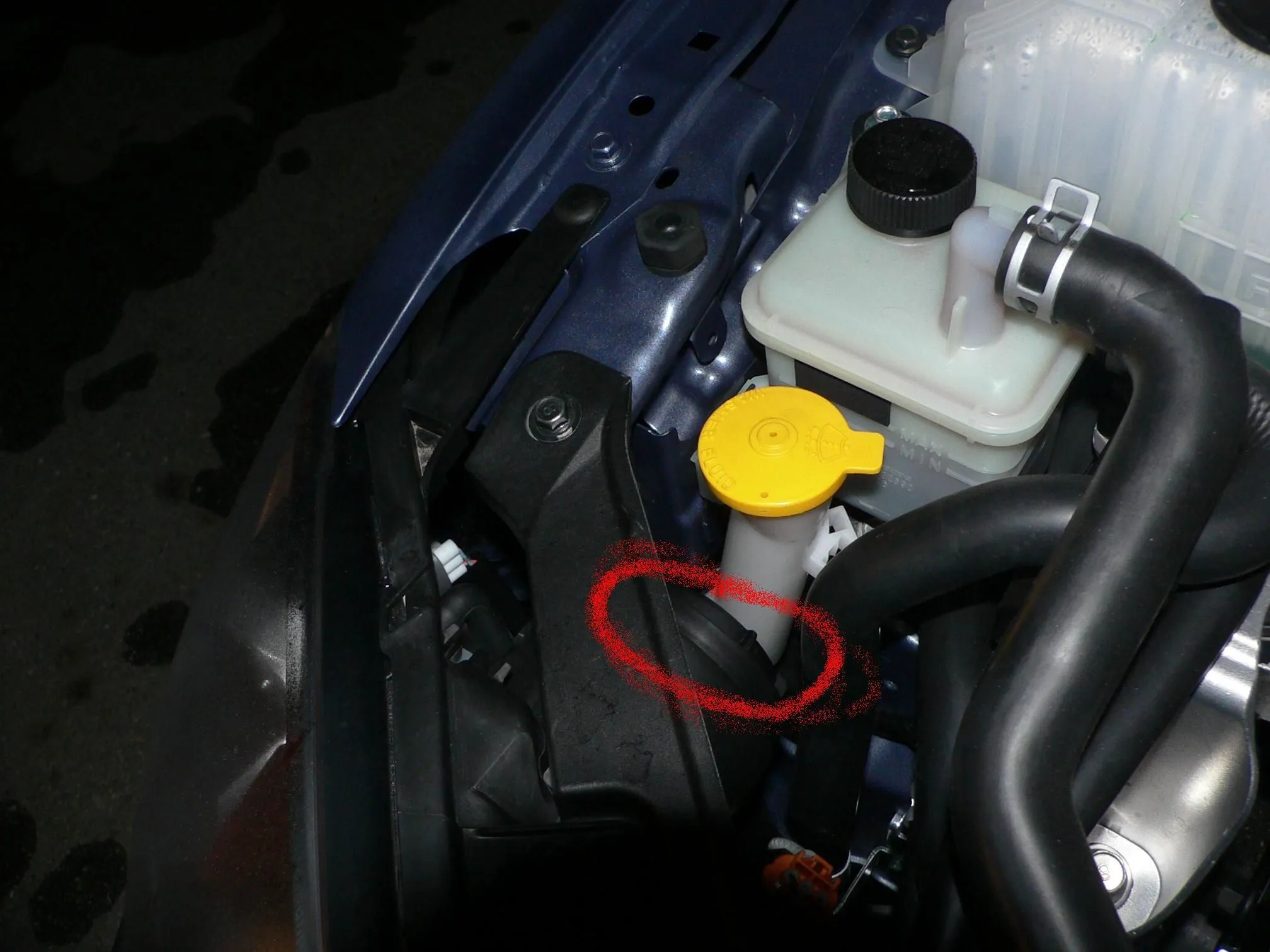

I see whats going on. The circled things must be your HID's?!!
I have aftermarket HID, and they dont have the part that keeps them automatically level. Well, looks like you have to take your case out. But even that shouldnt be too bad. I havent checked how many bolts are holding it, but I think they are all accessible without removing the bumper?
BUT maybe, maybe it is just easier to remove the HID thing that sticks out, then you have access to your turning bulbs.

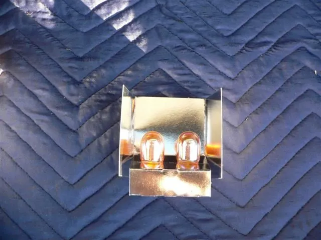

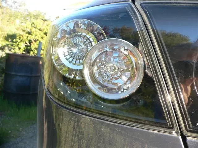

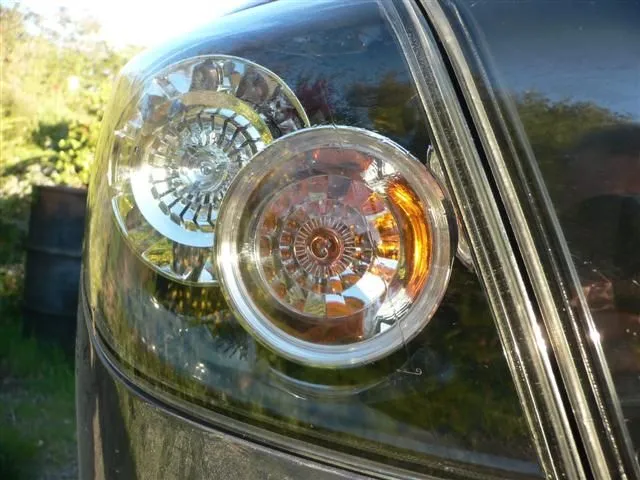

I solved my problem
After much screwing around trying to bodge some lights that weren't designed for the sockets and failing, I found the correct bulbs. They are Philips SilverVision WY21W bulbs, not available in the US. I found this place in England and ordered some.
http://www.powerbulbs.co.uk/default...artPosition=1&strSearchCriteria=any&PT_ID=all
It took four days, free shipping. Not cheap though, even with the free shipping.
Definitely cleans up the look.
