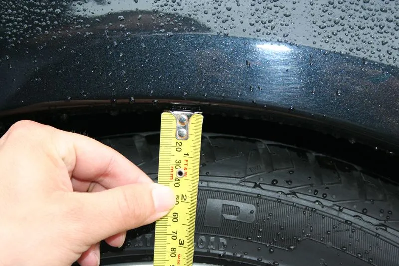

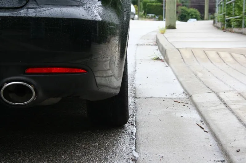

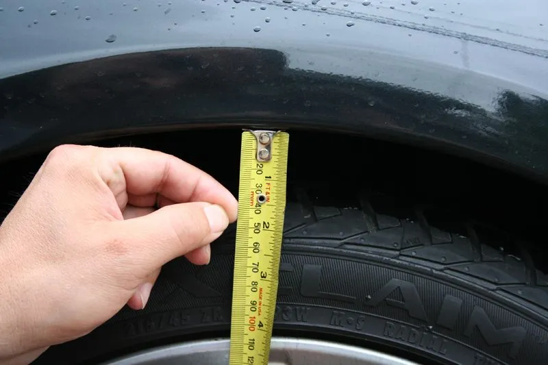

here's pics of the front and rear clearance and of the rear camber. About 1-1/2 iinches from the fender lip to rubber. Any thoughts?
And the tires are 215 45/ZR 18 on stock rims

If you can, slide under the rear and look at your springs, see what brand they are. Overall though, it looks pretty good.
Will try and jam my head under there, so you think the camber looks ok?
Looks like mine with the H&Rs to be honest. I'd prefer something a little less, but wait until you get an actual readout from the alignment.

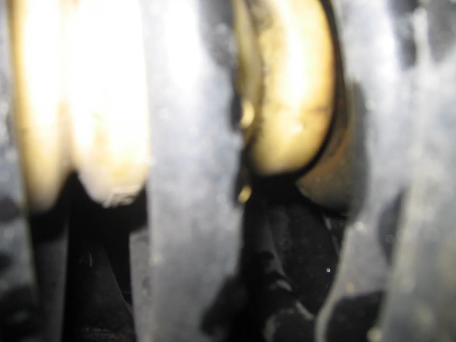

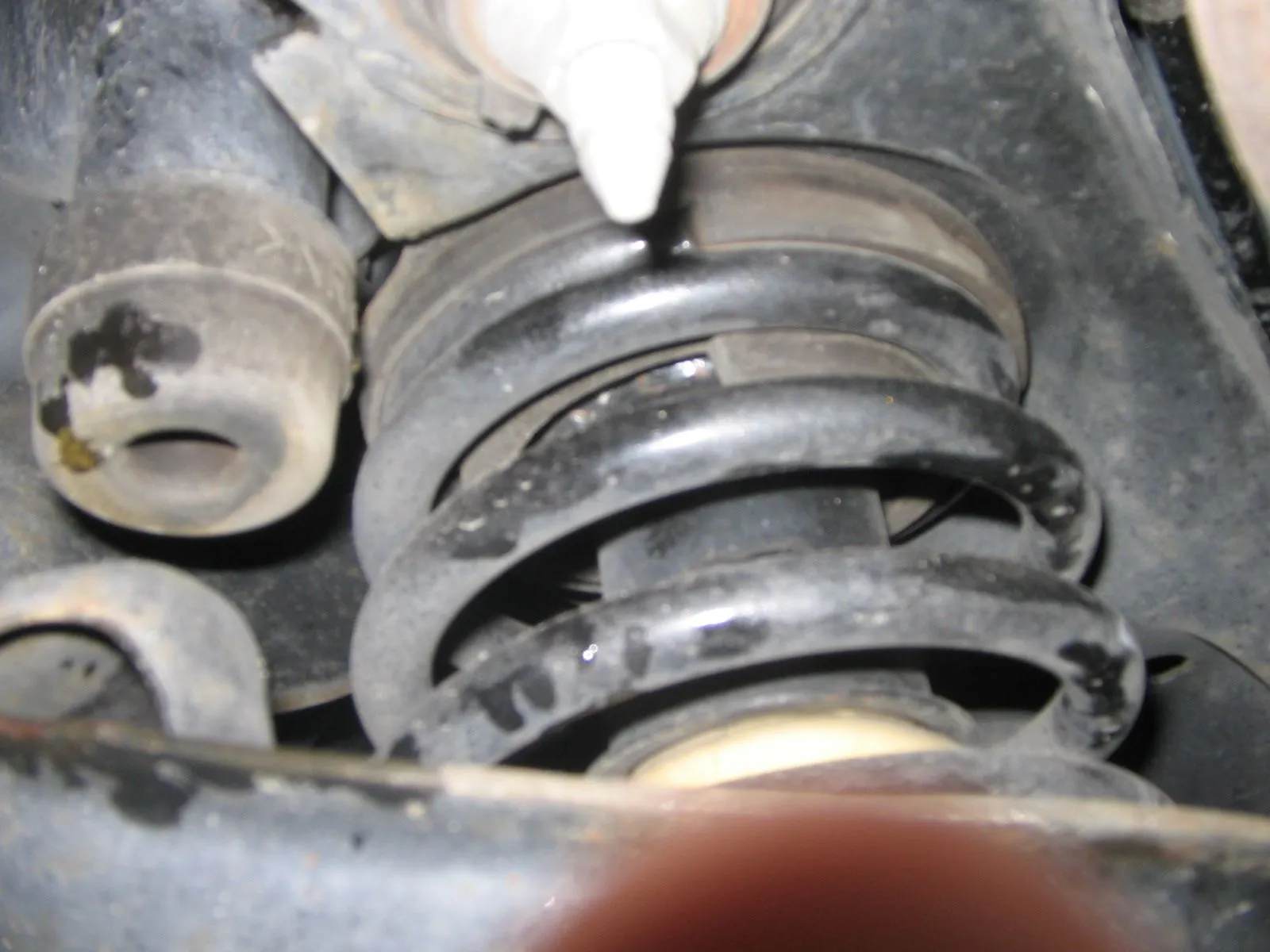

ok, lied in a puddle and stuck my camera up in there, please see attached.
If I have time after work tomorrow I'll take a wheel off and get a better look.

To be honest it looks like mine. I have Eibach Pro-Kit Springs and they are the same color. I can tell where the dust is wiped off that you have little sparkles or w/e and I know the Pro-Kit has that cuz I installed them about 3 months ago.
I just think it looks a little more "slammed" then mine.
*** Edit ***
I just looked at your pics again and looked at mine on my cell phone and it's about the same. If I would guess, they are exactly what I have.
i think you should be fine with the springs just on your car. my car had eibach pro kit springs on it when i bought it, and no one ever said anything about it. also, aren't eibachs marked with a with logo on the springs? mine still has the eibach and something else on it.
