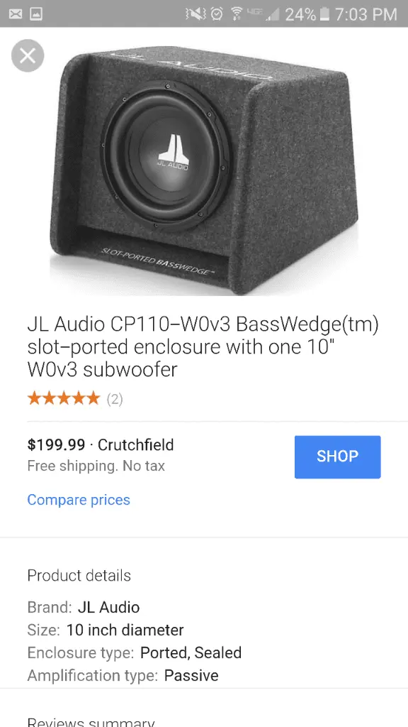

Anyone install a subwoofer in their Cx-5? Can anyone recommend an quality amp? I've found a JL Sub that I really like; I'll attach a photo. Thanks! Screenshot_20170126-190324.webp

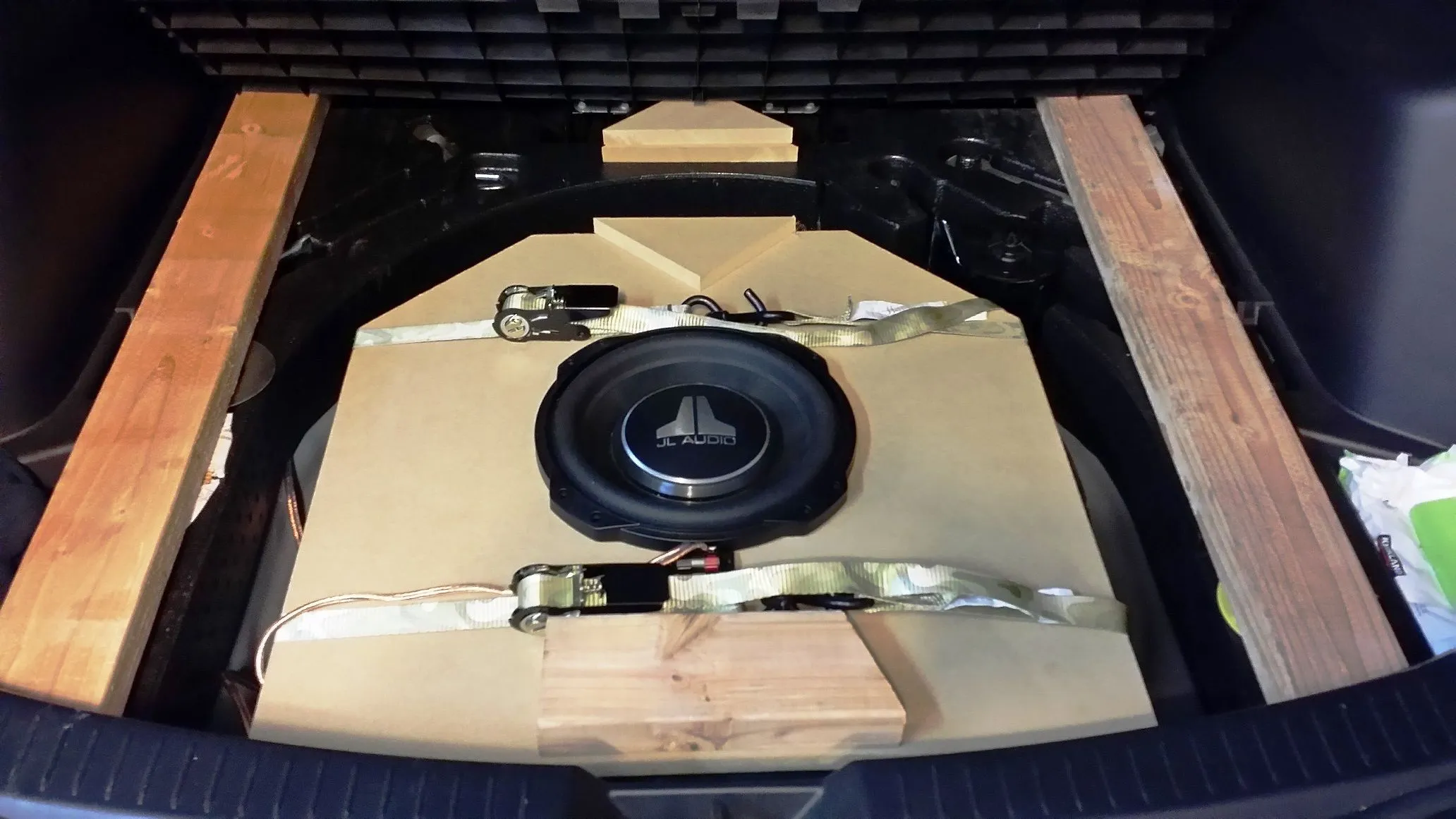

I have a shallow Jl Audio 10", in my spare wheel. Sealed the wheel with a 6" rubber gasket and a 6" aluminm plate over it. Tightened with a bolt(placed a wrench in the Styrofoam). Placed an MDF over the wheel, installed the sub in it and strapped it down with two ratcheting straps. Sounds awesome. I'm using a Polk Audio PA880($40 broken from Ebay, and I have repaired it, for like $7).
It's not nice, but you can see it, under the floor cover.

That's pretty nifty, for some reason I like seeing my sub in the back of my trunk (weird I know) what amp are you currently using to power / how man watts)
