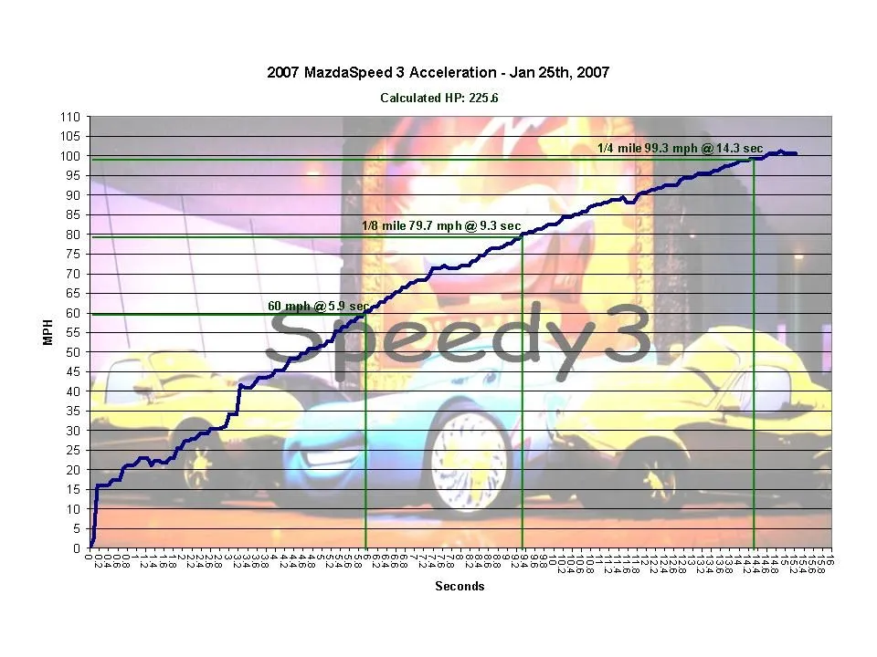

Flat-shifting, acceleration run. Specific environmental paramters:
DSC off
34 deg F
100 ft Alt.
99% humidty
30.21 Barometric Pressure
Cd 0.32, FA 25.5, Tire Dia 25.7, GW 3355
01-25-2007 4:12 am
Dry Road Surface
Tukwila, WA
Flat shifted through 2-3, 3-4
Major tire spin in 1st and second

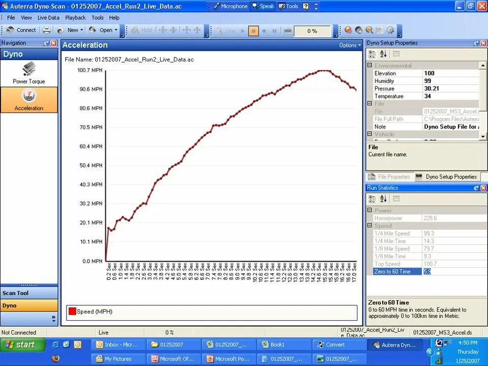

Boost levels from this run coming soon....(takes a while to compile it all nicely)

Bad news. Auterra Dyno-Scan stops Live Data (OBDII) recording while doing a Dyno run. (pissed) I exported the data and the logging stopped right when I clicked start on the acceleration Dyno test. Looks like a feedback email to Customer Support.
I'll try to to a pure Live Data recording without the acceleration Dyno on another 1/4 mile run.
