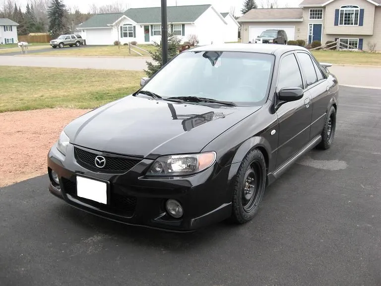

Heres my winter setup. Had to use 5mm spacers up front to clear calipers.
specs: 15" steelies w/ Firestone Winterforce
