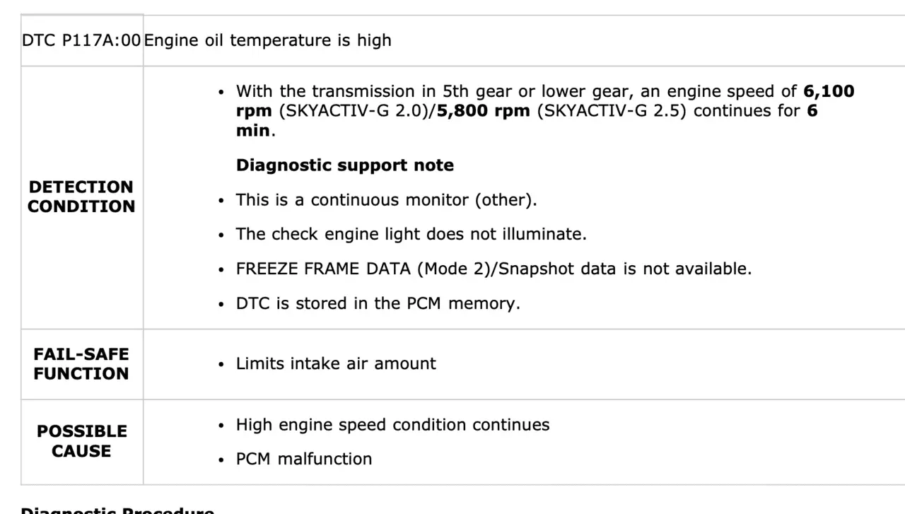

This is from my '15 FSM if you keep over 5,800 RPM for 6+ minutes
