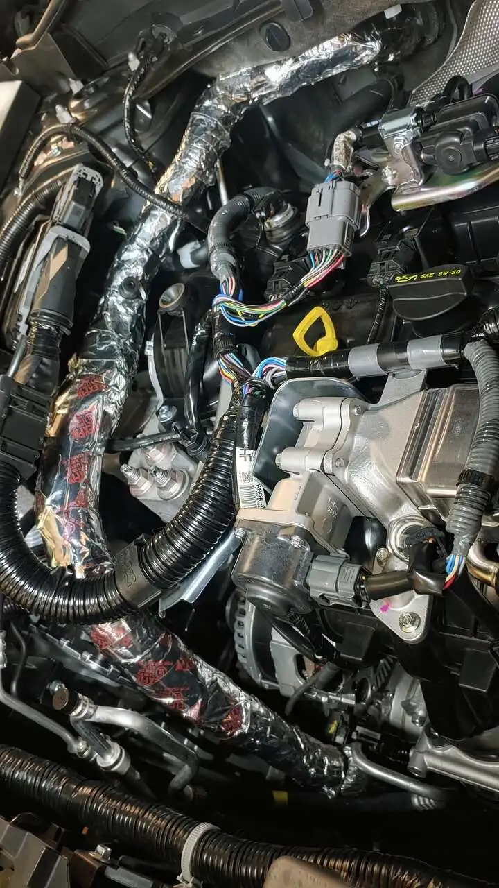

I have a roll of foil tape laying around. So I taped the AC line yesterday. We will be putting the same insulation on a 2021 CX5 later this week. We will see if his wife can tell the difference. She has been complaining about the AC not cooling enough. While we have it, I'll put my gauges on it and check pressure. Also replace the cabin air filter. If she wants ice cold AC we will change out the refrigerant...😃
I have not tested how fast the ac cools the Mazda. Its a garage queen. The black Ram test went like this: 99 f, sunny 2:00, sat in sun all day closed up. Digital thermometer in ac duct read 105f. 2 blocks later 65f, 2 more blocks 55f. Very soon after 45f. I settled in at 42 to 43f. It has Stage 1 with foil tape and Stage 2 refrigerant. Just last year it would have taken 30 min to cool down driving at 65 mph.
Here is the foil wrapped AC line.
