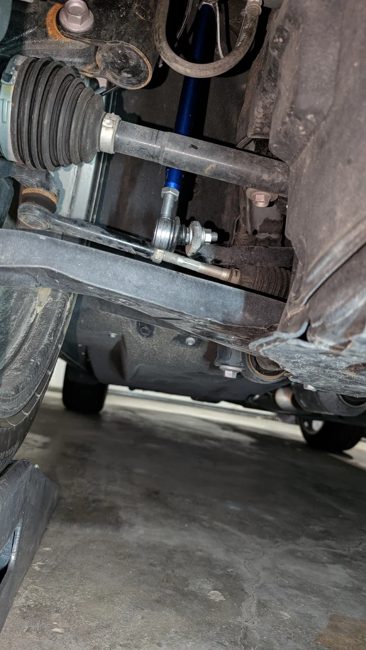

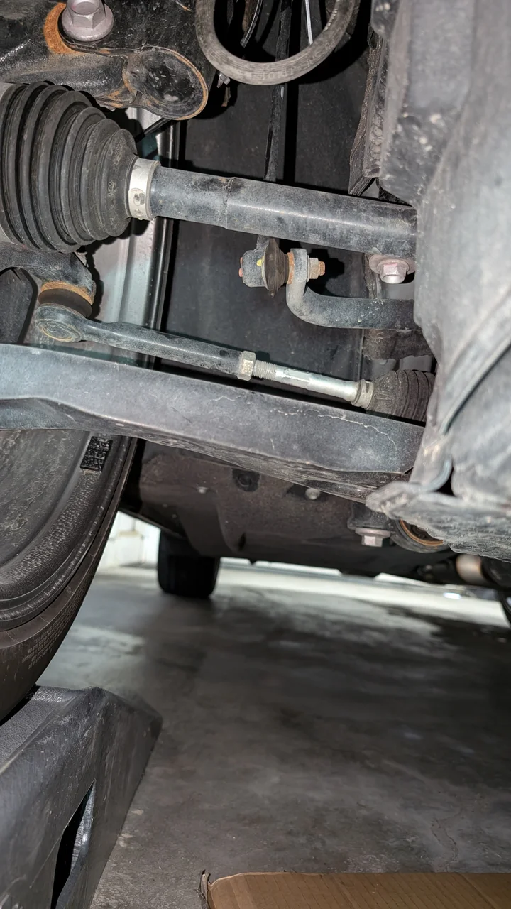

As a visual aid, I have pictures of before and after my adjustable end link install.
Sway bar pulled up:
Sway bar resting:
This is an extreme example, of course, being that the car was lowered 2 inches. If it's off by a small amount, you won't be able to see that anything is wrong.
