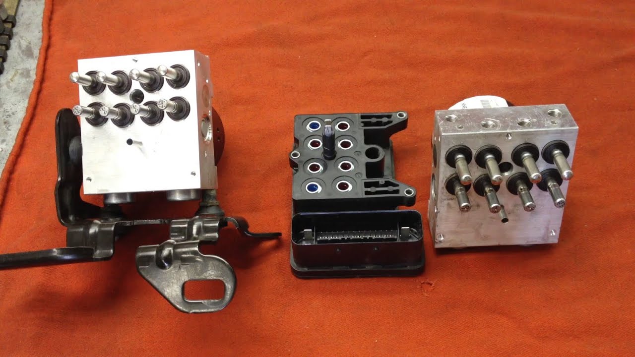

There are a few past threads on this. All resolved with replacement ABS module.
Been a while since I've seen the video and it seems Ford has issued a recall. Why hasn't Mazda?!?!

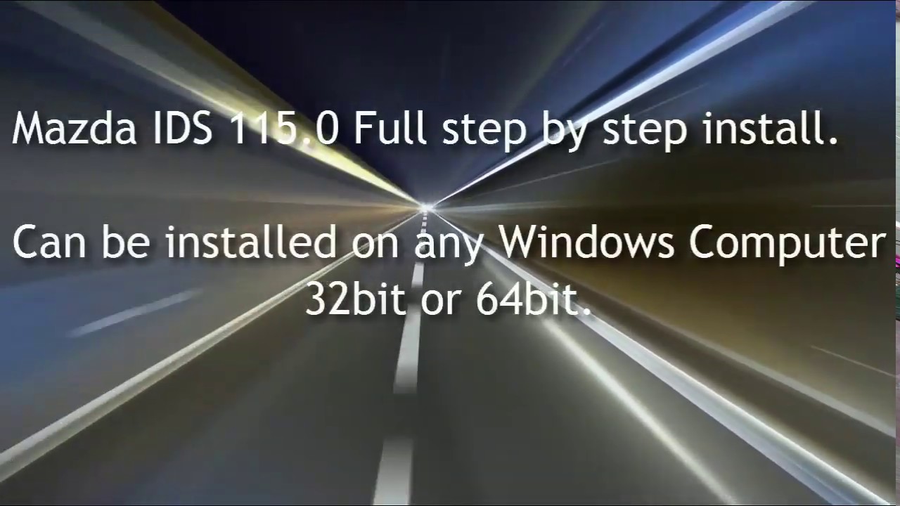

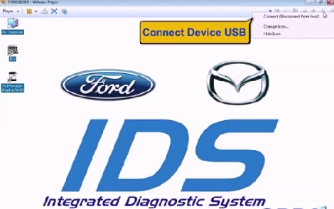

You can investigate more into Mazda IDS but it'll be expensive (*BitTorrent*). This is the software dealer uses so you'll need a laptop and interface hardware. You can also reach out to a YT owner demoing IDS and ask them to confirm if this supports ABS bleeding for Mz5.
Mazda IDS Compatible Hardware:
VXDIAG VCX NANO Ford/Mazda
VCM II
wiScan T6
FVDI J2534
Good luck.

1) Past Mz5 post were ultimately solved with replacement HCU. From my understanding, the HCU is a mechanical device with electric servos, there is no circuit board/chip to program.
2) There unit itself does not need any programming, just plug and play. What you need to do is prime unit if you are buying new. I recall all previous owners pulled a used united from a wrecker, which would have fluid in it. You should cycle the old fluid by triggering an ABS event (empty parking lot on a heavy rainy day).

They got the HCU (ABS Hydraulic Control Unit) from Mazda ($1100) and it fixed it right away.
