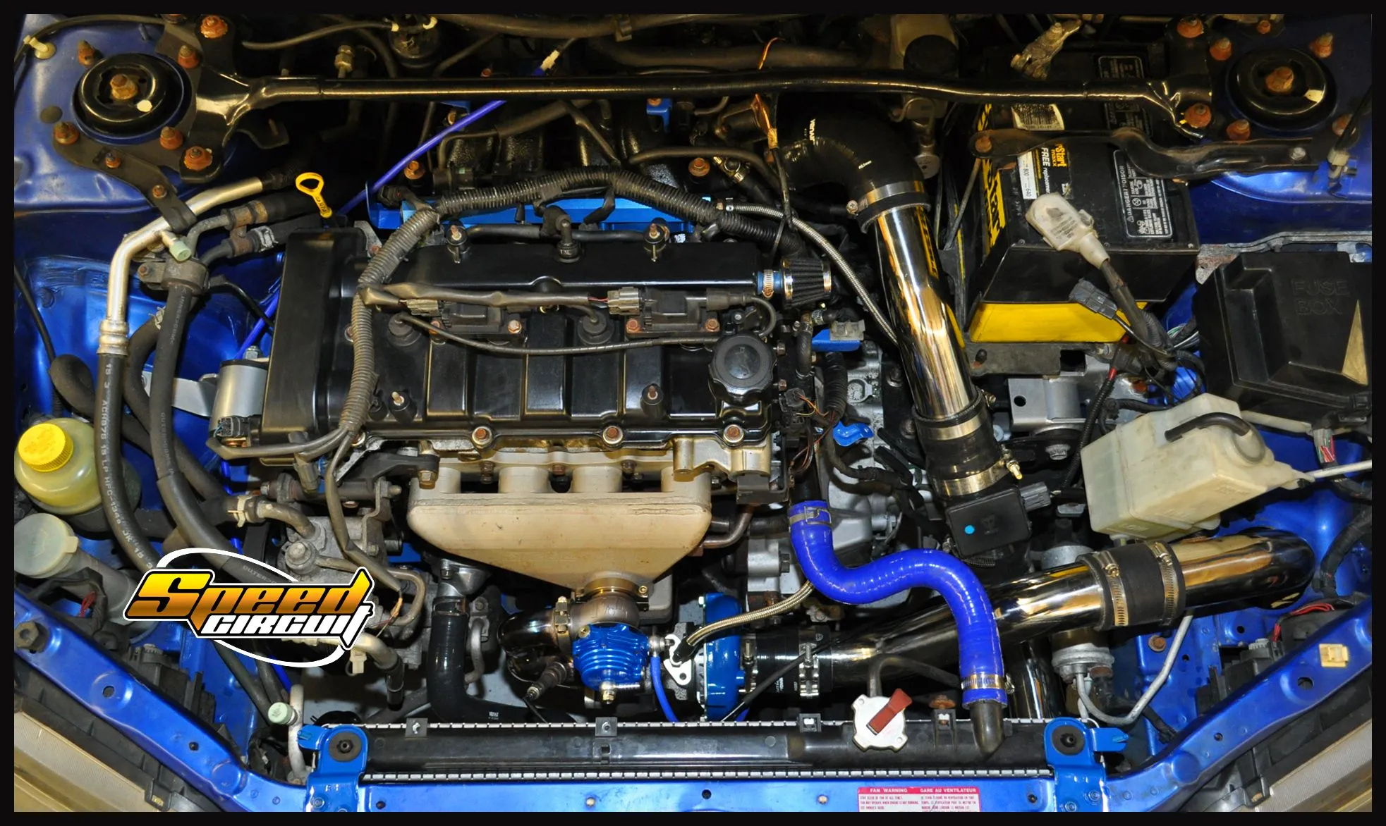

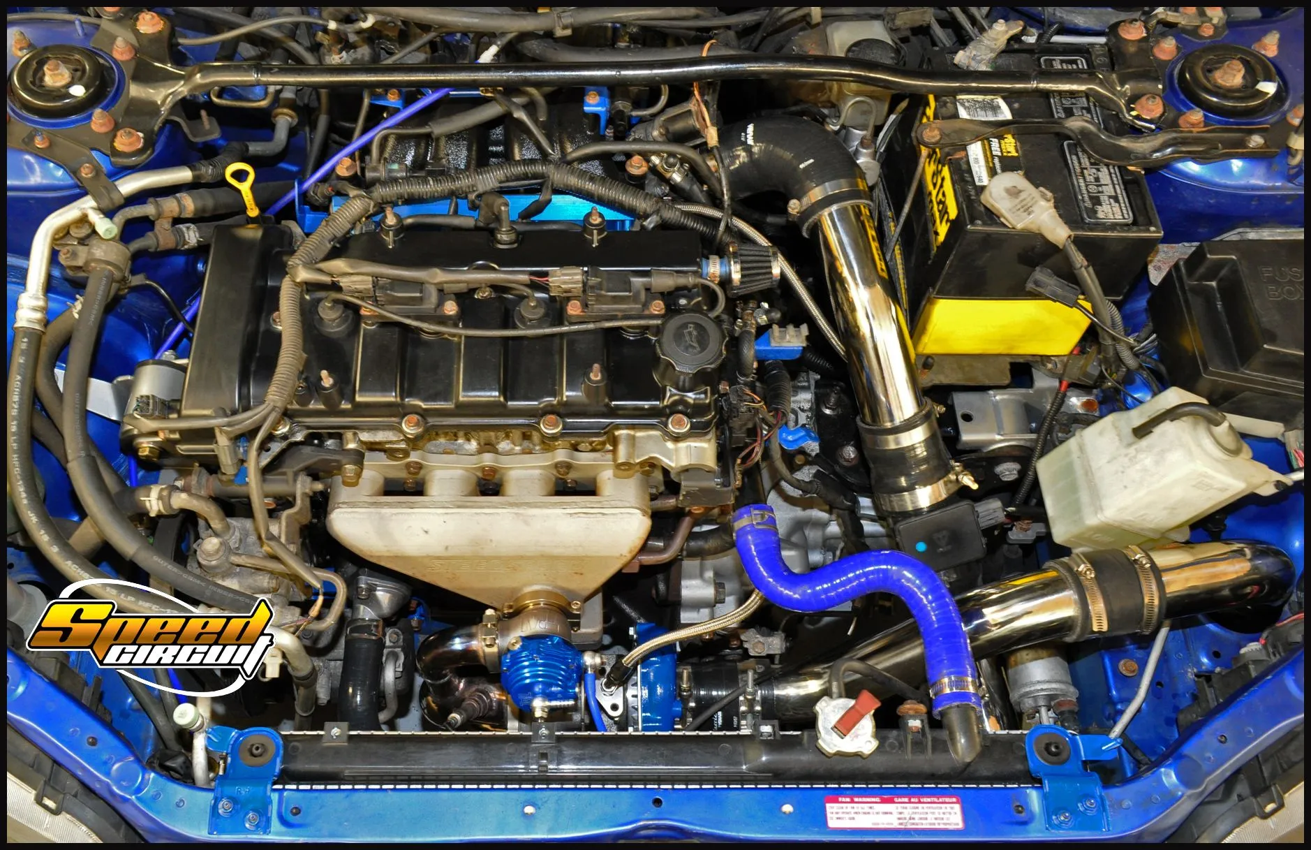

The wait is almost over. The most well produced turbo kit for the 2001+ Mazda Protege is finally ready. Save $500 by pre-ordering the first batch of turbo kits. Regular price for this kit will be $3999, but if you pre order it, it's yours for $3499.
We've invested a LOT of time and money developing this kit. We've built it, rebuilt it, and tweaked it some more. This is the kit to own. Powerful, reliable, and durable. No more chasing down issues, dealing with broken parts, etc. This is the last kit you will ever need to own for your Protege. SpeedCircuit would love to continue to develop products for this car, but in order to do that we need your support.
attachment.php
Kit includes the following:
-Genuine Garrett T3 Turbo, 60 trim with .48 A/R
-Polished Stainless Steel intake and intercooler piping. Includes convertible CAI/SRI and blow through MAF relocation
-AEM Dryflow air filter
-2.5" Stainless Steel downpipe with SS flanges and extra O2 bung for a wideband sensor.
-Purpose built bar & plate Front Mount Intercooler
-Purpose built water outlet and silicon hose
-Stainless Steel oil feed and return lines

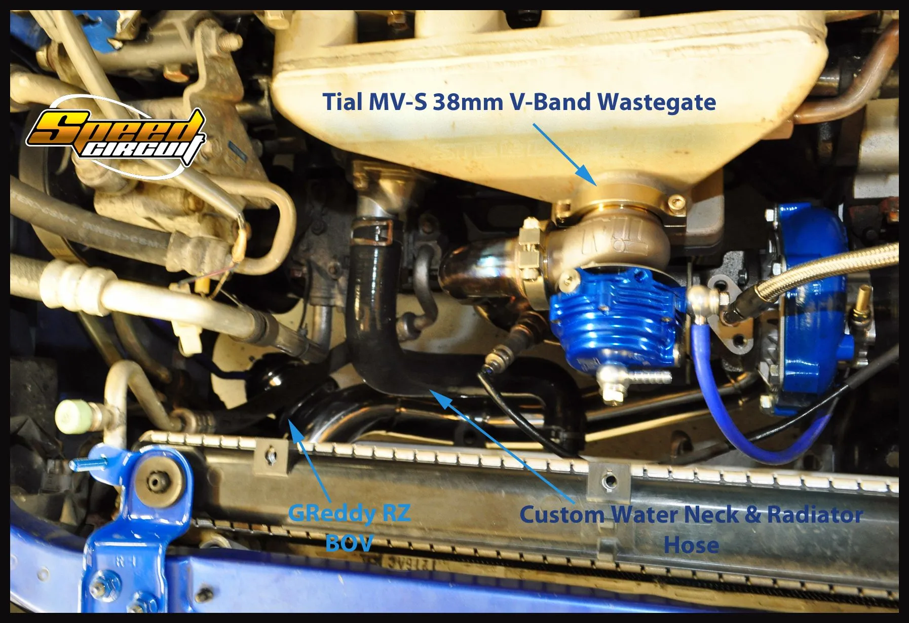

-GReddy RZ Blow Off Valve
-SteedSpeed Turbo manifold with V-Band port for external wastegate. Production manifolds will be ceramic coated in Black.
-ARP Turbo hardware
-Tial MV-S 38MM Wastegate (available in black, blue, or red)
-High quality silicon couplers
-SS T-Bolt Clamps
-Stainless steel hardware
-All necessary bolts, gaskets, etc.
-Optional powder coating on turbo and piping
-Designed to be efficient from 5-20psi. Safe for stock motors, great for built motors!
Recommended upgrades to accommodate this kit:
-Slim radiator fans
-Wideband O2 gauge
-Boost gauge
-Fuel and/or engine management
Orders will come first come, first serve.
NOTE: Car in photo is running a pre-production kit which does not have all of the described upgrades.

Ok here comes my nOOb question. Engine or fuel management? Which is best? also do you recommend to change/ upgrade the fuel pump, injectors and fuel rail?
Are you going to be selling the straight waterneck by itself at all? I know those would sell out pretty quick if you did :)
That all depends on three questions.
1-What's your budget?
2-What are the requirements for inspection/emissions (assuming this is a street legal car)?
3-What are your power goals?
We're going to be offering a the neck and the radiator hose as a kit as soon as we have the rest of the hoses in stock.
