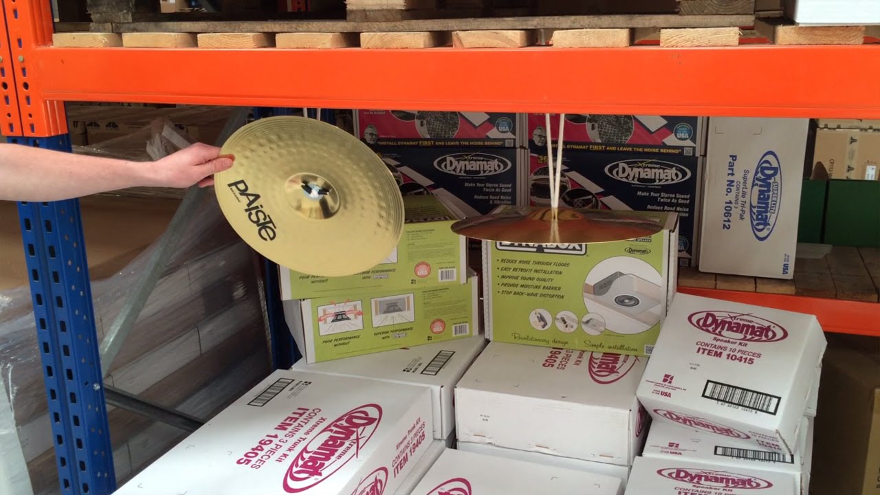

The whole point behind the asphalt based layer is to stop the sheet metal of the car's body from ringing. For that purpose, a little goes a long way. This is a fantastic example of how it really works.
The Cymbal Test
It can be hard to show just how effective Dynamat is at stopping panel vibration. However the old cymbal trick never fails to impress!It doesn't take much Dy...youtu.be
