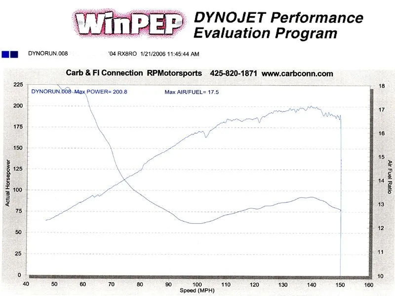

Why not use the latest "Renesis" version of the N/A 13b?
Puts out about 225 at the crank, and 160 torque, no turbos required.
People are crashing RX-8s regularly, and no-one has worn one out yet, so they are relatively plentiful.
doc
I don't know. 54 fwhp might be hard to get without going to forced induction, but it still might be easier and cheaper then to put in a Renesis. I suspect there would be subframe and mount modifications needed, as well matching the engine to transmission. Seems like someone would have already done it or at least tried it. Maybe they can weigh in?
