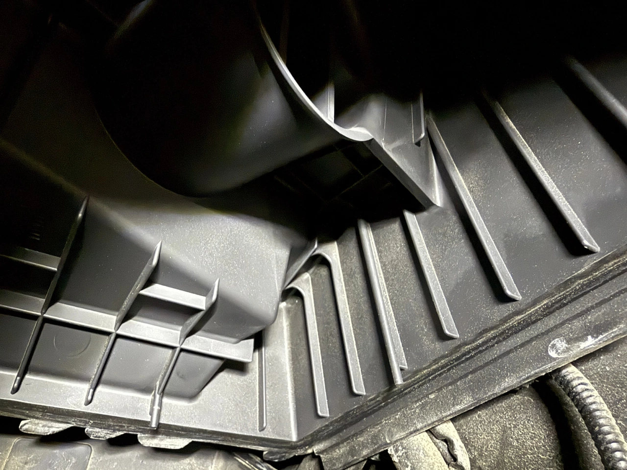

This isn't actually our vehicle; we are just caring for it for a few months (might tell that story separately). It seems that whoever last changed the air filter hadn't properly seated everything on the side closest to the engine:
I also noticed a layer of fine dust on the inside of the clean side of the housing:
Happened to have an extra Mazda air filter waiting, so I swapped it in and made sure it was straight. No more hiss.
