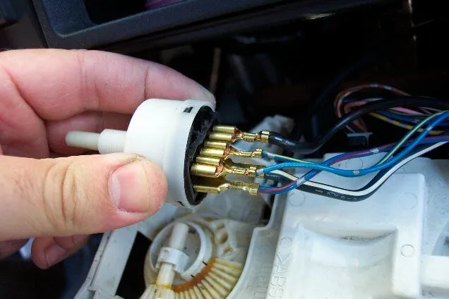

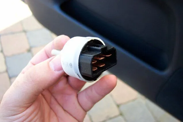

1) the switch

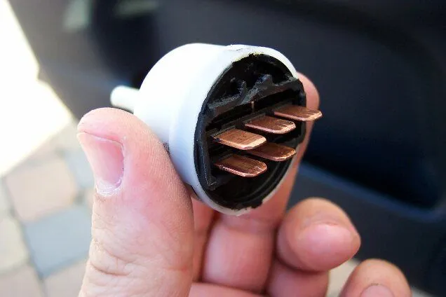

2) I cut the black housing to expose the male contacts

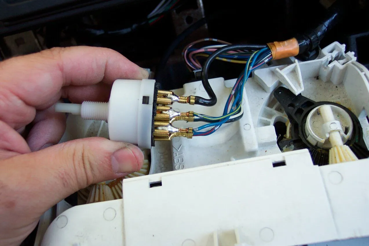

3) Plug-in the wires
4) Solder the wires. Make sure you heat the contacts properly (ESPECIALLY the male) or the solder won't stick properly! Use flux, it helps. This is very important.

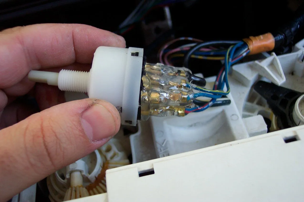

5) Hot-glue the S**t out of the entire contacts. Let cool, then glue again. Make sure there aren't any contacts exposed.

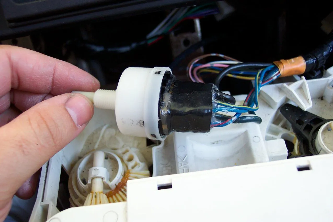

6) shown below...wrap in electrical tape for good measure

OK... so Y0sky and I took my A/C controls out. I took the fan selector switch apart in the back and dremmeled it down so I could get to the 5 connector blades. Then we popped out all 5 wires from the plug side. We then plugged them in, crimped them down, soldered them, and put it all back together.
