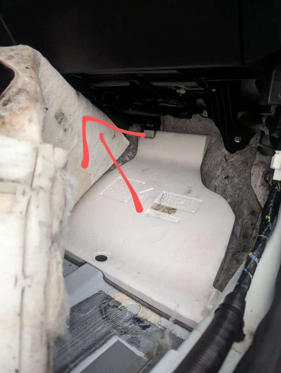

I own a 2022 CX-5. The floorboard/carpet underneath the front passenger seat is completely saturated with water and soaked.
I noticed a little spot of white mildew/mold when I grabbed something out of my car (gross). So I went to clean it and I noticed the carpet was REALLY moist. Particularly right under the front passenger seat. So I looked further and found that right underneath some vent opening the carpet was soaking wet. I put so many paper towels down through that opening in the carpet and it just kept sucking up water. I keep pressing on the carpet and water still bubbles out; it’s so moist still. So I soaked up as much as I could, left all the windows open in my car, and left a towel down in there overnight… but what do you think my next step should be? I can’t imagine having that much water underneath my car flooring is good, haha.
Anyone else have this problem? If so, what fixed it? My car is still under warranty from the dealer I bought it at (in Portland, OR area) so I am hoping this is covered. Any tips or clues? Thanks for the help.

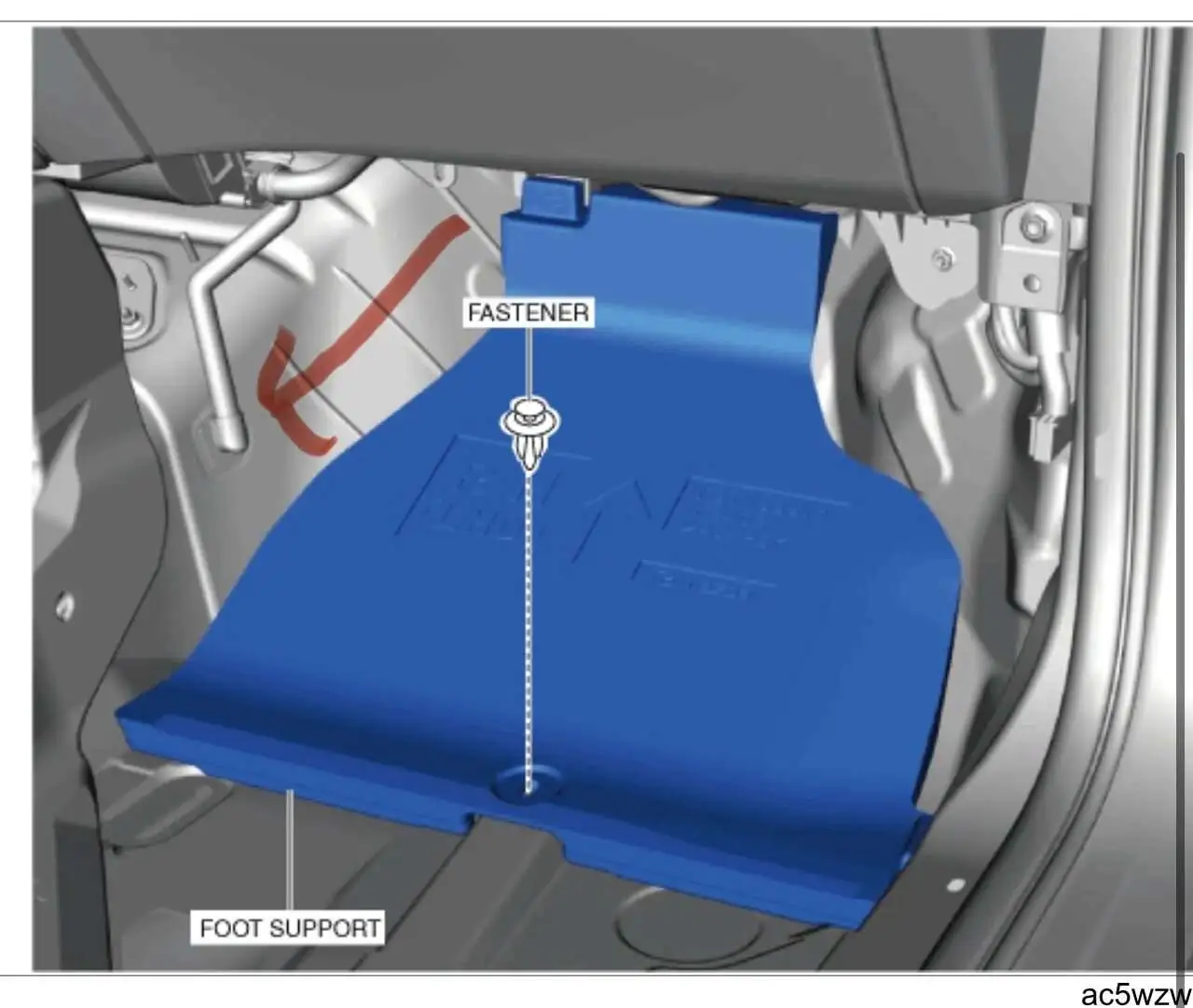

Do you know where the drain is located or have a photo/video I can't find one for this generation? I have the same problem right now and I have the wife's carpet pulled up and letting it dry.
behind the plastic panel(s) on the bottom left side - passenger feet.

Thank you! Just to be clear right here?
