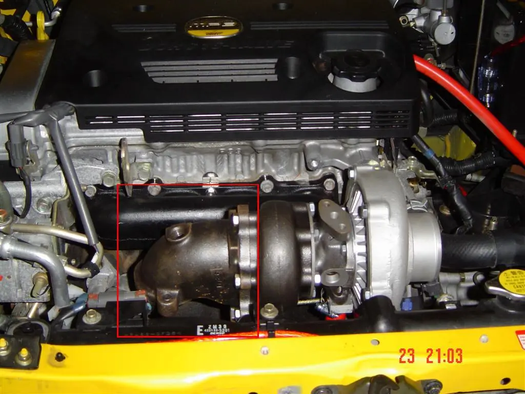

Why not a log type mani and have the turbo up high, then use a spal fan in place of the main fan and keep the A/C fan? That's how mine is and it fits nice with the T3/T4. I'll show you on Saturday when we meet. I have a Merkur DP housing thing bolted to the turbo that has a nice radius on it and a spot fo rthe first O2. It's rust's like s*** because it's cast, but works fine.
The Sleeper kit uses a Log manifold with the turbo up high.
So just include a fan so the turbo will clear. Then you just redo the DP and you should be good.
