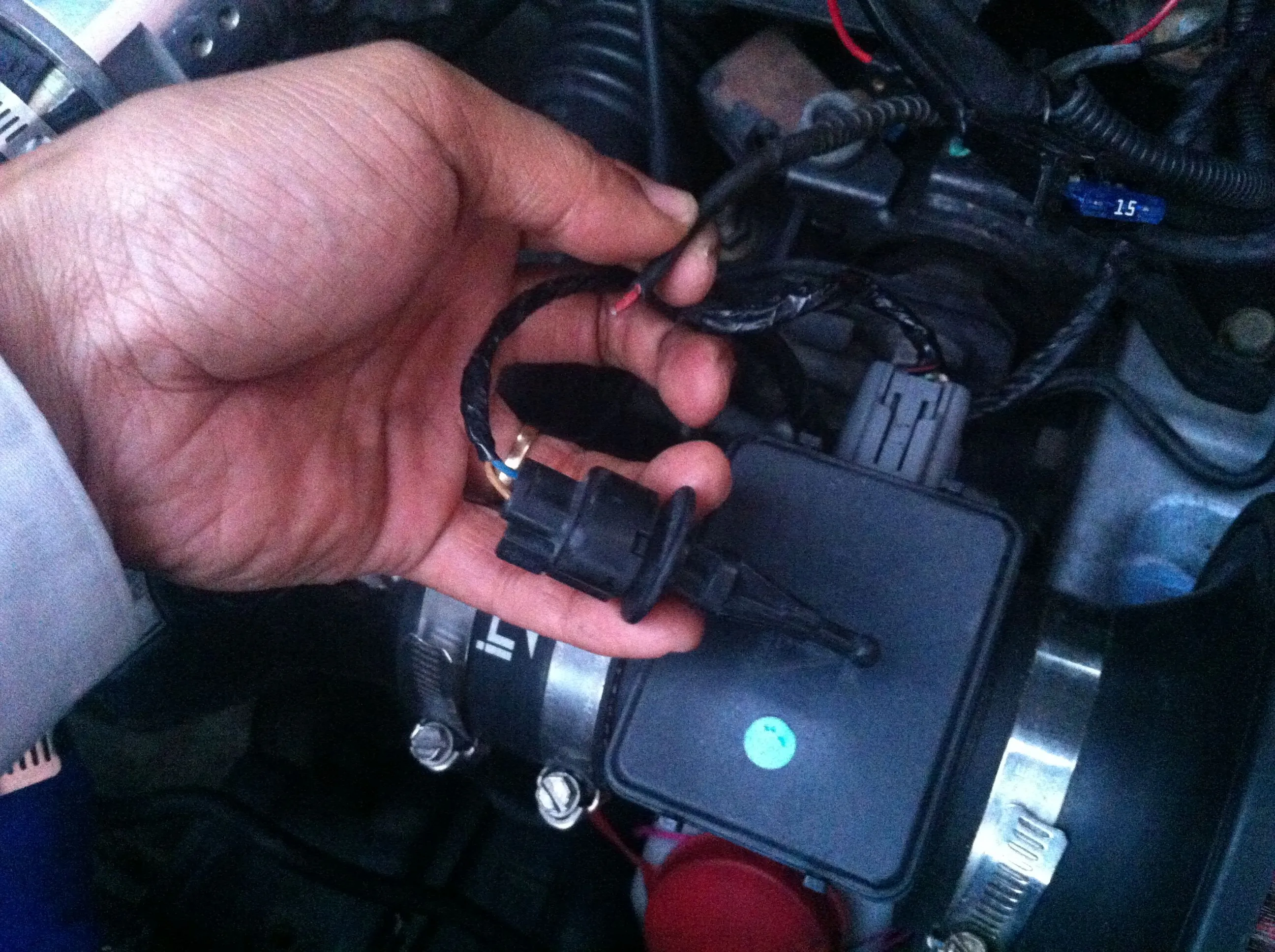

Cleaning up under the hood I found this hanging way below the MAF. There is also some cable coming out from behind the battery. Im pretty sure the cut red wire use to be the Viper alarm speaker but shouldnt that sensor (assuming thats what it is) be IN the flow of air?
Also the exaust manifold only has 3 bolts! I took the cover off and said WTH! Can this be a boost leak or something.
Looks like your IAT (intake air temperature) sensor. Your intern intake should have a hole to the right of your mad sensor ( if your standing facing the front of the car)
You definitely need to replace the exhaust mani hardware asap. The Injen is a cold air intake but the previous owner of your car converted it to a short ram and removed the second pipe that has the provision for that IAT sensor. Many of us including myself have the sensor hanging in the bay like that.
