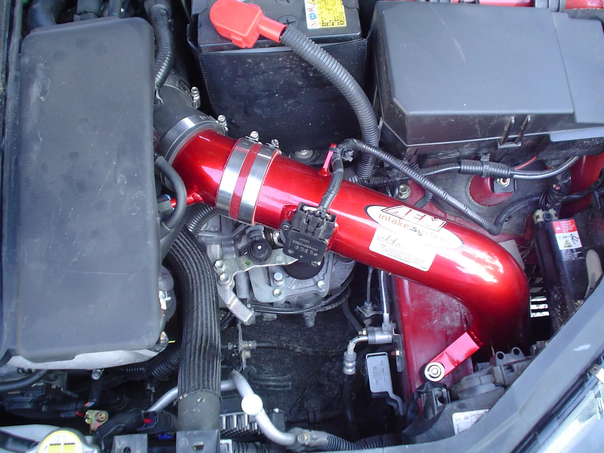

A short ram will still take the intake air from under the hood/inside the engine compartment. Some short ram's will come with an insulating shield that blocks them off from the engine itself. This helps to keep the intake air cooler. A cold air intake will relocate the air filter outside the engine compartment.(usually to a fender well or behind the front bumper). This will provide for a much colder intake charge. The only drawback is that the air filter can be put really close to the ground and if you live in a wet area you could damage the mass airflow sensor or if you drive through a foot of water you could suck the water right into the motor and hydro-lock it. I know that AEM (and probably others) makes a valve that will prevent water from being sucked into the motor. I attached a picture of my CAI. The motor is on the left and the air filter is in the fender well on the right (drivers side).

It looks like the regular 6 has the same stupid super restrictive airbox that the speed6 has. A CAI will make a difference...it did for my speed6. But for you it looks like a short ram will do the same for half the price.

Yes sir 21-641. I got it from Kuruma Motoring on ebay. Final price $255 after shipping. Though I must warn you I don't have the computer reflash and when I ran this on 93 octane I had serious power loss issues. I've been running on Sunoco 94 since the second tank after installing the CAI and I haven't had a single power loss issue since.
