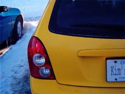

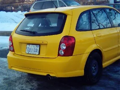

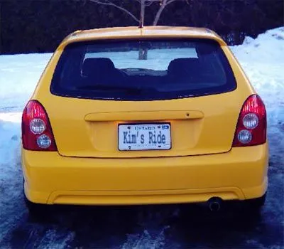

My rear is shaved. A buddy of mine did it for a bottle of nice scotch! lol. He welded the holes and all that. U can't even tell it was done!! I'll try to get a picture! The car's pretty dirty right now, damn winter.

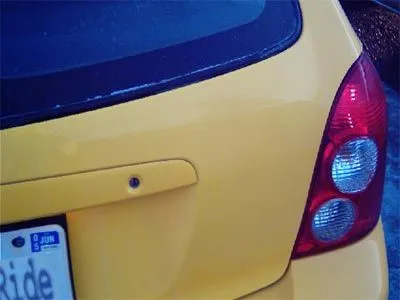

Here are some pics....sorry I have a crappy camera......

Well I got the holes filled + fiberglassed that other thing above the liscense plate.. the weatherstripping or whatever its called.
