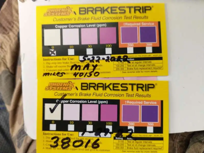

I like everything about your last response buttttttt maybe save the money by getting the fluid check first. The recommendation may be every 2 years but then again, most factory service guides even suggest testing the fluid first. Brake fluid is not cheap nor the complete and proper brake fluid replacement service.

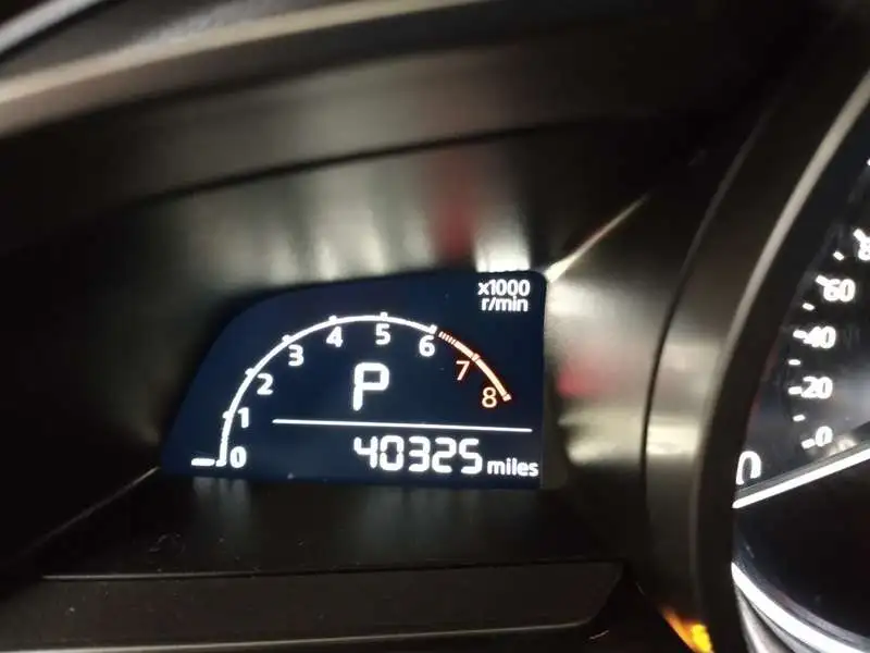

I frequently check mine and here are the last 2 in my 2022 record book. I have not yet changed the brake fluid. I will in the near future but that's because of the BBK install.

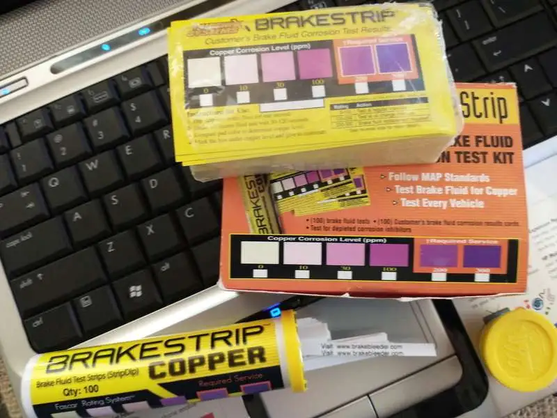

So... along the lines of this thread at least... I just bought a brake fluid tester (the cheap battery powered type that estimates water absorption by measuring conductivity). But when I go to try to access the fluid, there's a pesky grid filter in the way, that's clipped into the filler neck.
Anyone have any tips on how to (or if you can) remove this without damaging it?
That cup just snaps into place and is easily removable. You just need to look for the lock tabs and carefully release them. The curious thing which is often misunderstood is that all you need is to sample any of the fluid. The test while only indicate the water/copper content of the reservoir does give a good indication of how the rest of the brake fluid is closer to the calipers where it is more likely contamination can enter. If you are still on the low contamination side, then the calipers may be slightly higher. Fluid in a hydraulic brake system takes a long time to re-circulate so experience comes into a factor when testing the fluid at the reservoir.
