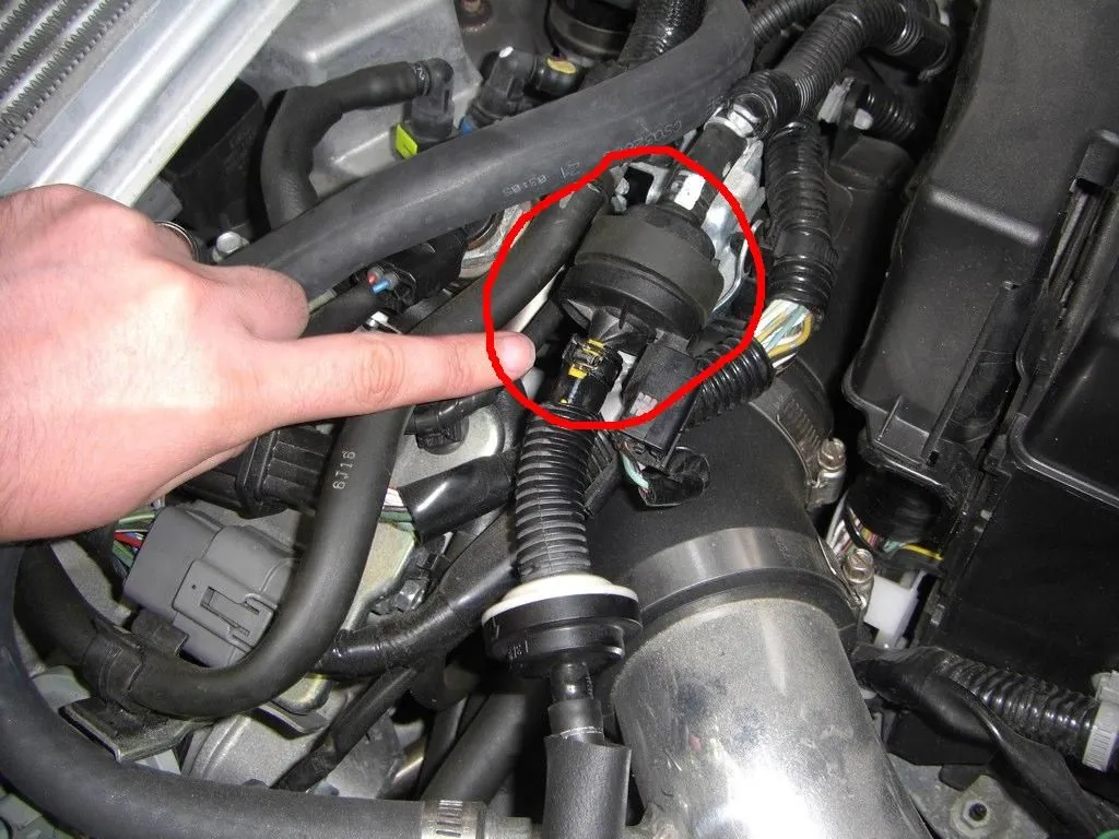

So I been meaning to do this guy for a while, finally got around to it. At 45k miles I am going to run some SF through my motor and see what comes out.
I should credit Zach (Sport 6) since I sort of borrowed/stole his photo from another thread.
I disconnected the hose below (in the photo) or downstream of the coupler doo-hicky thing circled in red. As soon as I did the car sputtered a bit and almost stalled but then recovered. I figured it would do so but just want to make sure its not bad for the car.
The tube made a hissing sound as it sucked in air. I have 2 cans of SF. Im going to pour half into the intake line here, half into the gas tank, and half into the crank case. Then let it sit for 5 mins before starting it up and reving the engine to burn off the sea foam.
Only questions are am I doing anything wrong here? Don't want to kill my car by mistake, and I have about 1/4 tank of gas left. Do I have to wait till I burn it all off before I change the oil?

HUGE SUCCESS!
I just went for it and decided to stop worrying about blowing up the car so much and take a risk.
I did a bit more then a half can in the vacuum line, a bit more then half in the crank case, and a bit more then half in the gas tank. I know what you are thinking. That adds up to a bit more then 3 halves.... true. I had two cans... whoa intense I know.
Anyhow took er for a drive since all the white smoke was filling my neighbors yard and i didn't want them to have to shut their windows and doors. Got home changed the oil and all is good.

I used the line between the radiator and the motor. The blue clip is easy to remove and it's easy to slip a hose over the connector to let it slurp up the SeaFoam. I did mine at ~16K, so the smoke wasn't much. None in the crankcase, since I'm at least a month from changing the oil. Half a can or so in the gas tank.

So re-reading this i'm confused. The line I used to put it in the engine cleary works. But which line is the break boost line? Where do I find it? Is one line better then the other?
That's what I was wondering before I do it. I just want to use the most efficient source to get it into the upper cylinders.
Look between the motor and the radiator. There's a hose with a blue clip on it. Unlatch the clip, pull the hose off the coupler. Then put a small length of hose on the coupling. Have someone keep the motor running and let it slurp about a third of a can into the intake. It'll try to quit, so keep it running.
Shut it off and let it sit at least five minutes. Start it up and watch the smoke. Repeat annually.
The hose I am pointing to in that picture goes straight to the intake manifold. Once you pull the hose off, put your thumb over it. It will stay running fine as long as you have your thumb there. Take your thumb off and immediately put the hose in the seafoam. As long as the hose pulls a vacuum the motor will stay running. one person job.
LThere's a hose with a blue clip on it. /QUOTE]
Is that the elusive break boost hose? If not which one is it?
No, the brake booster hose runs off the brake booster (on/near the firewall). It is, however, a near-direct link to the intake manifold and it is a vacuum line, which is important to accomplish the task. I don't know where the hose goes, not sure I looked. Another forum member pointed it out in a thread.
**EDIT** I just looked at mine again. It looks like that hose runs up to a check-valve (?) and then back to the firewall, maybe to the brake booster. That would make sense, considering the vacuum is at the coupler, not the hose.
