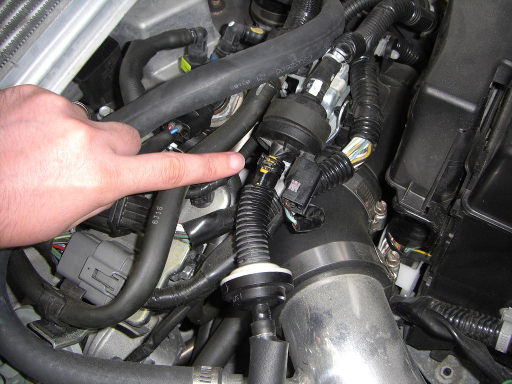

This is where I put the seafoam in (entire bottle). I undid the clamp that I am pointing to and put the hose in the bottle.

haltech's forum has a great how-to in the speed6 section. seafoam goes into the break booster vacuum hose (near the firewall and the top right corner of the tmic shroud).

the egr runs from the back of the firewall down the side of the intercooler, under the intercooler, then into the intake manifold. i pulled the hose i used further up the hose than the hose your pointing at....im assuming its the one with the yellow clip that you used. any suggestions on where this sea foam went then? the pic thats up i used the egr hose to the left of where he's pointing. i believe it says 6J16 on it. if it should have smoked....??

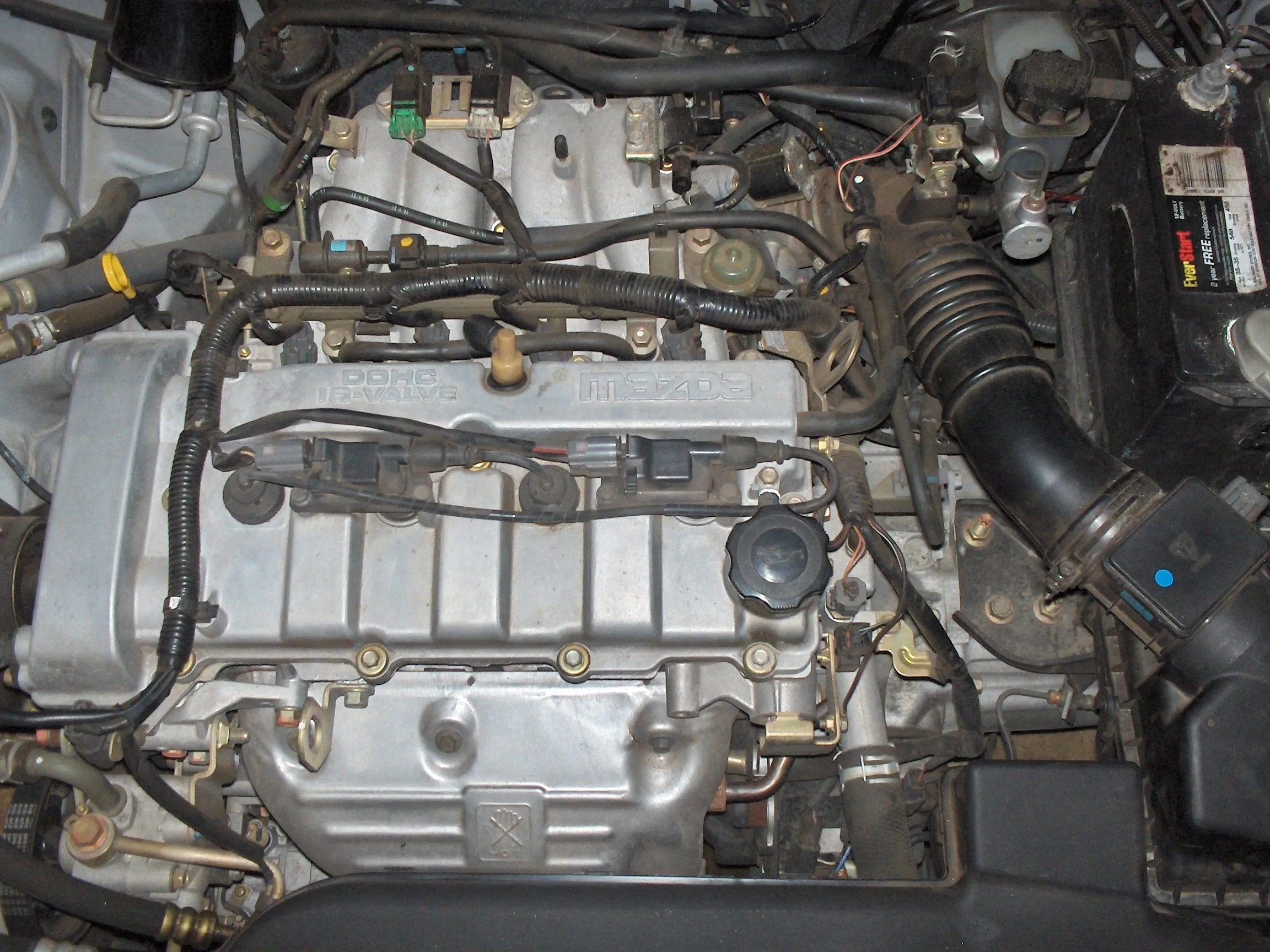

you don NEED to change your spark plugs after but its good to have a fresh plug in there after running the sea foam through and having all that s*** burn through your motor. its possible you fowl a plug in the process but thats just me guessing again. im changing mine but after the sea foam my plugs are fine. (though i had nothing to burn off so my plugs are fine)
yes youll be fine running 1/2 and 1/2. i would run 2/3 through a vac line and 1/3 through the tank, but it all depends on how much gas you have in your tank. 1oz per gallon of gas or something like that. it says on the bottle. you can use pretty much use any vac hose that enters your intake manifold. they all pull the same vac pressure and spit it all into the intake manifold to be pulled into the cylinders. run it until you put your 2/3 can and shut the motor down. let it sit for 5 mins. then start her back up and BAM! tons o' smoke. or in my case....a confused man. lol.
I've had experiences with Sea Foam on my 190k mile 1994 BMW 325i... it smoked predictably like a banshee... I'd be a lil more hesitant with vehicles less than 100k miles, no amount of carbon could be power robbing you at 50k miles - its a total waste!
Judging by the running shell gas only and all I'd say you were just following your pattern of great ownership - but at some point you just gotta let the kid go to kindergarten. Ya dig?
