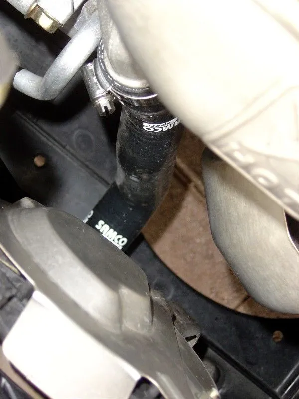

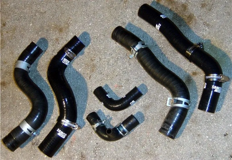

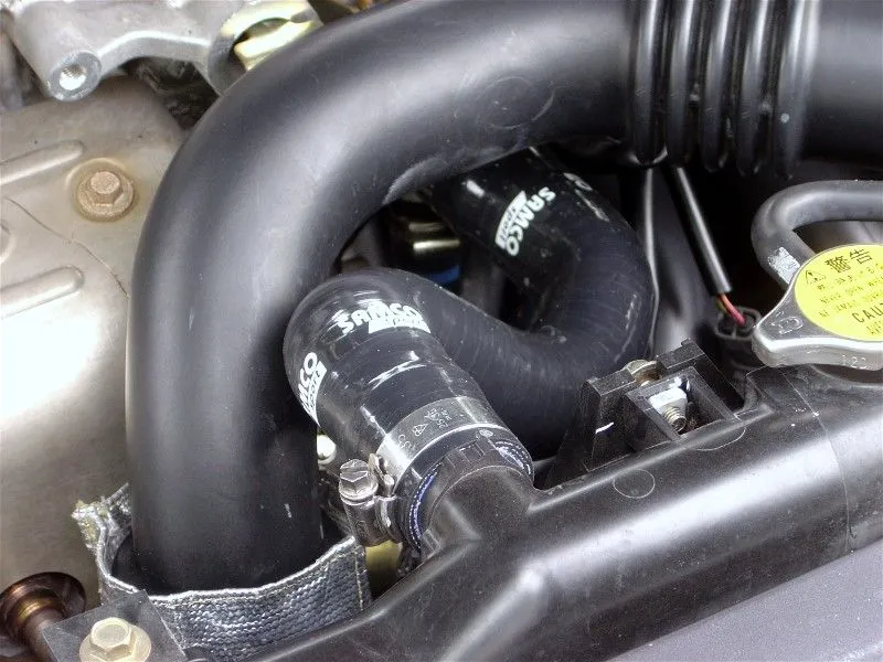

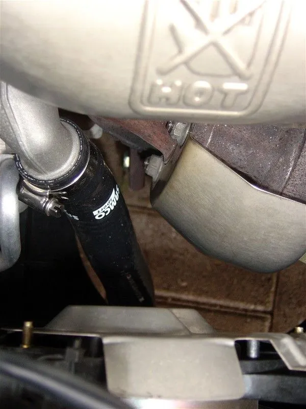

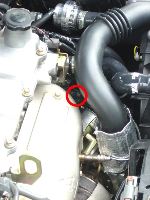

I spent many many hours flushing out all of the antifreeze, taking off the old hoses, installing the new ones, & filling the cooling system with distilled water & Water Wetter. The hoses look great & the clamps work so much better than the stock ones (no surprise). Be advised, it takes a lot of effort to get the hoses off & even more to get them back on. They are a very tight fit, but they DO go on & this just reassures me that there is no way they can leak. For the P5 owners, the small 3rd hose shouldn't be too hard to change, but it was VERY difficult for me. I took it off so that I could take pics showing the difference & also because I wanted to replace the stock clamps with the ones Forge sent (in order to stop my coolant leak). The hoses look great & I am very happy with this purchase.

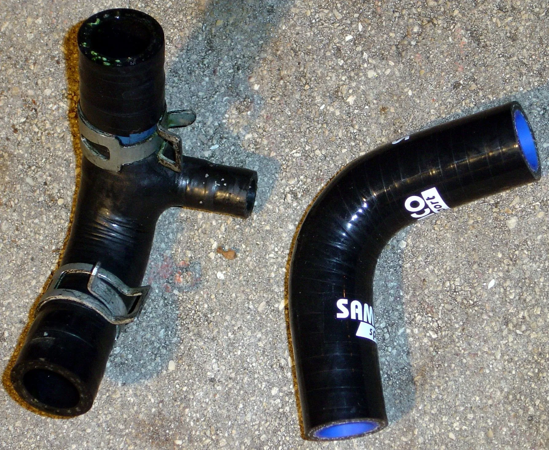

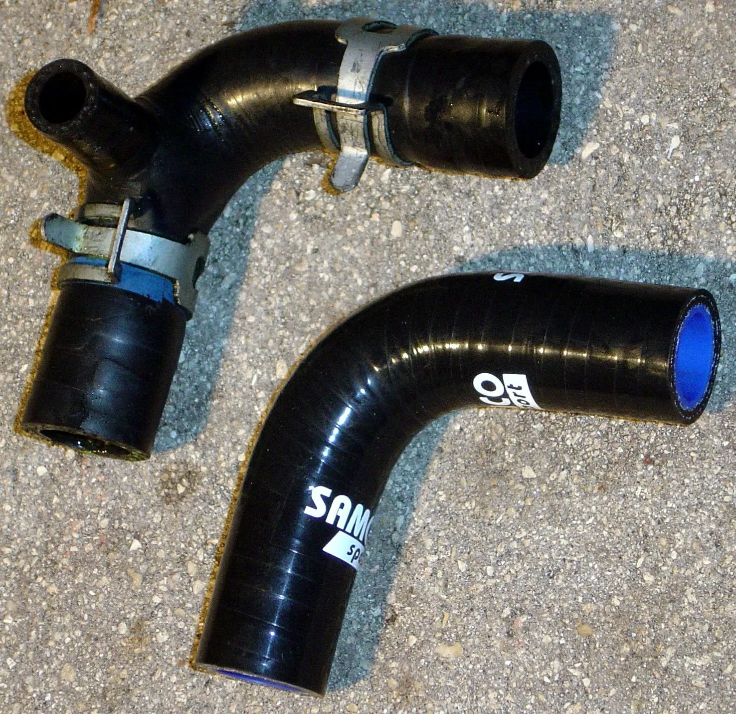

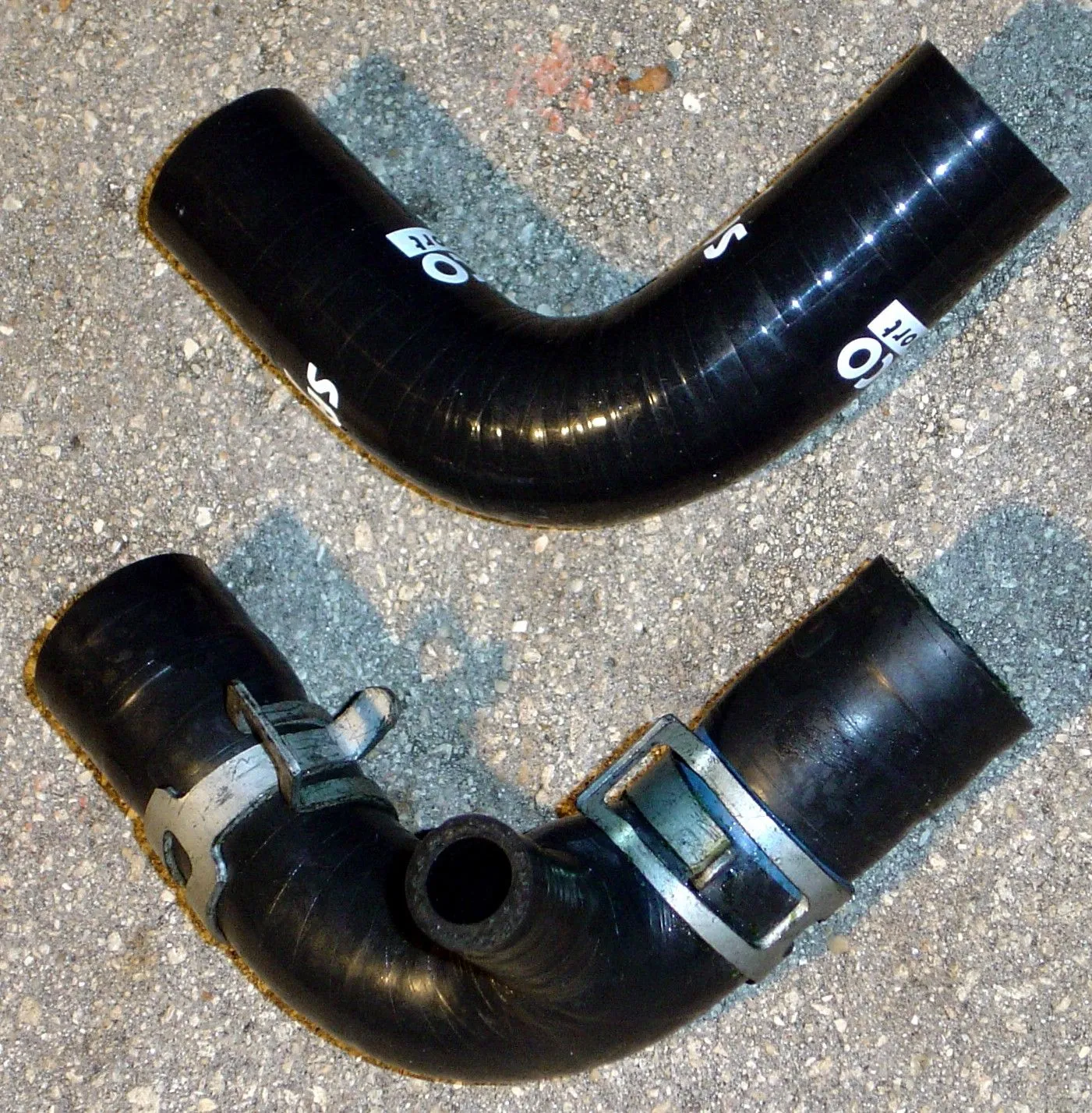

Here are the comparison pics of the MSP 3rd hose & the one for the NA Proteges from Samco.

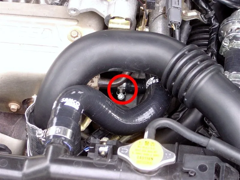

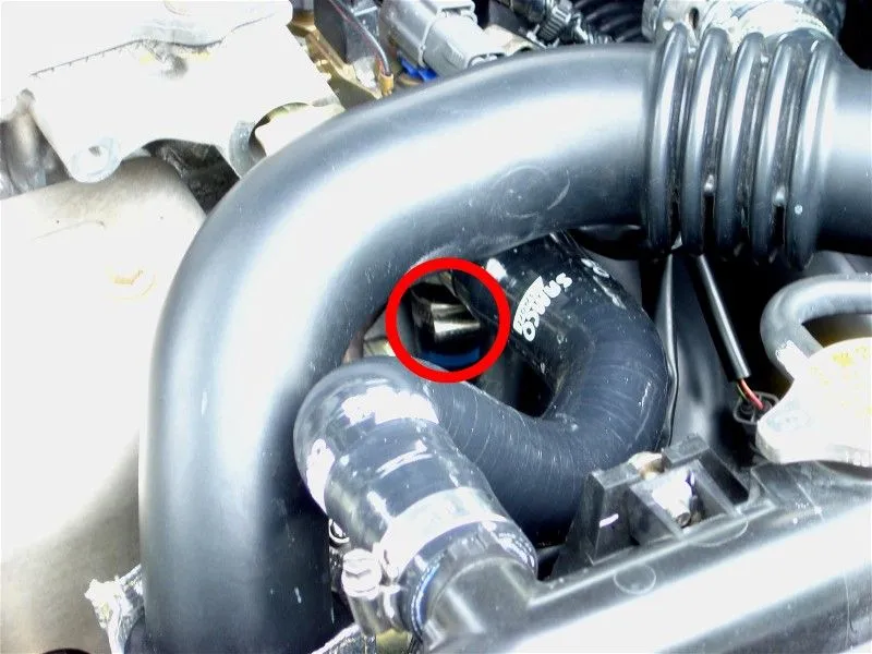

These pics show the 3 clamps that I replaced on the 3rd hose. My coolant leak was coming from the top part of the hose & I think it was caused by the crappy stock clamps.

I know that someone mentioned that it might be necessary to trim the top hose in order to make it fit the MSP. The MSP's radiator is shorter, so the hose comes from the engine & then bends to the left instead of right like the P5. The good news is that the hose fits perfectly. No trimming is required & if you ever swap to a P5 radiator later on, all you have to do is rotate the hose 180 degrees.
As I mentioned, my installation was very time consuming. All together, I probably spent about 6 hours doing the coolant & hoses, but I always take longer than most people the first time & I stopped to take pictures, etc. For those of you who have yet to receive your hoses, if you have any ?s regarding the installation of the Samco hoses or changing your coolant (if you do this), feel free to ask me.

Just spoke with Forge, they have actually called me. They were pretty clear that the hoses are designed for the Protege5, NOT MSP. Since they nor Samco never claimed that they will fit MSP, they are NOT responsible for the the misunderstanding, nor will they do anything about it. I want this to be clear to everybody. Please do not call or email Forge about this since there is nothing they or Samco can do about this.
It was posted by azian6er that the hoses would fit the MSP. I should have researched this some more and I appologize for any inconvinience this has caused. But again, neither Forge nor Samco are responsible so please do not complain to or blame them.
The MSP owners will have to do away with 2 hoses. But in my opinion:
1) The small hose on the MSP is not visible anyway...
2) According to Majik, the leak if you have it, is fixed by new clamps
Let me hear any complaints, suggestions, problems.
