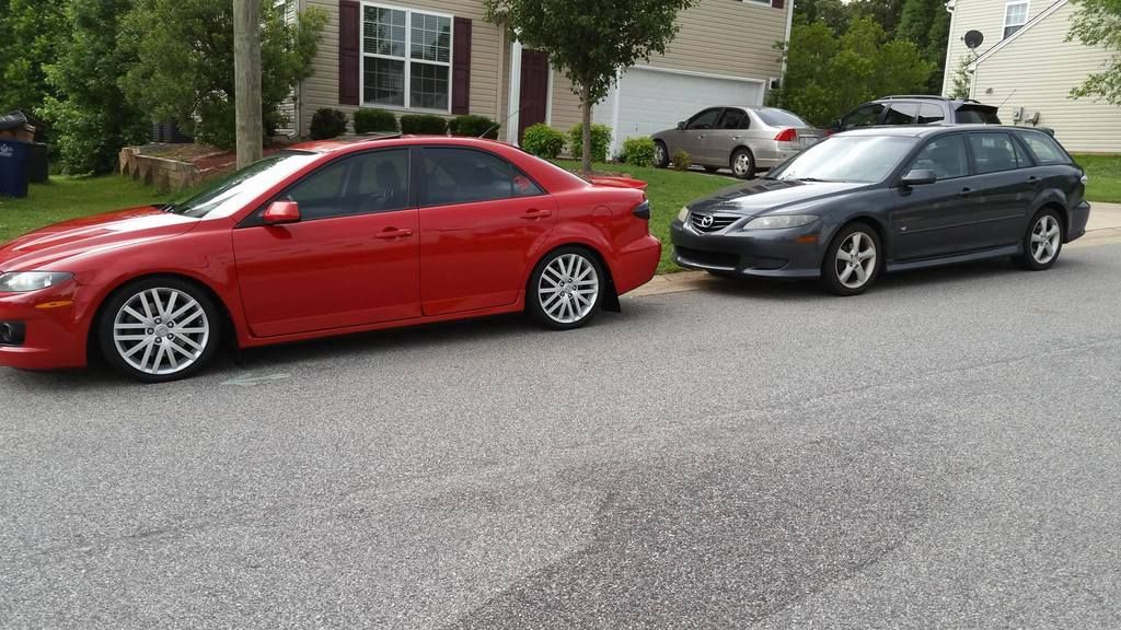

well guys, I didnt buy a 5. but I came home with this, a 2005 Mazda 6 Wagon 5 Speed!
