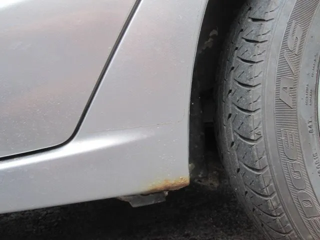

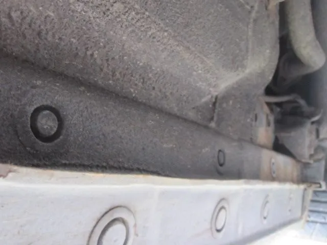

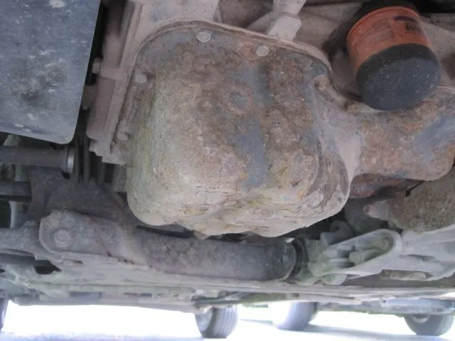

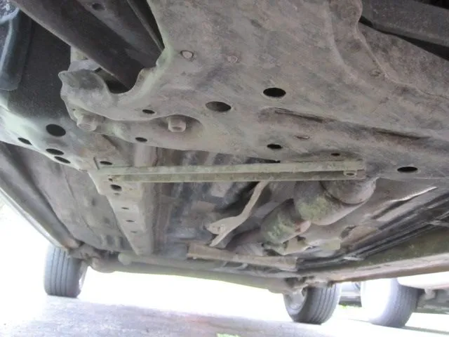

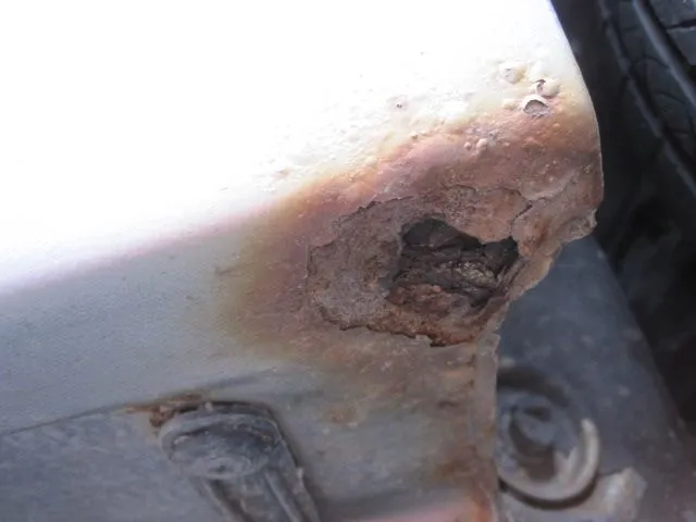

I snapped a few pics. The oil pan seems pretty bad to me. I figure if I keep up with the undercoating spray I should get at least 5 years out of it. At that point my cost of ownership per year should be pretty low and it can go to the scrap yard if it is really bad.

I agree, that's an unusual amount of rust for an oil pan. Rock auto sells a replacement oil pan for $68, so even if it gets much worse in the future, it's not the end of the world for a DIY kind of person.
Most of your underbody looks really solid, impressively so. The rust on the bottom of the fender/rocker/pinch weld section of the car concerns me a bit in terms of what I am trying to evaluate. The 2011 I looked at was trending in that direction, but better in that section, worse moving towards the front of the car. You and I might be okay with it, but my mother in law probably would not be happy. :) I'm not sure if I just need to find one that has been well taken care of, or if I should look elsewhere.
