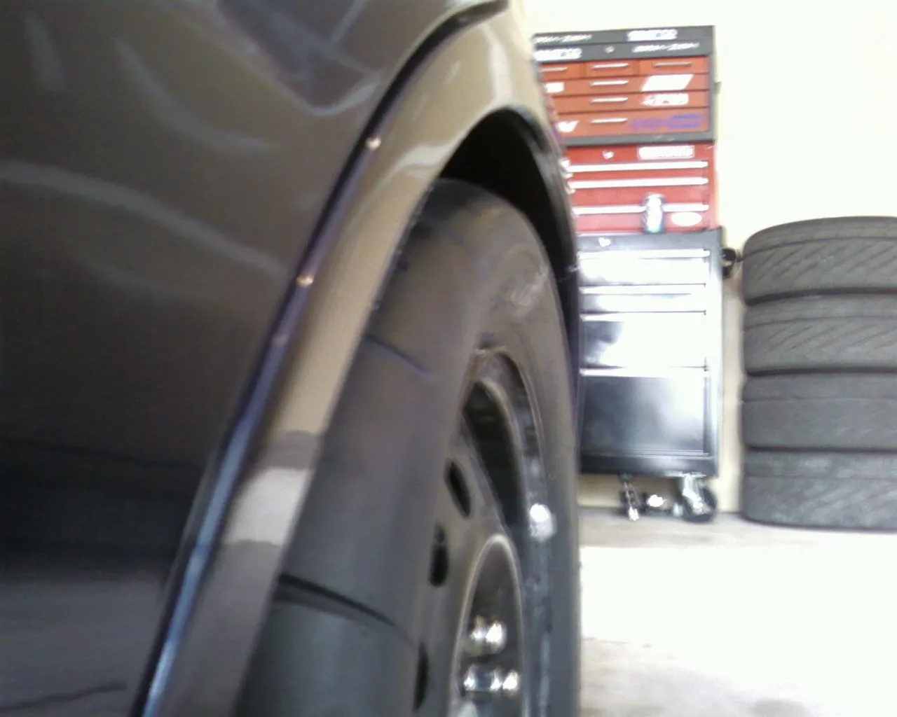

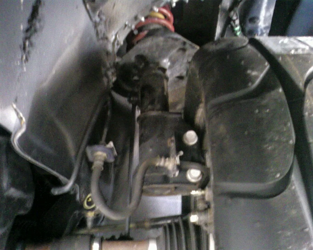

slammed, with ground control coil overs. pretty much figured that I had to roll the rear fenders. theis nittos are only a 1/2 inch wider than what I have on there now and I have yet to mount them. im sure they will shrink up some too. now they are 8" from bead to bead and i will be mounting them on a 7" rim. just wondering if someone had done this already. I let you all know tomorrow what my tire fittment issues will be if there is. thanks.(rockon)
Update
it fits with tons of room. next set im going for 245s baby! of course ill have to buy wider rims but when you see these rims youll agree (nasty free j yard rims). droped my car another 5/8" too(2thumbs)
