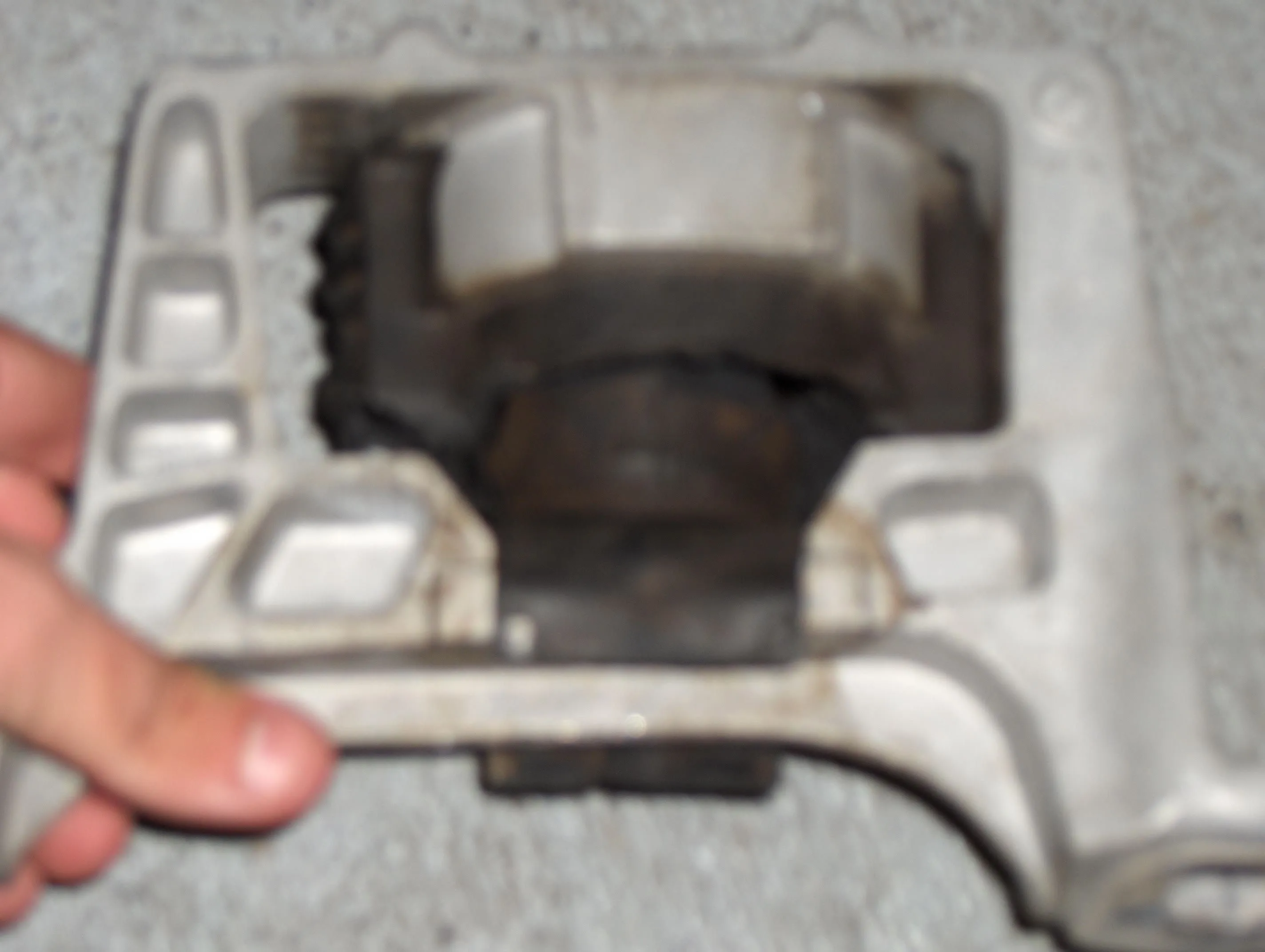

so today i was takin my motor out of my car and i noticed my top motor mount is completely ripped apart. ill take some pics tomorrow but i was wondering if anyone has heard an update on some aftermarket motor mounts?? this would be an ideal time to change them.

sorry about the news on both the rod bearing and the mount. I want to see pictures of this ripped mount

heres a bad pic of the ripped motor mount. i started to cut all of the excess rubber off of it.
