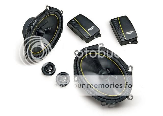

for everyone who wants to change there front speakers and haven't yet, these are the speakers u need to get for direct fitment,kicker DS680 these are 6x8 component speakers as u can see in the pic the tweeter are separate from the mids, this is how the stock front speakers and tweeters are set up if u go with the speakers this guy above me got your gonna loose ur tweeters up top, u can almost use a 6.5 component speaker but u need to get a 6x8 to 6.5 speaker bracket
ok i see u have the i sport Mazda 3 well if u ever get the side view mirrors u can do it the way i side soo everyone else that has tweeters needs to doo it the way i said and who ever doesn't need to buy the coaxial speakers like you bought
Actually, all the stock stereo systems have the 6x8s regardless of Sport model or not. The Grand Touring model comes standard with the component speakers as part of the Bose system, and this is an upgrade option on the other models. And that system consists of 6.5s in the door with .8" tweeters in the pillars. The opening on the inside of the door is for a 6x8 regardless of model but the Bose speakers have spacers that make their 6.5s fit. So really, you could make either choice work depending on how much work you want to do and of course some will require the spacers.
