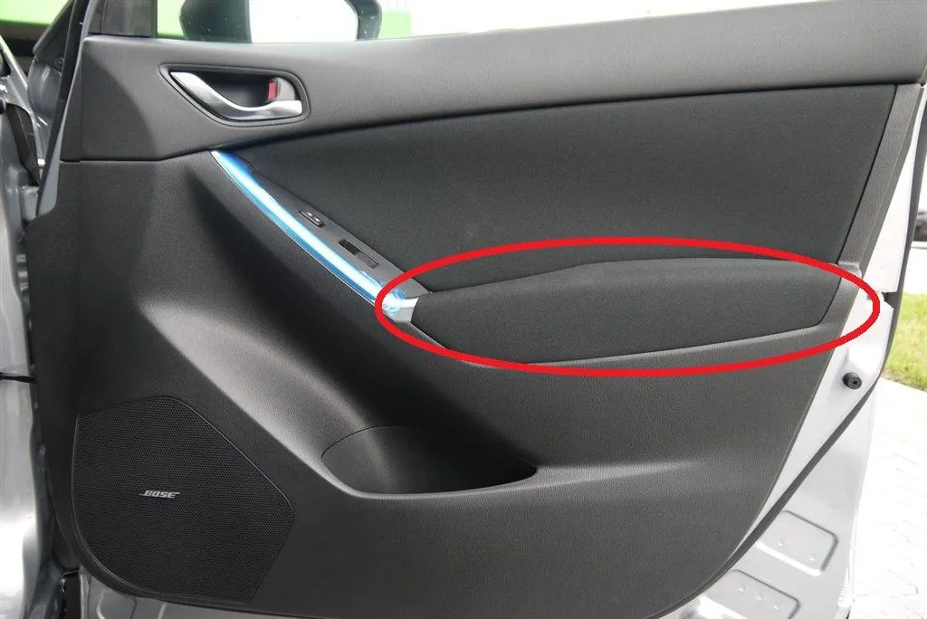

i find the Driver CLOTH door trim for the handle to be a bad design practice. this thing will get dirty and worn out, no matter how gentle and tidy you are..
i would like to replace it with the leather trim part. just the handle area, not the whole door trim...
can anyone tell how can i find the part number of this thing ? please see attached . i am referring to the left side door (picture is showing RH door..)

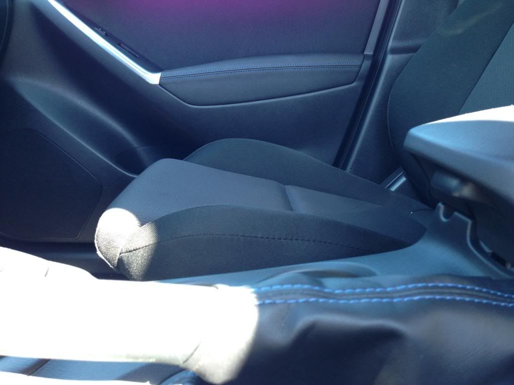

Our 2014 Touring has leatherette (vinyl) on the armrest there, despite cloth interior. Maybe you could get later year door panels? I know, that will be expensive, but at least it's easy :)

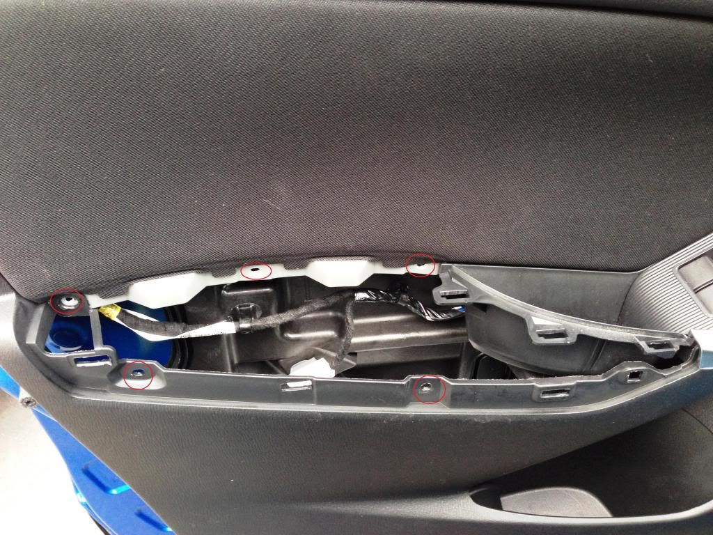

Actually this door arm rest poor fabric choice bugs me ever since i first cleaned the interior, one month after i purchased my brand new 2013 CX-5. No matter what you do to protect that door arm rest against dirt it will become gray and ugly just after a couple of days. Cleaning it too often will only wear the fabric and probably damage it even more after a while. So here i am taking the risk and opening myself the front door panel to see what can be done. Actually it's quiet easy to remove it using the detailed instructions available in the service manual under http://www.mazdas247.com/forum/showthread.php?123825111-Full-Service-Manuals-PDF

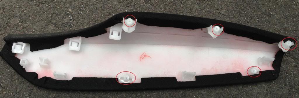

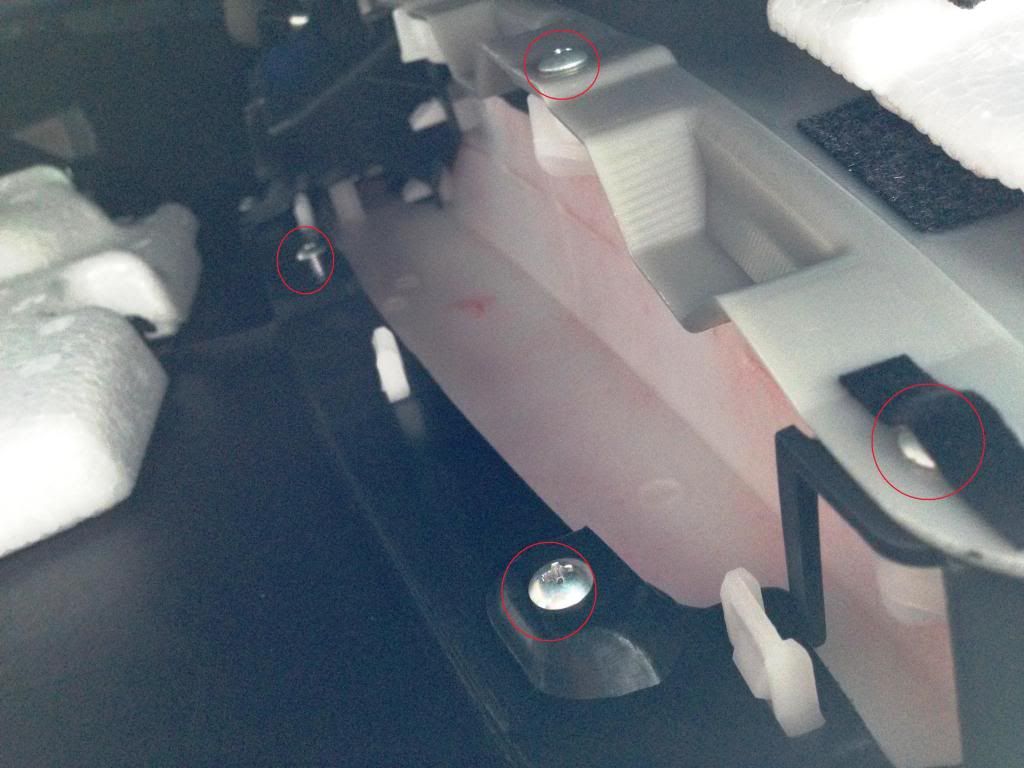

Once you successfully remove the panel you will notice that after another couple of screws you can detach the arm rest (see pictures below, red circles represent the screw locations) and get creative with it. The arm rest is most probably all you can customize unfortunately since the rest of the fabric is more like built into the panel and requires more work/$ to replace it. I decided to bring the arm rests to an upholstery shop to get some quality work done. For all 4 they asked about $140 but got a deal for $ 100 (Pictures with the final result to come) This is just because i will remove and reinstall everything once completed.
Nice! Thanks for reopening this topic and doing the necessary groundwork. Looks pretty straightforward. What you refer to as the "handle" (more appropriately called the armrest) is all that Mazda changed to leatherette on the 2014, so you're accurately upgrading your '13 to the newer style. I'll be interested to see the final result. I was quoted $100 for the fronts (that's all I'd be interested in doing as the backs don't see that much action), but I'll bet I can get it done cheaper if I just bring in the individual armrests like you did. BTW: what kind of material are they using?
paris1 good point. "Arm rest" sounds more appropriate. Just edited my post for accuracy.

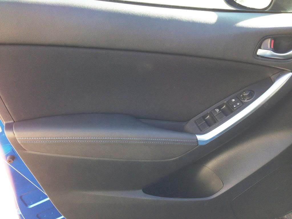

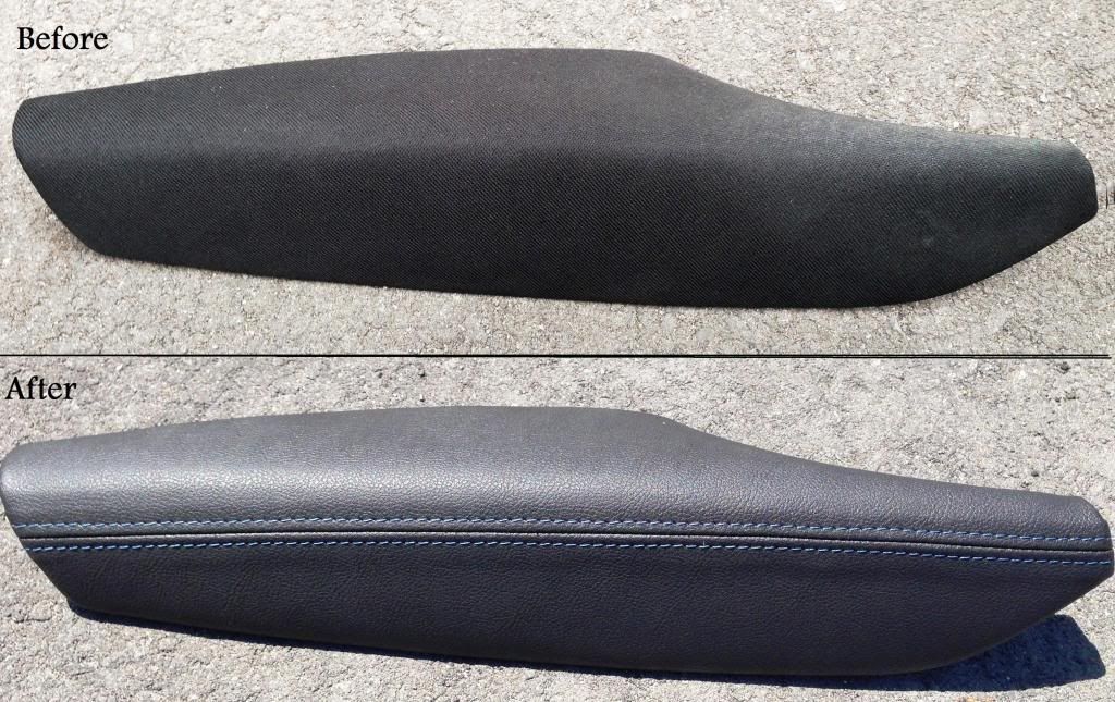

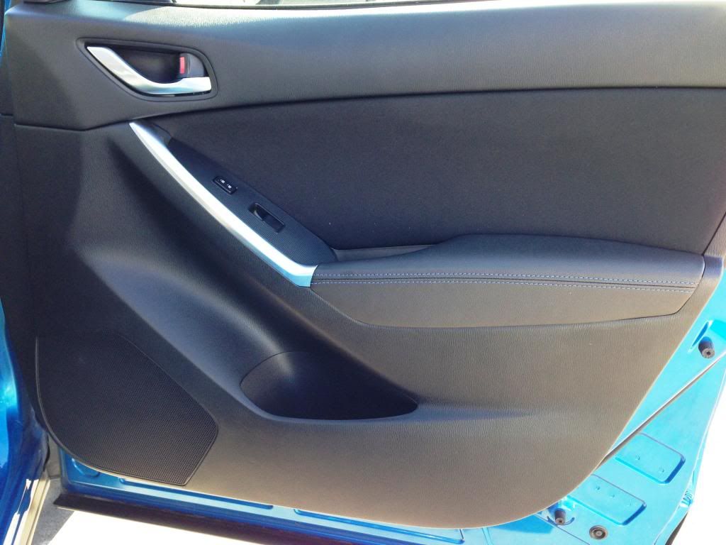

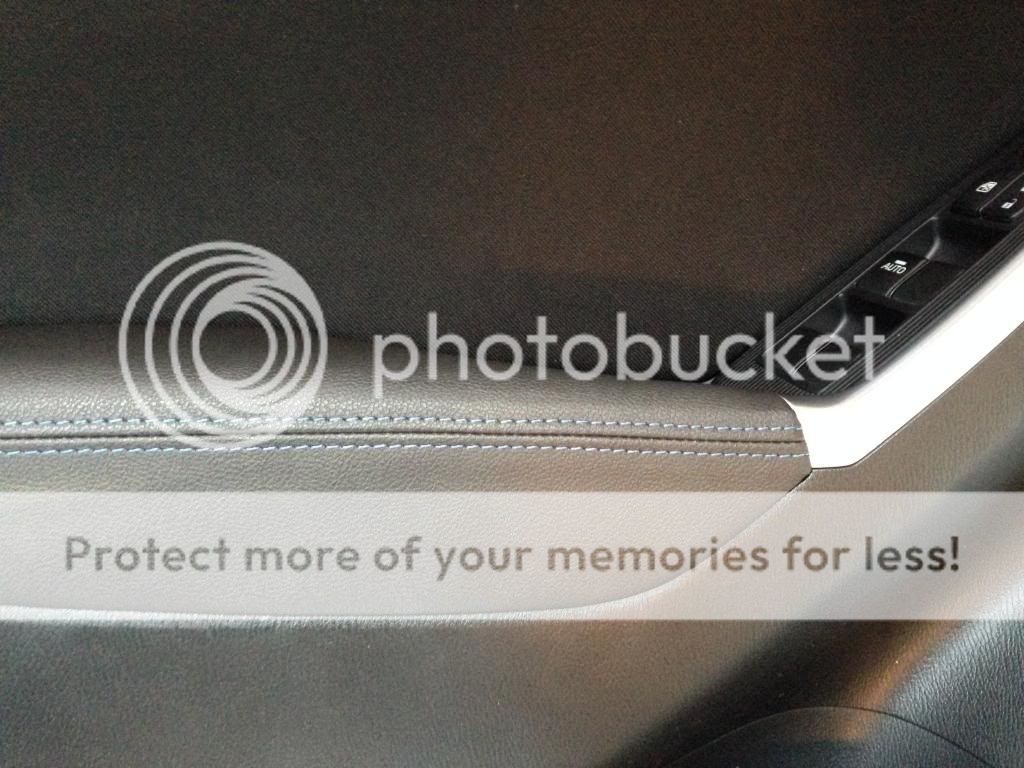

OK. Project completed. Huuuuge difference (2thumbs) .......................Below final results:
Thank you paris1
Due to wear and tear concerns, I picked some kind of industrial type vinyl that the shop recommended.
I had a shop recommend the same to me; that's why I asked. I think leather might absorb oils too readily from your hand.
