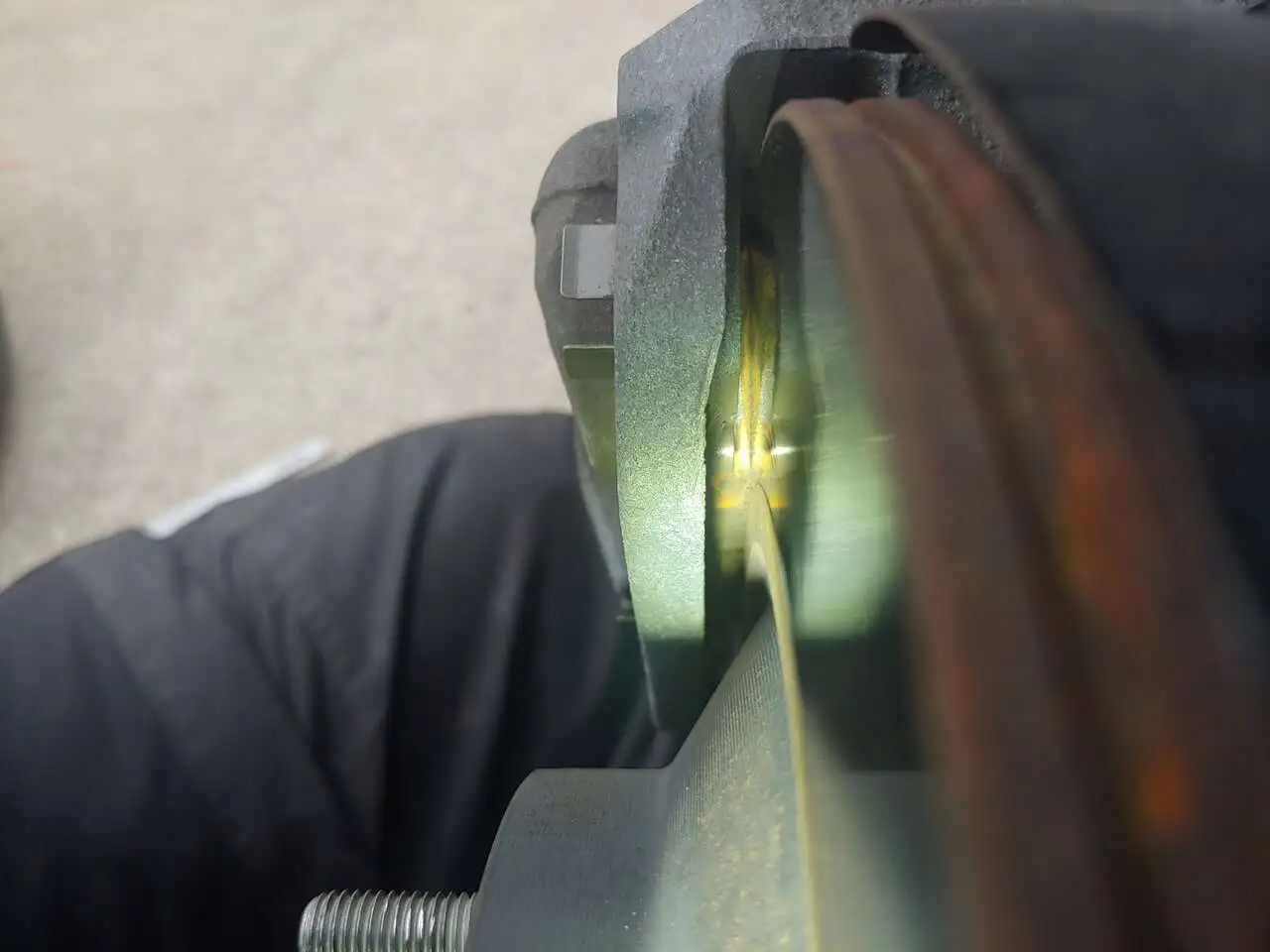

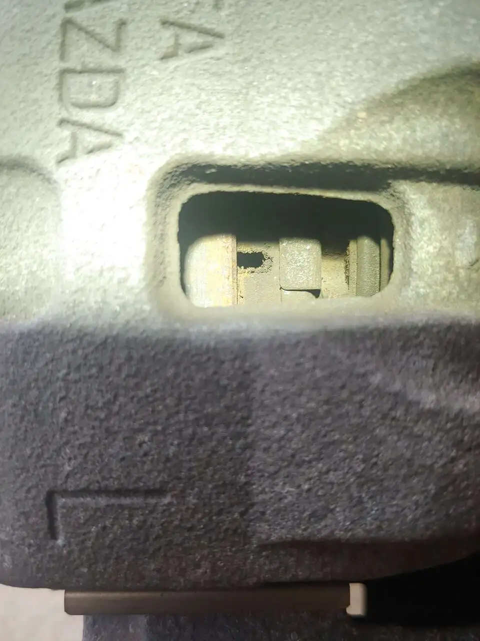

I eliminate external misinformation by checking the condition of the brakes myself. Its easy to do as long as you remove the wheel. There's window openings in the calipers to view the depth of the brake pads.
...There's window openings in the calipers to view the depth of the brake pads...
When that channel / groove in the middle is all gone, you've got about 1mm remaining and time to replace :)
Outer pad you can lean your head in (you DO have it on jack stands, right? 🤔) and look with a flashlight.
This is how I check my brake pad life every time I swap to/from my winter wheel setup. Good ol' trusty eyeball.
