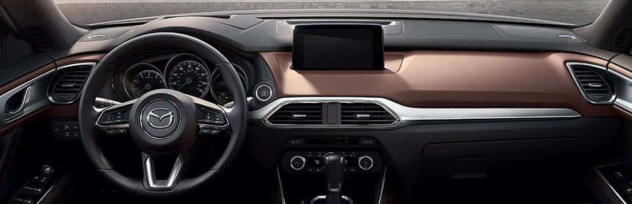

Hi,
I am trying to replace the infotainment system in my CX-9. The interior design for the 2016-2018 CX-9 is the same when it comes to the placement of the infotainment system on the dash (see attached pictures).
Unlike other Mazda models, in the CX-9, the infotainment system (the CMU) does not appear to slide out once the AC strip is removed. It looks like it is in the middle of a section surrounded by a fixed dash. Any idea how to remove it? Will I need to remove the dash section surrounding the infotainment base? or will that base pop open with some plying tools?
I tried to find workshop manuals for the CX-9 for 2016-2018 but no luck.
Any help would be really appreciated it.
Thanks in advance.

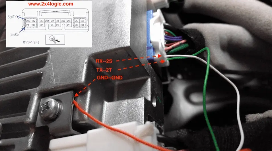

One more question. Would you have access to the video ports schematics? I am trying to get access to the serial port to install Andoid Auto. With all new cars having the 502 firmware update, it can no longer be installed from the US B outlet in the car and can only be installed by accessing the serial port in the CMU.
The video outlet has two empty ports to the right and left side. I am trying to find out which of these can be used for the RX and TX in a USB to TTL.

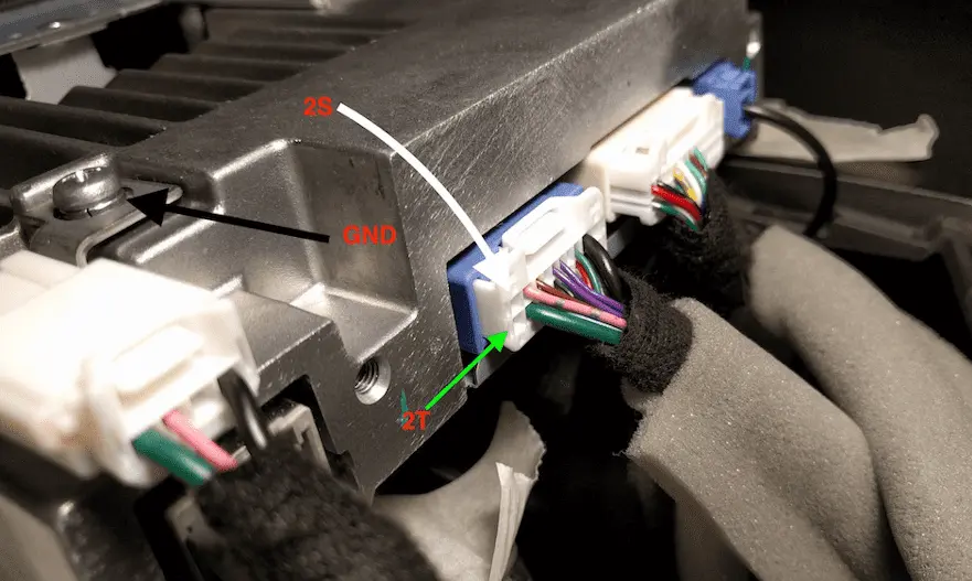

Hi jellyfish11,
I am referring to the video port that plugs into the CMU. in the Mazda 3, this is what it looks like (see attached). in the first pictures, you ill see they have a schematic in the top right of what each port refers to. I suspect the schematics is the same for the CX-9 but I want to make sure before I start to fiddle around with it.
Thanks in advance.
