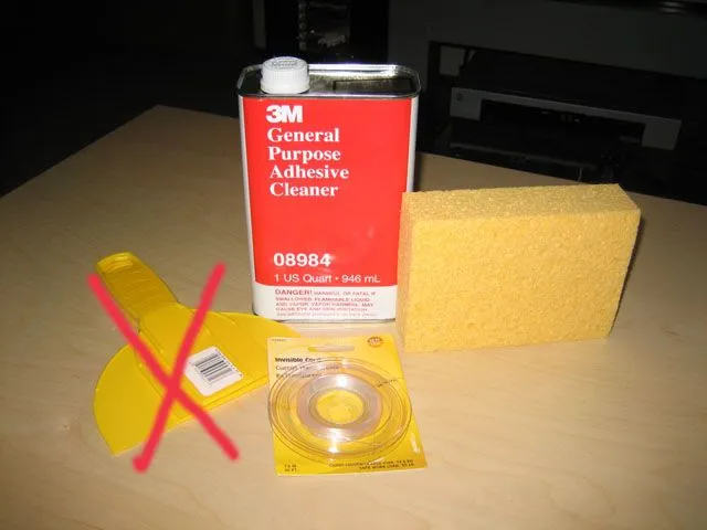

The first picture is of the tools I used. I ended up not using the yellow paint things; you don't need anything like that. I also used a bucket of carwash+water for wiping up before and after (even though I did a wash and wax right after removing the moldings).

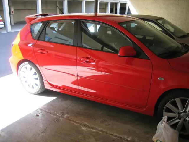

Second picture is a quick snap of the stock MS3 with the side moldings. (This is my first "mod" by the way.) *sniff* The memories...
So I used the sponge and poured a little bit of the solvent over the top crack of the molding. I did this for all four at the same time. I then waited about 3 minutes before starting. I wouldn't recommend waiting less than that; and it would in fact help a little to wait a bit longer, like maybe ten minutes, but this isn't terribly necessary.
The third picture is of pulling the molding off. I was using clear plastic picture frame wire to sort of "saw" it off.

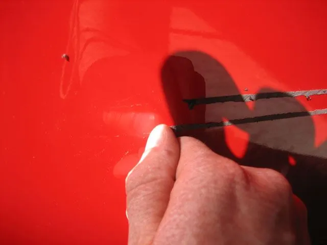

The fourth I wanted to put this picture in to illustrate something: the goop you see on the left is the adhesive that was left over from me "sawing" with the picture frame wire. Where it ends is when I started just pulling it off with my hand. I realized I just needed to "saw" to get it started. To get the adhesive off, I just used my thumbnail (see pic).

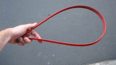

The molding is bendy, by the way (pic).

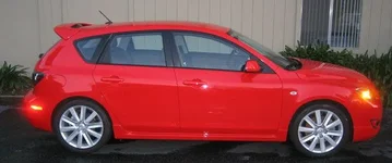

The sun started going down, so I had to hurry up and take pictures with only half the car waxed. The side you can't see is all hazy with unbuffed wax! And I'm also icluding a couple of shots of the side down-low and a couple profile shots.
