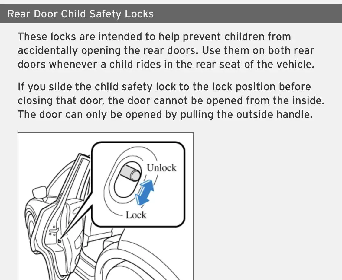

Are the child door safety locks off? If on they might interfere with the windows.

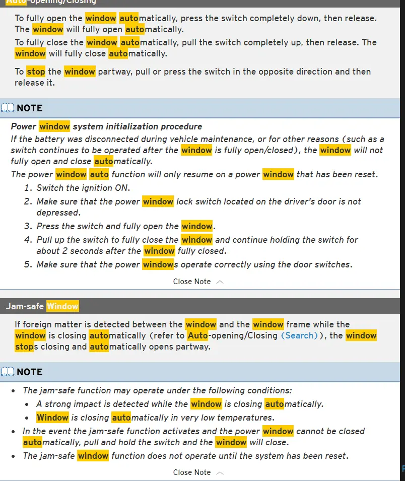

There is a jam safe mode, when foreign matter, like a finger, is detected. There is also an initialization procedure which I had to use in older cars when I disconnected the battery. Looks like that battery disconnects can still cause a re-initialization to be performed.
