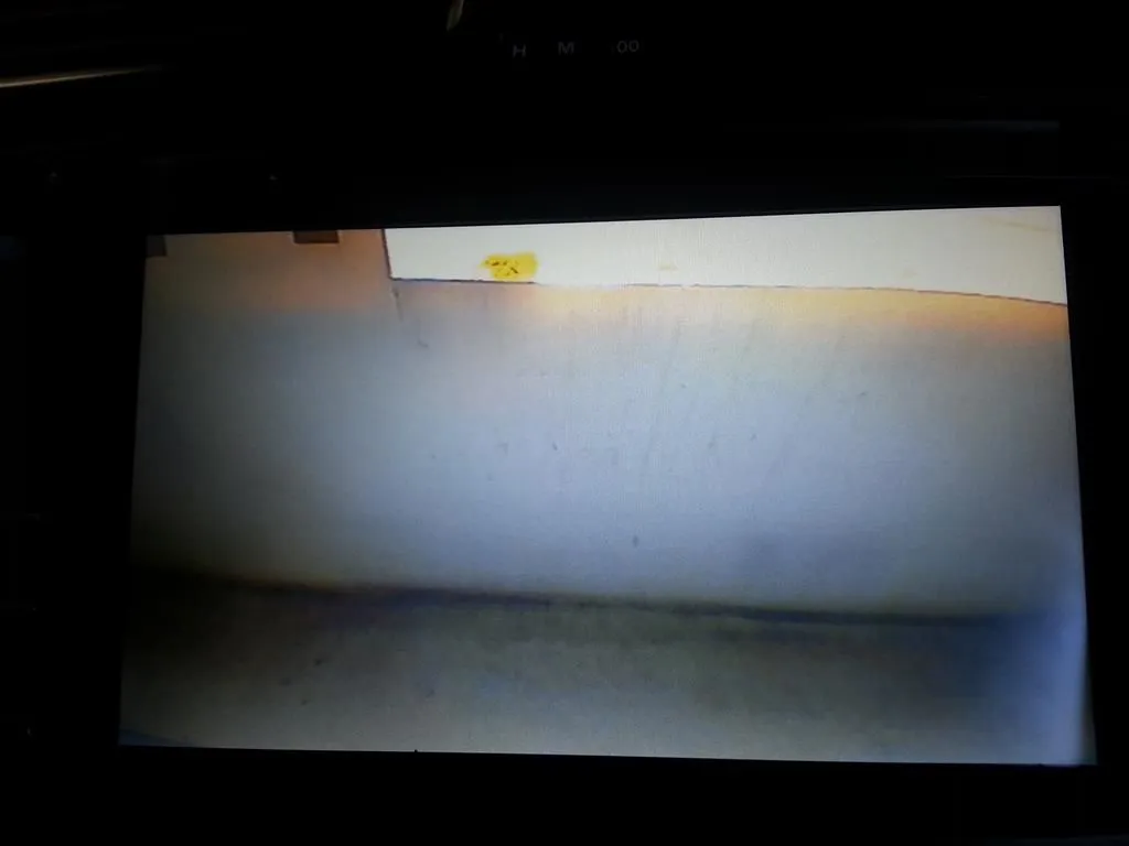

It looks like the camera i have, do you find it angled too low ? On the other Mazdas in the family with the factory camera i a lot further than this ... Not sure if it is the angle or the wider lens angle on the other cars that is different. Will take a loot later on
I would imagine some people may find the angle too low, but personally I think it captures enough of what's behind me, so I've never been bothered with it.
that is how i imagined it should work … i do not see no horizon at all … not even on the sides

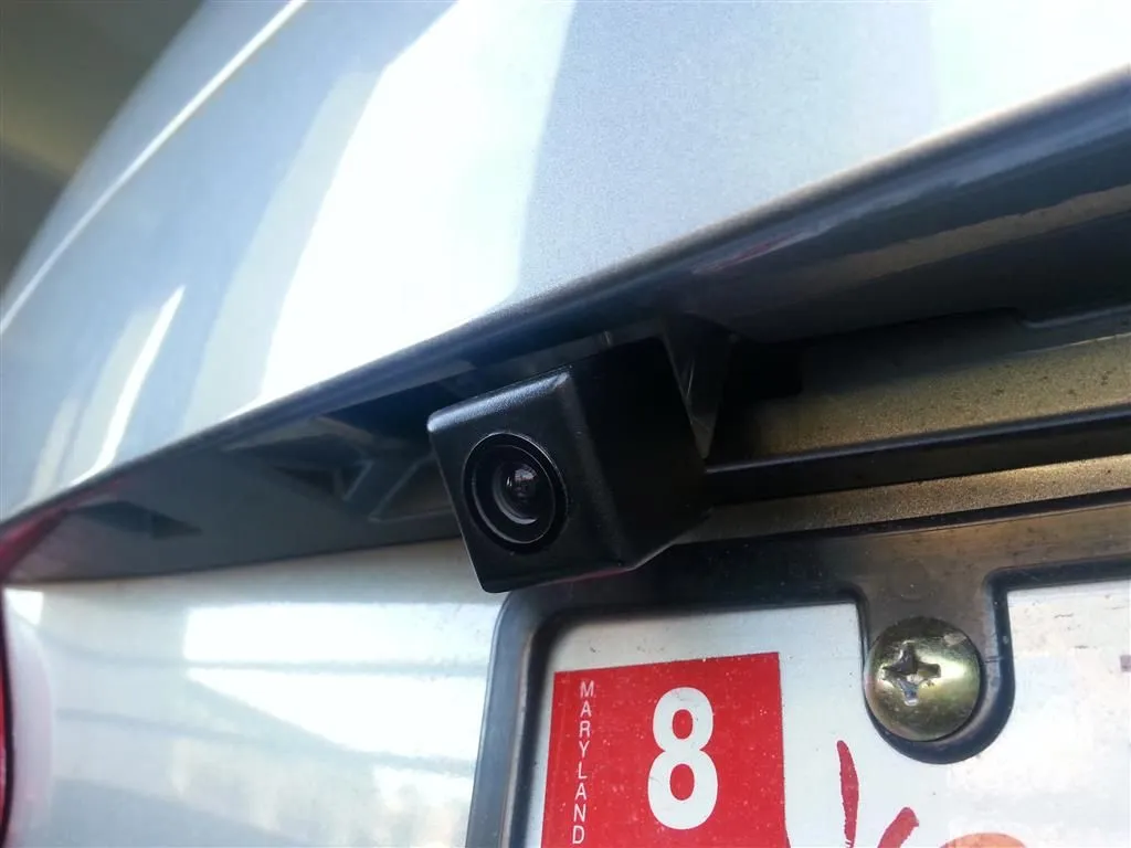

Installed last weekend.
It clips on license light cover.

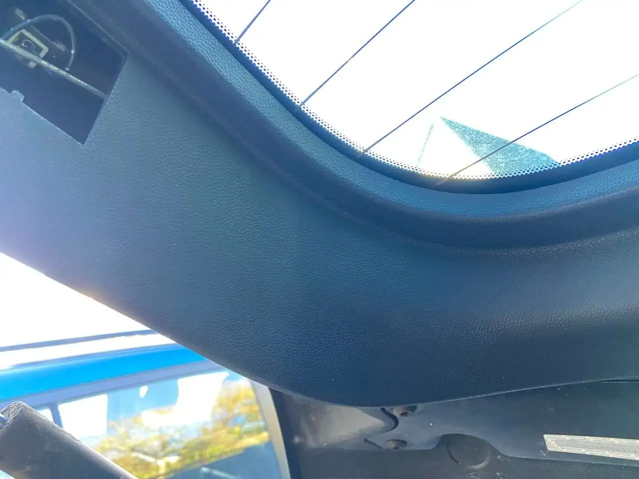

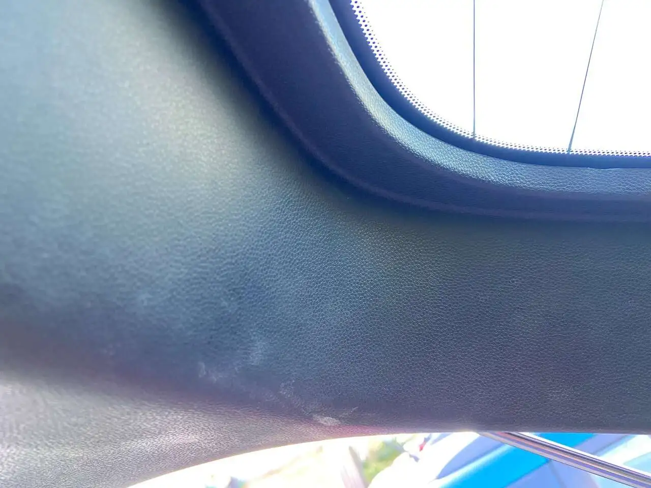

Hi all,
I tried to install reverse camera in 5 Furano - I was using steel wire first before I will do anything more, but in those two places cannot go further with steel wire (something is blocking inside) - not sure if I can push harder.
Any advice?
Thanks

Hi all,
Any advice?
Thanks
My experience: I had to cut the connector and fish plain wire. Absolutely impossible to fish the RCA connector through. Not even the 4 pin barrel connector. Just cut the wire and solder connectors later.
I also used a small camera to see and check the route. I actually used it for fishing the wire through.
The trick is - you need to go around the corner with your fishing wire above the existing cabling, not below, or it would get stuck. Something like this one.
You can also drill a 3/4...1" hole at the lower end of the door trim to fish easier. It will be hidden behind the big rectangular plastic trim covering access to the door handle from the inside anyway.

7 years later, this thread came back from the dead! Glad people are still referencing what was done 12 long years ago. I do not recall exactly what I did to get the wire around the hatch back then so I cant offer much more insight than you've already read. I know it was not impossible and there was definitely room for plugs and things to go through. There was a 6 pin molex and possibly the RCA as well, there's no way I would have cut that harness unless it was truly a last resort. I used a piece of solid wire to fish it through and it went pretty easy, experiment with how the wire is bent at the end, it makes a huge difference.
It bee a while but this is what I recall as well. It may be possible but difficult to find. The path of least resistance is to simply cut/reconnect a wire.
-pre-bending the wire helps a LOT.
-double up wire in a drill to twist and make it thicker
-do it in sections
