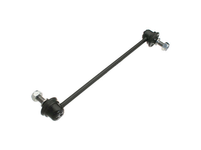

I keep forgetting to look at my gf's car while she is over. her protege loves making 'clunks' and the mechanic told her it was the rear sway bar links. I ordered some last week to do myself, and from all the searching I did, it looks like its for the front.
I received an item that looks like this
Is that right? From most other pictures online it appears that the rear sway bar has two bushings facing the same way, not opposite.

Just out of curiosity, are the front links the same design?
Also, find yourself a grinder or some other cutting wheel. I can almost guarantee that you're going to have to grind off the old endlinks b/c of rust
INCORRECT - those are the links for the front of the car. The rear links have both bushings facing in the same direction.
To the OP, where did you order those from?
my bad.. i thought he was inquiring about the fronts.. slavrenz is correct... the front face opposite directions in the front and same direction in the rear
Thanks guys, my gf got back and I checked it out. wrong part for sure.
