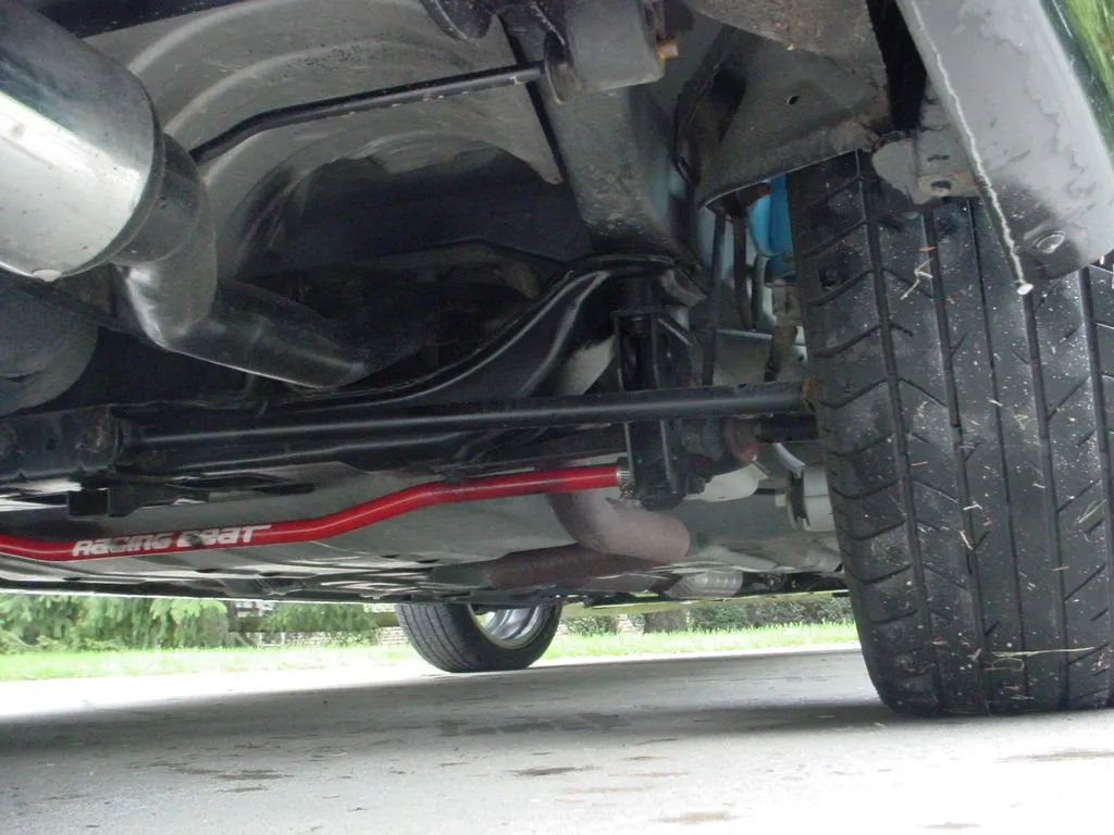

Removed existing bands because I had to relocate the bushings (Delsing prototype kit put on there 10kmiles ago). For the first 5kmiles I ran without relocating the bushings and got a little lateral movement (maybe 1/4"). With the GSHC's relocated and tightened they haven't moved at all, but then again the Delsing kit puts the bushings where they should be - much nearer the bend - so there's less room to move.
You can sort of see it in the attached, as well as my sometimes-on, sometimes-slightly-too-loud-for-me HSM straight pipe.
Hope this helps!

thanks for the pic.
i may consider doing this if Mazda can't get the locking rings to stay in place.
