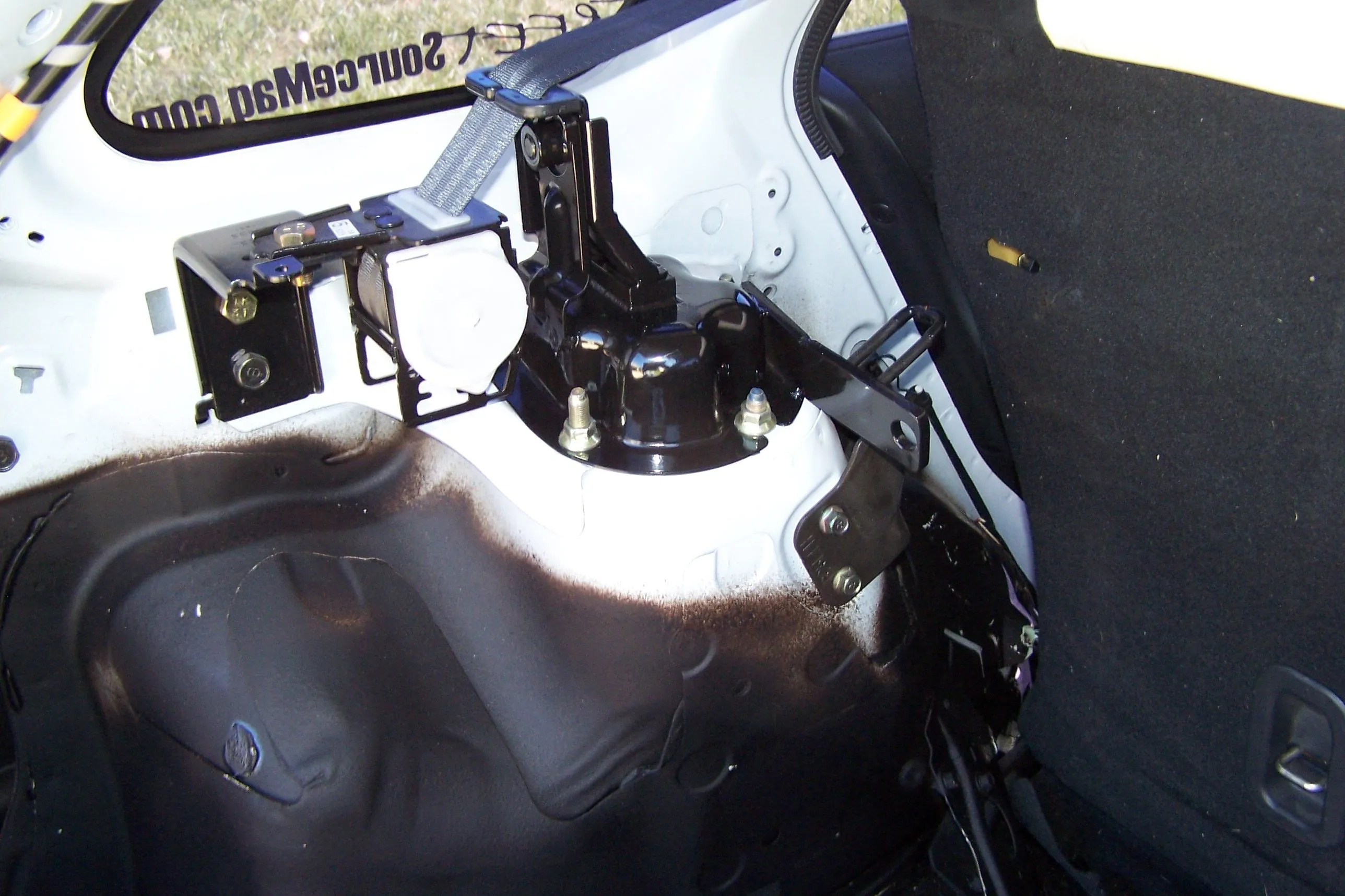

So heres the start...

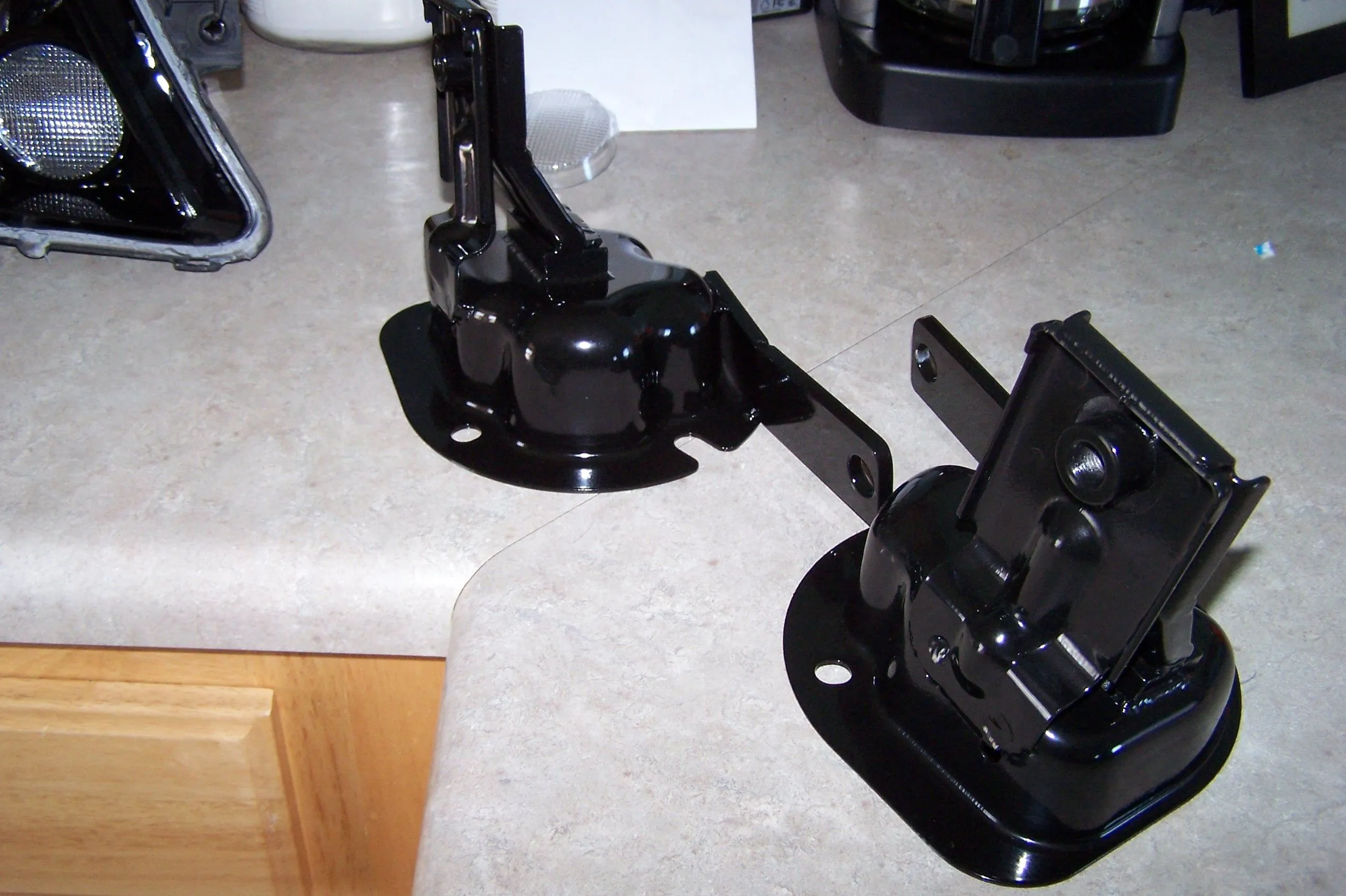

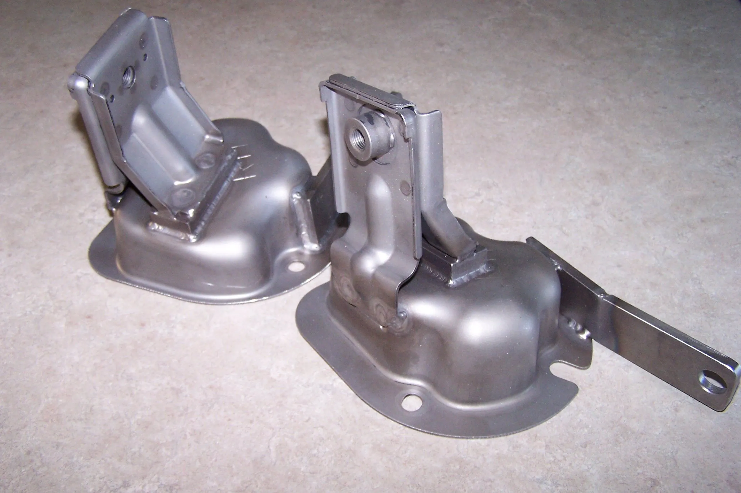

These are the seat belt strap risers that I modified.
I will be bolting them down flush to the tower, instead of having them on top of the strut nuts. Thats why I rasied the the belt stand up almost a half inch, then welded the quater inch stock piece to it to bolt the bar in place. They are sandblasted in the pic. Im having them powdercoated black.
I will post more soon , but you can kind of see the way im going.

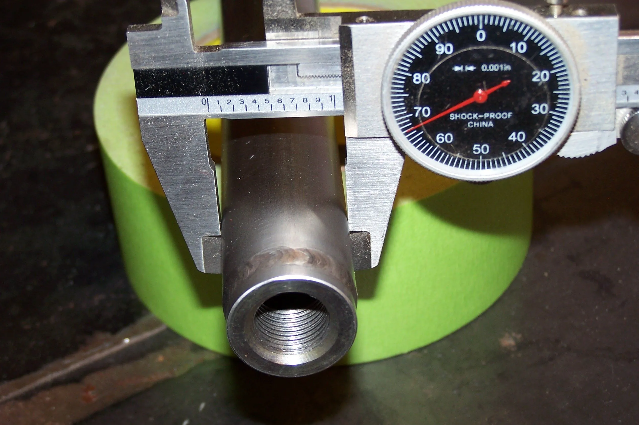

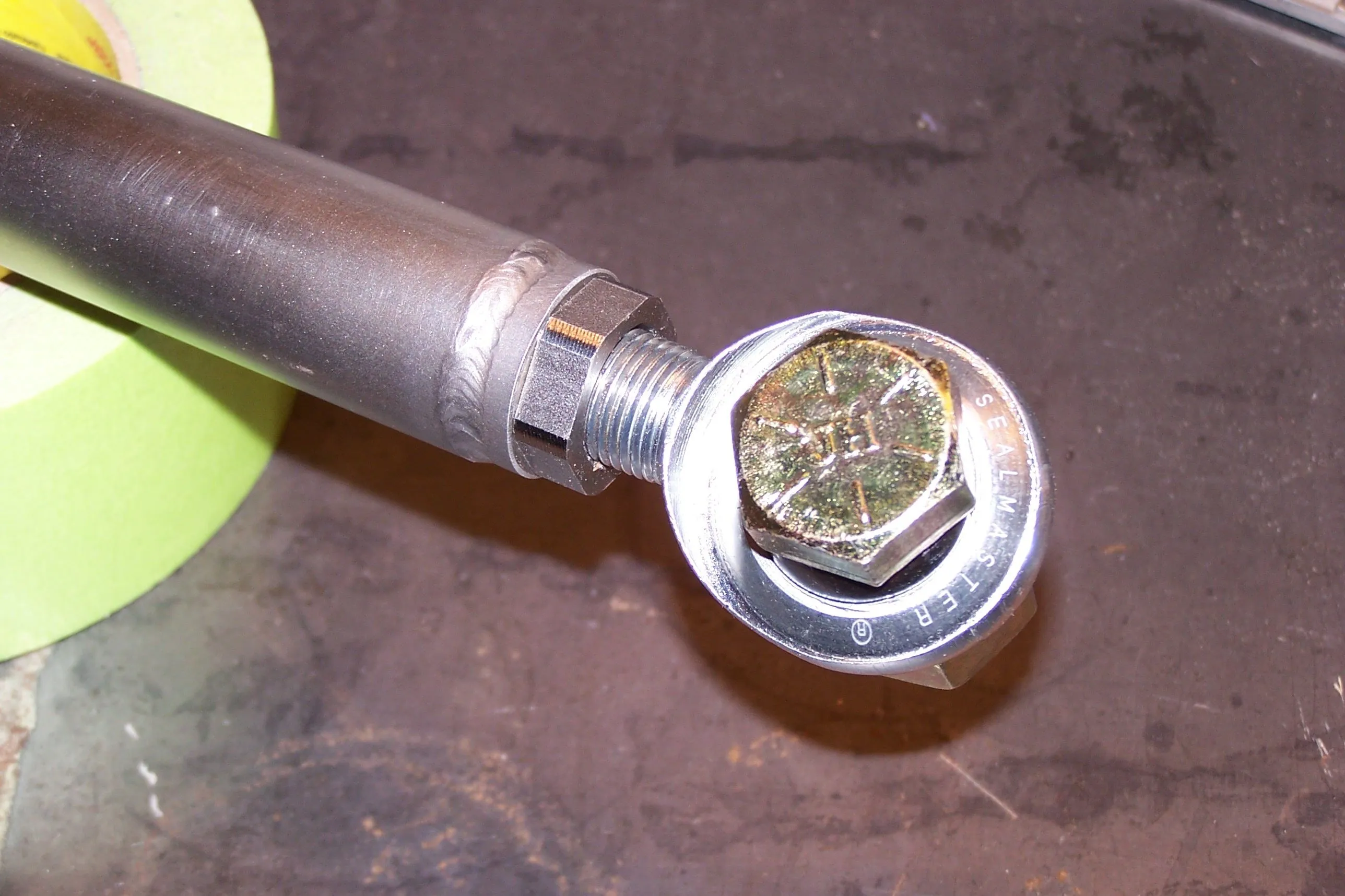

more up dates...

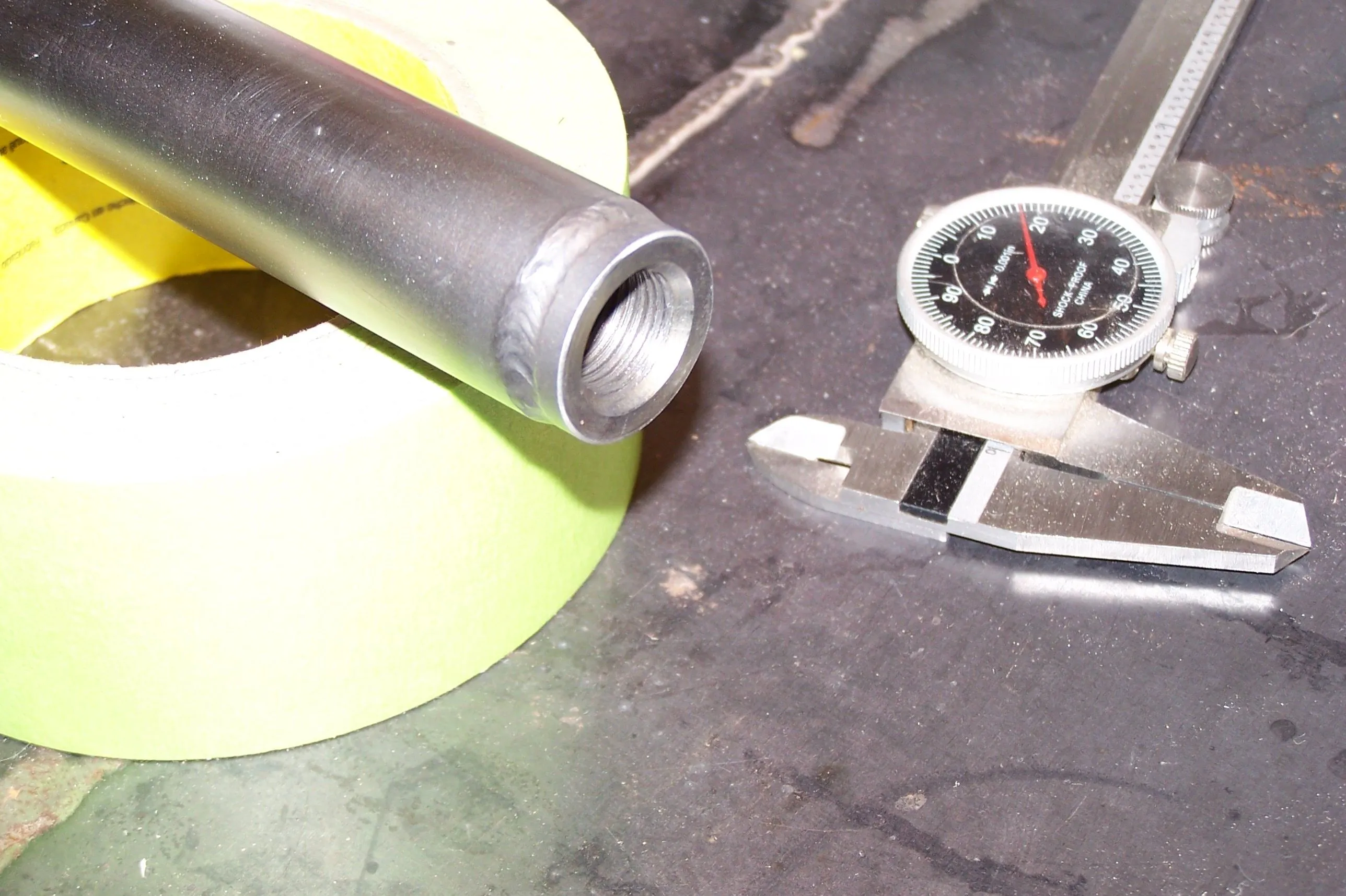

I know its over kill but it will look beefy as heck in there lol

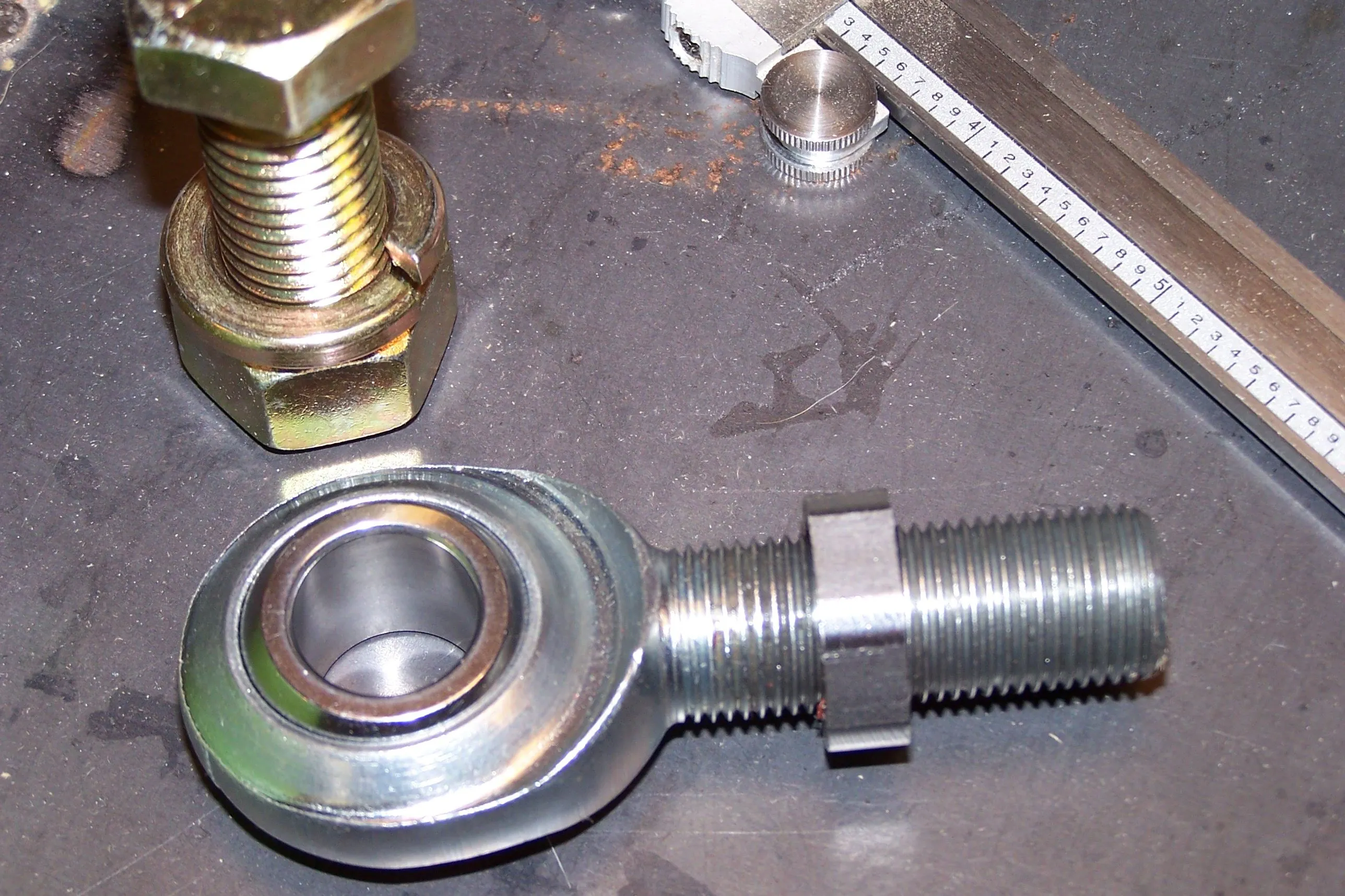

The bar is just a little over a 1in dia, .120. wall stainless steel, with 5/8-24 threads... and 5/8's bolts to attach it to the brackets.
Should have the tower brackets back from powder coat today. So maybe install this weekend. Just hope I dont cut the hole to big in my side plastic panel.
Trying to decide if Im going to black my head's out this week too.....

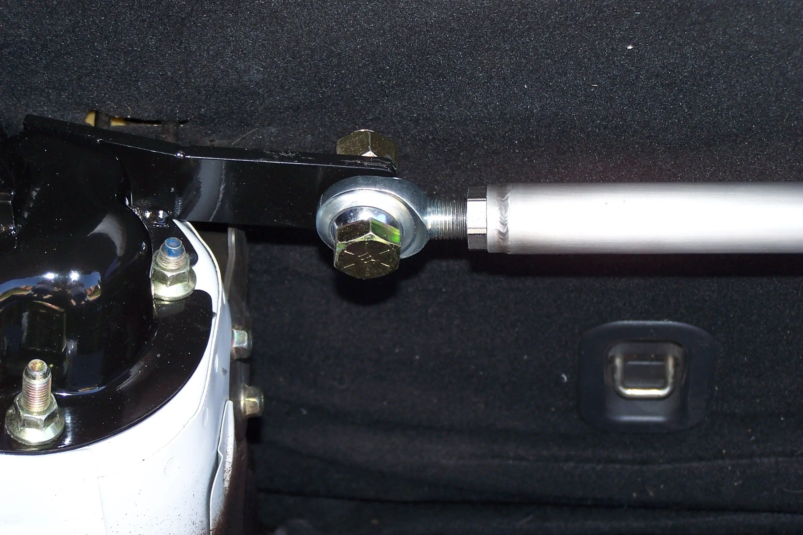

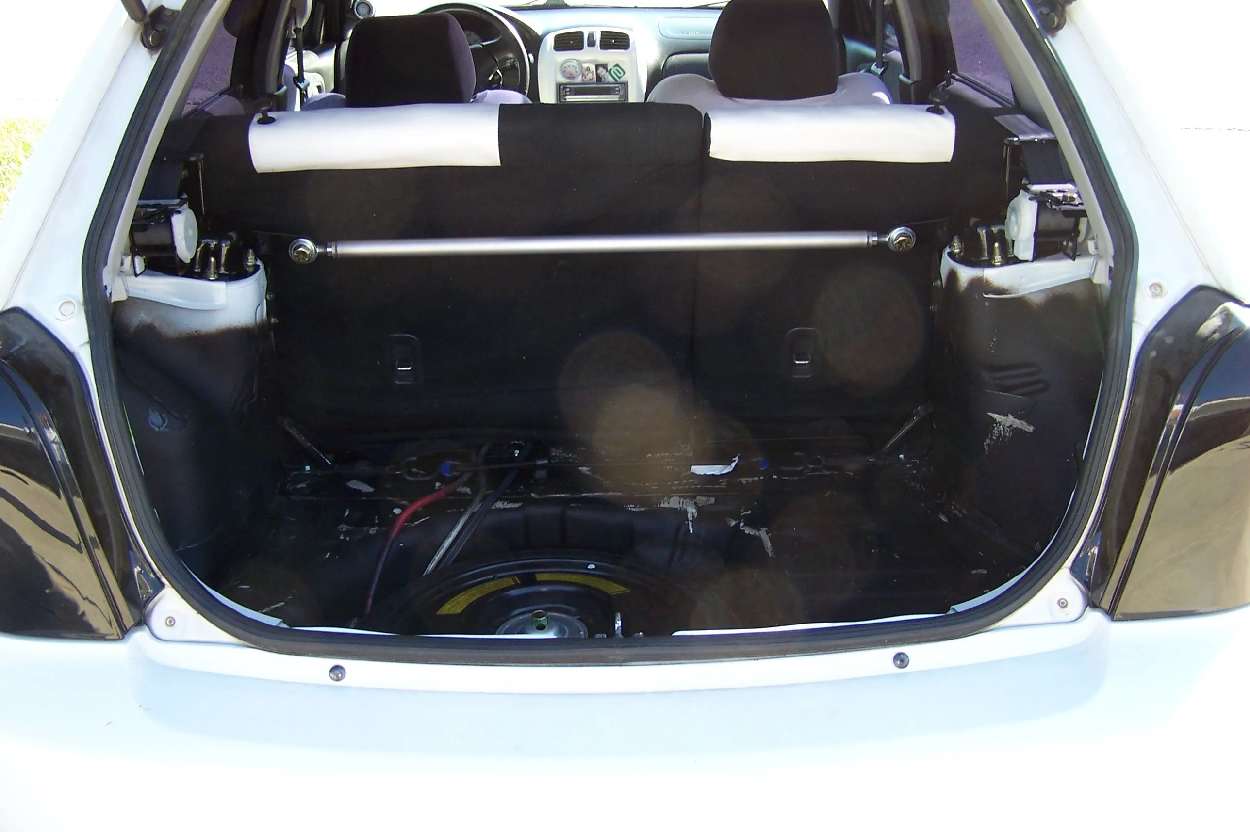

Its Done!
