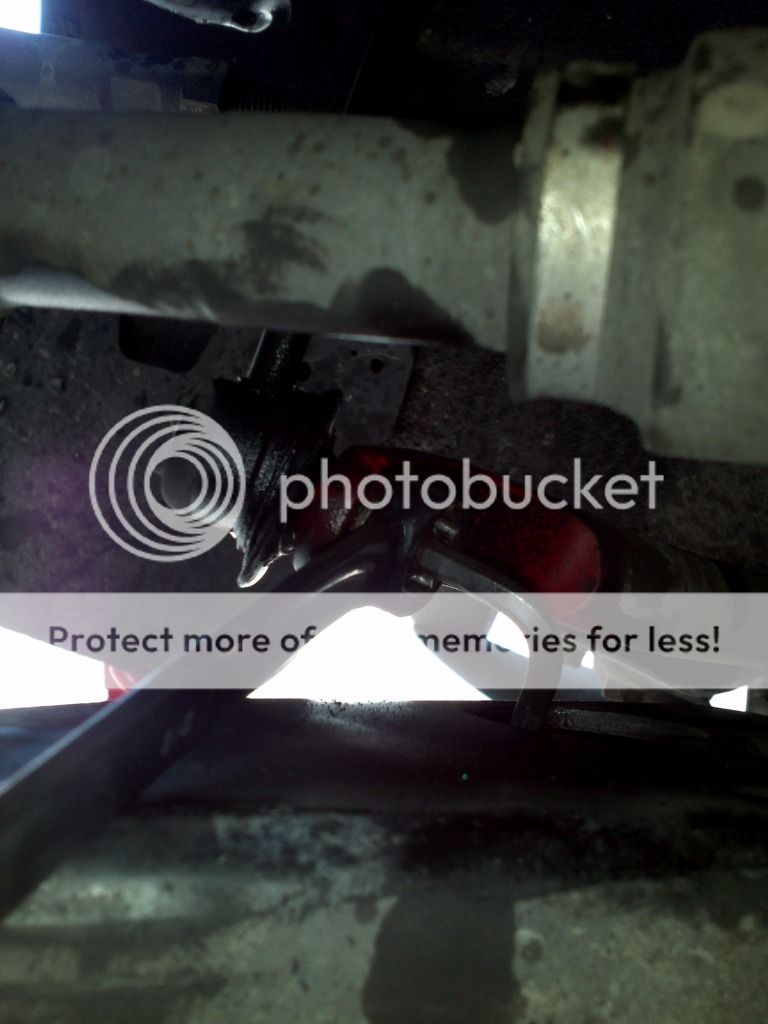

I replaced the rearendlinks after i noticed they were cracked i used the napa 190mm
heres a pic of ny damaged ones

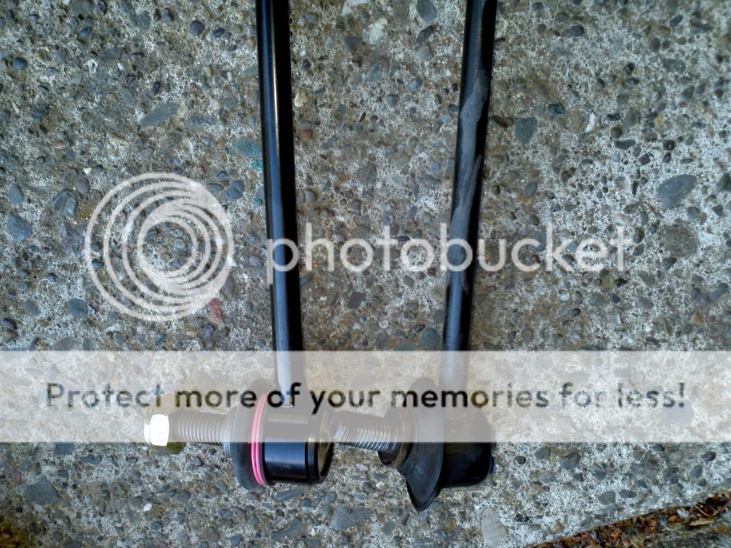

heres the new ones they are a little beefer
they fit with no problem

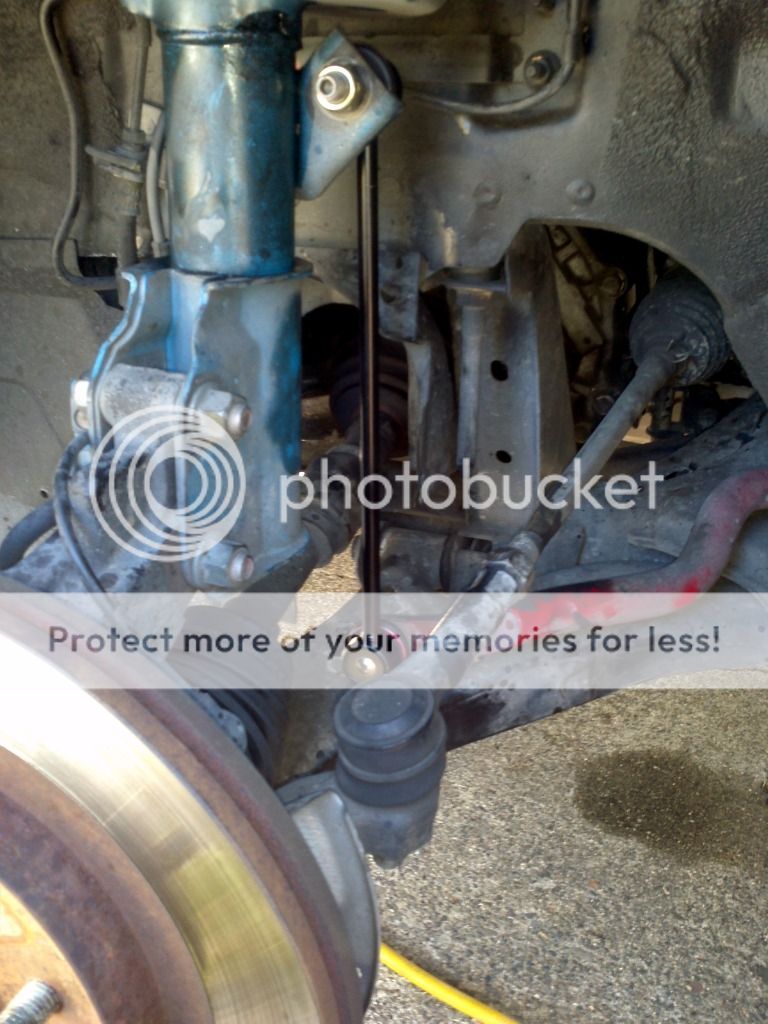

did the fronts today

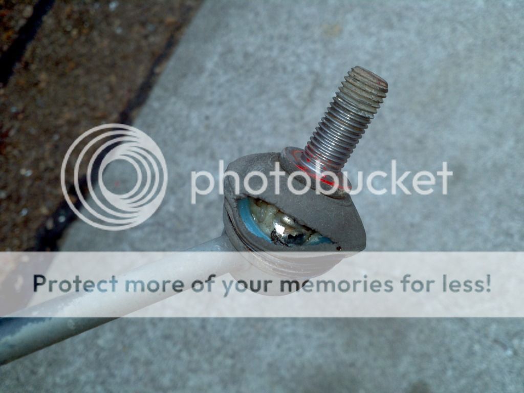

heres the comparison
heres the first one i took out was a small pain bolt was stripped a little bit but hammer and deep socket with impact gun and good to go..
the nut is 14mm and allen head is 5mm sometimes you may need to do this if the nut just rotates
same deal when putting them on except the new nut is 17mm if you have rachet wrenches youll be happy when you encounter this.

heres the finish product
and remember bothe sides must be equally raised so you can manipulate the bar to push the studs through without problem
