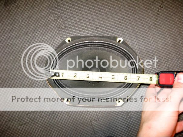

front door speakers are 5x7. you can see the bracket around them is rather large, thus letting you put 6x8's in there.
Be careful with Crutchfield sizing. A couple of months ago they said the "new" Rockford Fosgate Prime 6.5s would fit in my door. When I get around to purchasing they said they will not fit in my car. So go by the sizing we have here on the forum and you will be fine.
is that out of a sedan or a p5? When I did mine I had to use the pioneer speakers that were specific for ford and Mazda. I couldn't fit any larger than 4x6 without cutting.
Check out the 3rd Gen audio page. It has a list of all the sizes that you will need. You don't need speakers specific for Ford and Mazda just the sizes will do. And some drilling that is.
it is out of my p5. just took them out last week. replaced with pioneer 6.5 component set. here is all of my stuff.
