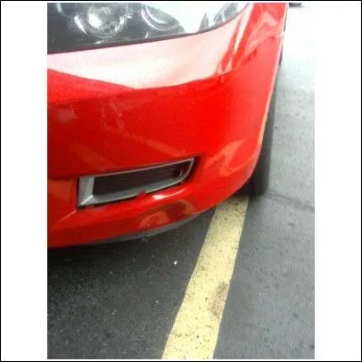

I hit a raccoon on the way home one night on a rural road.
The dealer wanted $550 to fix the dent in my front bumper. My deductible was $500, so I decided to wait and see if it would pop itself back out (sometimes in the heat it can). A few weeks later it started getting cold, so I went out there with a hairdryer, aluminum foil and painters tape. Taped the foil over the dent with painters tape, and held the hairdryer on it for awhile. Reached back under the already pushed in fog light insert and popped it right out.
Took a lot of force on my part and I had to use the hairdryer on it directly to get it to pop out the edges, but now you can't even tell I hit anything. :)
Picture from right after I did it is attached.
