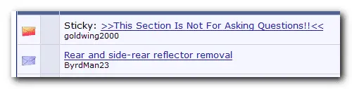

A. This forum is not for asking questions!
That's why the moderators put this message on the top of the screen...

thanks alot hirudin for your help...my apologies for messing up your forums? thanks redspeed!
