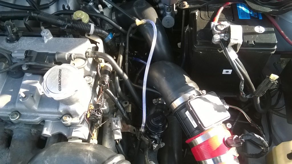

............................ I'm really interested to see how you have this connected.............
And to answer your question, no it's not right... You do not have it installed correctly. I feel like you have your boost gauge > vacuum source > boost controller > vacuum source......

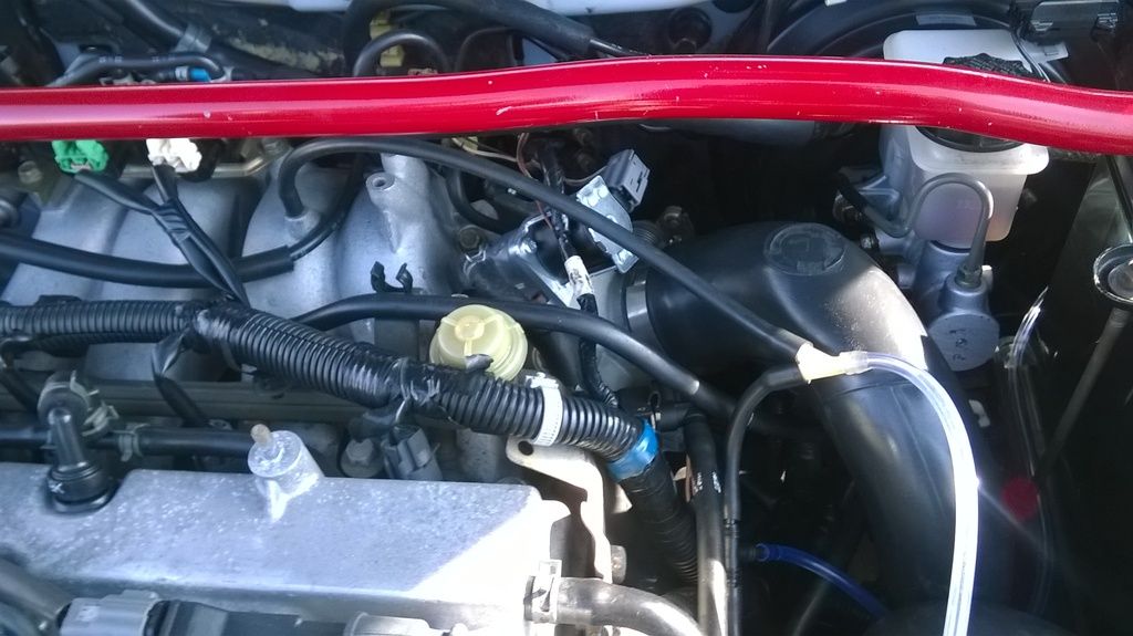

I have it
Wastegate - tube to manual boost controller - tube connected to a Y shaped splitter - one splits into a tube for my boost gauge, the other tube Into my intake manifold.
Which side is your boost controller on???
It's inline in the wrong place. You're cutting the vacuum to your boost gauge is all you're doing...
Messed up. It's like this. Just double checked.
Wastegate/tube/boost controller/ to a T splitter, one hose hose goes to my BPV, the other hose goes to the Y splitter, from the Y one goes to my boost gauge the other to my intake manifold.

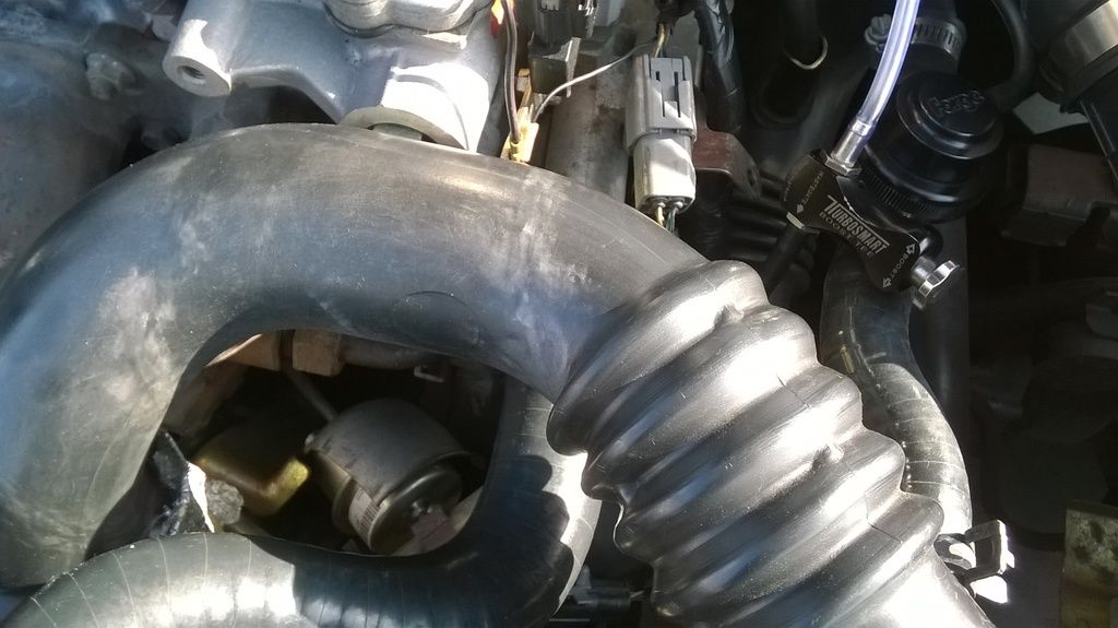

I think you should take that boost controller OUT until you replace a few things... those plastic intercooler pipes for one... I also think you should invest in a vacuum block. that vacuum point is fine but the tube routing is a big of a mess. with a block you can run dedicated lines to everything that needs a vac source.
as long as the boost controller is not behind anything from the wga to the manifold it should work correctly.. not sure whats goin on with your vac gauge unless maybe your wga is bad and leaking. then when you adjust the boost, you adjust how much of a leak you have essentially.

Yeah, bought the car like this a month ago. Maybe it is my wastegate. But when I blow into the tube no air goes through?
And yeah. When I adjust boost up, it gets closer to 0. Weird.
I would tap the compressor housing and run your controller directly from there to the wga. I'd have to check but I think I only used that source for bov and wga.

Can anybody show me a picture of how this should've been set up? I'm still lost.Still a noob to MSPs. I bought a tube to replace and take out the MBC. But I would like to know how it should look like. Haven't found any photos online.
The vac line should run off the port on top of the intake manifold to a T fitting, one of the lines off the T runs to the bypass valve, the other runs to the wastegate. The boost gauge should be T'd off a different vacuum line on the intake manifold, avoid running too many sources off the same vac line. A vacuum block on the brake booster vac line is really the way to go so each source can get the same vac reference.
