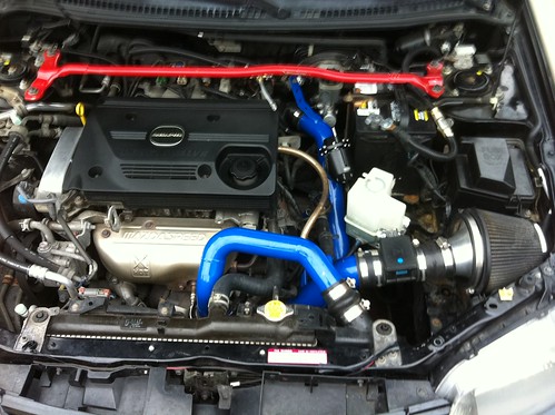

as for relocating,
Untitled by cmezz331, on Flickr
thats what i did... it works, but you gotta move the coolant. all i did was cut 2 inches off the turbo side of the intake, slapped the maf and the filterright on the end.

Im loving that blue that you did, thats what i have in mind for mine, a couple of things are already blue so it should look sick. Is that the Injen there? and you just moved your coolant over a few inches right. Also what do you have for your fans? The previous owner took one out and moved it over to the side so only half of it is in line with the radiator...not the best decision in my opinion.
