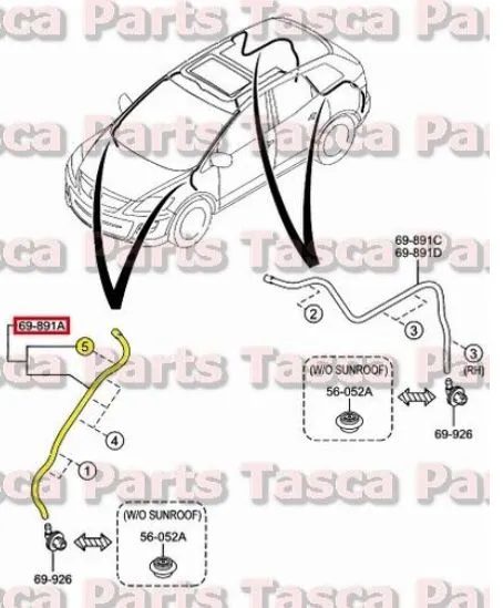

Hi Mark,
do you have a sunroof ? if so, maybe check the drains are not clogged ?
sorry I don't know the exact locations, but I've attached a Mazda picture to show approximate locations
looks like there are four drains ?

I'm going to test by pouring 1/2 cup of water from sunroof and see if it comes down under the CX-9
Does anybody have actual pictures of the sunroof drains or how to unclog them ? thx
